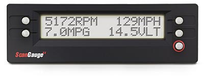

There is a digital based system
http://www.lightner.net/lightner/bruce/Lightner-183.pdf
http://www.circuitcellar.com/AVR2004/wabstracts/A3805abstract.pdf
A nice display, can fit anywhere
http://www.thinkgeek.com/gadgets/electronic/8426/

Is it possible to make something more advanced, without digital data from the vehicle (sensing analog way), can get real-time digital displayed MPG gauge?
