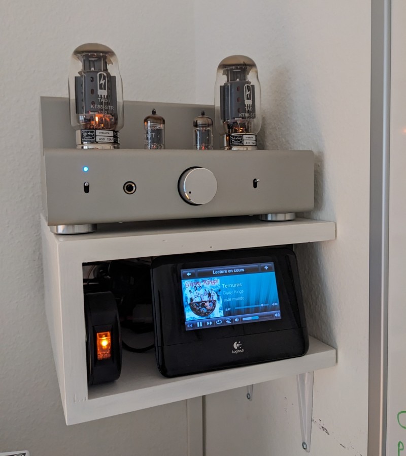

If you go for LMS, Squeezebox Touch are often available for about 100€. Sometimes the power socket is making issues, remove it and solder cables, with an external plug and socket. Extremely reliable and good sound considering their age. I use one in my office, with an Elekit 8200 and Magnat desktop HPs. Plays 30-40 hours per week, when I work.
