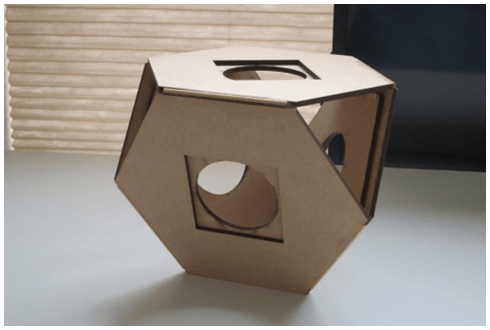

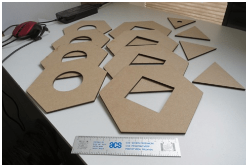

The material used for the boxes is 4 mm MDF. The hexagons and triangles must be precise to size. In the absence of a saw table, I ordered the material from a laser cutting service.
The baffles are held in place with adhesive tape and then folded together. The resulting v-seams are filled with wood glue. Also on the inside, all seams must be glued to get sufficient strength.
When the boxes are glued together, the drivers are placed, the wiring is fitted and the adapter for the stand is mounted. At a later stage, the connections are incorporated into the adapter.

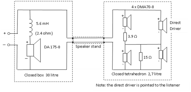

Due to the relatively high crossover frequency of 160 Hz, it is necessary to provide each speaker with its own subwoofer which must be placed under the omni speaker. The subwoofers also serve as a speaker base.
The drivers are as follows connected to the amplifier:
The resistors in the omni’s ensure that the driver which is aimed directly to the listener sounds 3 dB louder than the three other, indirect, drivers. This suggest more space behind the speaker. note: if the speakers are placed far (> 1 m) from the walls, no resistors should be used.
The stands are steel tubes of 12 mm outside diameter. The connecting wires are incorporated into the tube. Omni's, subs and stands are equipped with "tulip" connectors for "quick release" and simple transport.

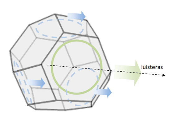

At the following photo you can see that the direct drivers are aimed at the listener, taking care that only the direct drivers can be seen.
In this setup, only one single reflection from an indirect driver remains. To reduce this remaining single reflection, a piece of damping material has been applied against the wall. Because of this, together with the attenuated indirect drivers, it turned out to be acceptable that the speakers are placed relatively close to the wall behind it.

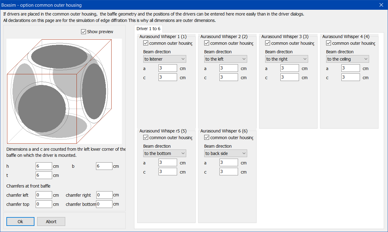

On theoretical grounds there should be a problem with sound power. You want the sound power of a loudspeaker to slope downwards.
I'am not sure what you mean by "to slope downwards" . Did the rest of the description answers your question ?
Thank you for the complement.
No, I did not make reference to the Pluto nor any other Linkwitz design. The statement of Linkwitz concerned omni directional speakers in general. By the way, it’s interesting to watch his presentation: “Linkwitz AES Accurate sound reproduction” https://www.google.com/search?q=Linkwitz+AES+"Accurate+sound+reproduction"&sourceid=chrome&ie=UTF-8 , especially parts 2 and 3 are of interest here.
You are right that 4 drivers just pointing into 3-space does not make an omni, but drivers mounted on the surfaces of platonic bodies, in this case a tetrahedron, radiate almost uniform in al directions and make a good approximation of a true omni directional speaker.

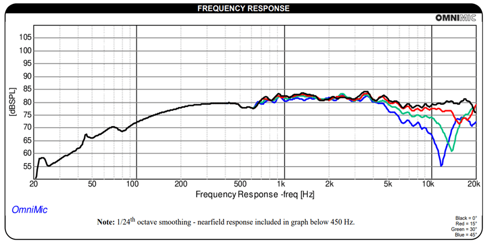

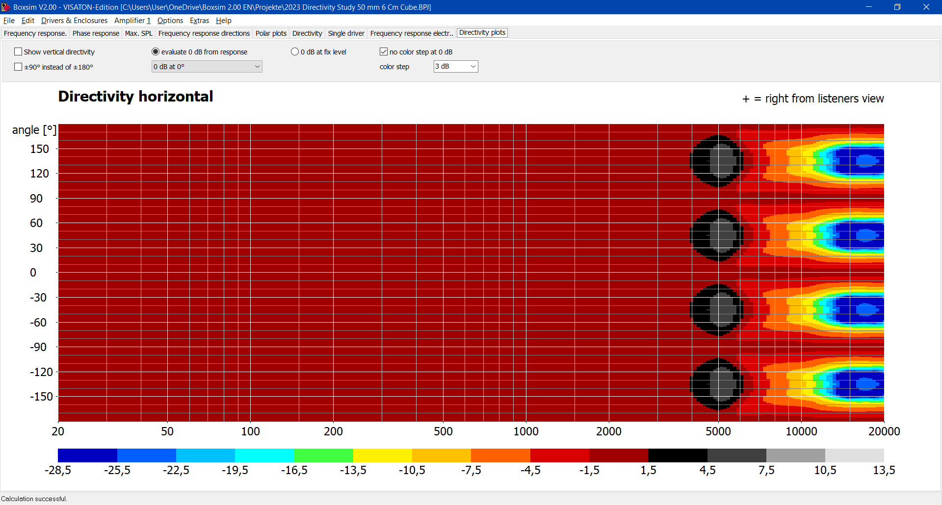

Sorry, It took me some time to think about your question.
Below you see the graph of the full range driver used:
As you can see a problem occurs at higher frequencies (above 5 k Hz). Due to bundling the spl at the off-axis directions of the drivers decreases, and with that the total sound power. This causes the sound power to slope downwards.
The problem off course is absence of a decent tweeter. A think this needs correction in the next model.

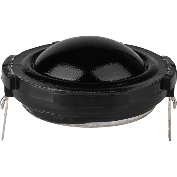

Have you looked at these? If you aren't trying to go too low, they are pretty good. Not cheap when you need 6 of them though.I tested several of the small Dayton tweeters but found the distortion was a bit high. The search continues.
Peerless by Tymphany OX20SC00-04 3/4" Fabric Dome Tweeter
https://www.parts-express.com/Peerless-OX20SC00-04-3-4-Fabric-Dome-Tweeter-264-1002?quantity=1
mattstat: That is a great looking tweeter for sure and the price is actually great. I may have to buy and test one or two.
I'm looking to use the tweeters 4 kHz and up.

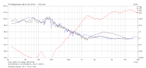

I tested the 1" Peerless Tweeter, which doesn't have the rear chamber, and the results were not great. The SPL level on
the graph is not calibrated and the mic was close to the tweeter, 6 inches or so. I was driving maybe half a Watt at the
time so it was playing maybe 85 dB. (I need to calibrate the level some time). It would be great to have < 0.3 % distortion
at normal to slightly strong listening levels.
It had good 2nd and 4th harmonic distortion, but high 3rd harmonic distortion. This might be OK for the rear firing tweeter.

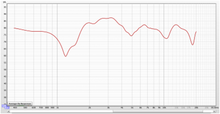

The following picture shows the resulting measured SPL on the listening axis:
The response is not very flat (a clear understatement) and I think is bad for stereo imaging.
What can be done to correct this ?
Looking at the geometry of the octahedron, you can see that the plane in which the three indirect drivers lie is also perpendicular on the listening axis to the sweet spot. However, this plane is about 12 cm behind the acoustic center of the direct driver.
The solution could be to delay the signal of the direct driver by about 12 cm (a few hundred usec).
On forehand it is clear that an active system (with a dsp) is required for the delay.
This will have a lot of construction consequences, but also gives new opportunities to optimize the omni directional speaker system. Therefore, I want to address these issues later.

Yes, I think this is the big insight that eventually will sink in and take the lead. It also jives with normal living rooms which is a nice thing.This again strongly suggests that for good sound reproduction, all room
reflections must contribute.
This is also my experiance. EQ, digital, is probably the best bet - but all system will have eventually so no problems.The response is not very flat (a clear understatement) and I think is bad for stereo imaging.
I think you should try to let the direct signal hit the listener 1ms before the diffuse field does - try it!?The solution could be to delay the signal of the direct driver by about 12 cm (a few hundred usec).
Best of luck - you are on the right track as I see it.
