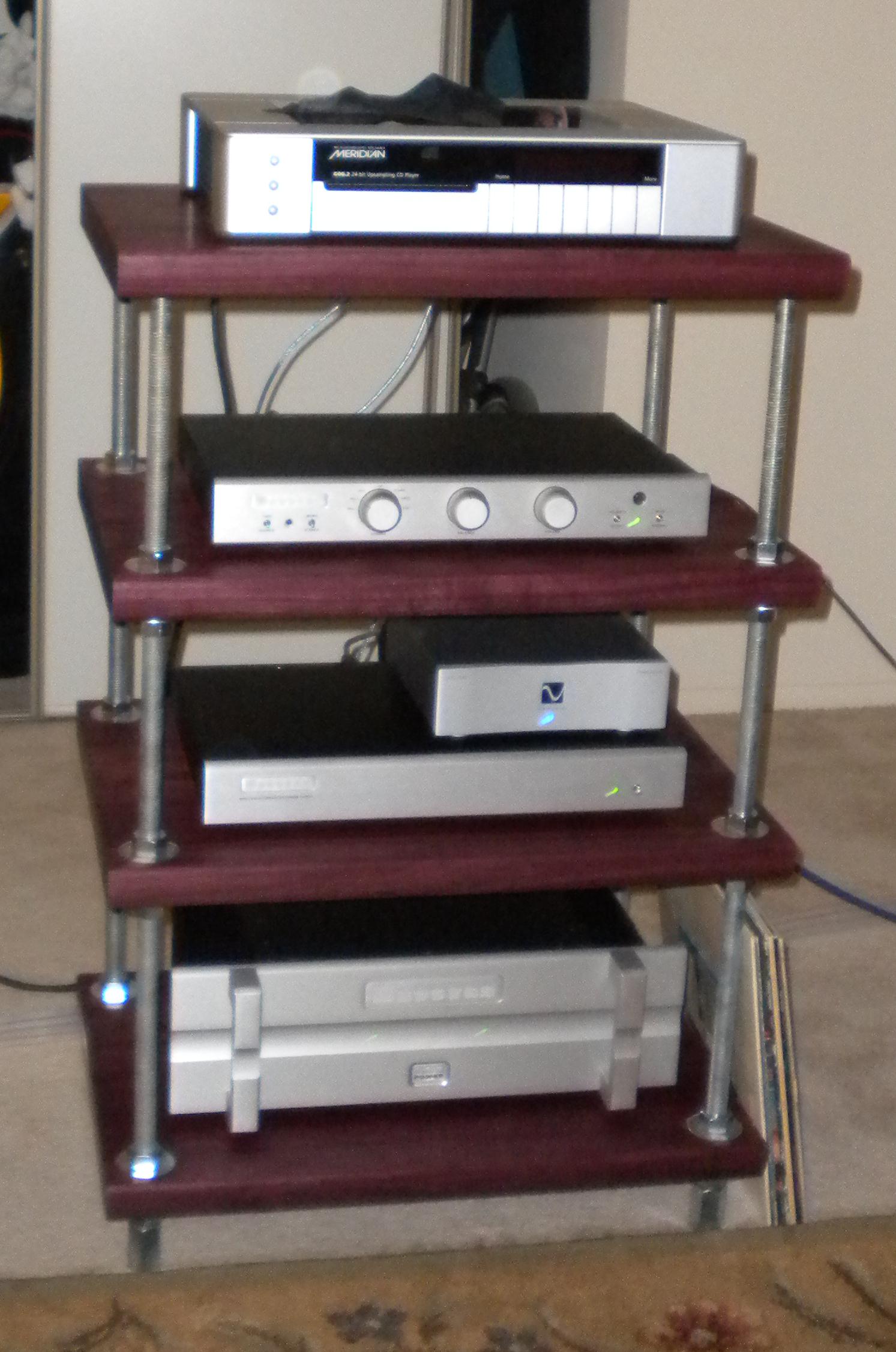

Just finished this rack - ala Salamander. The shelves are 3/4" mdf laminated to 1 1/2" with purpleheart veneer(www.oakwoodveneer.com). Purpleheart wood turns purple naturally when cut- no stain necessary. The 3'x 3/4" threaded rods , nuts and washers and couplings and mdf board are from Home Depot. The couplings at the bottom are for level adjustment.
This rack came out extremely stable (86 lbs.)
Regards, tom

Late chiming in here (I'm getting ideas for a new rack of my own now).:2c:
BUT< I wanted to point out that the Purple Heart must be sealed with a UV stable clear coat or the beautiful purple color will fade to brown.
I have done a lot of work with PH (great stuff b the way) in my guitar making and it can be quite vibrant freshly cut but does oxidize.
Hope it is still looking as good as it did new!
