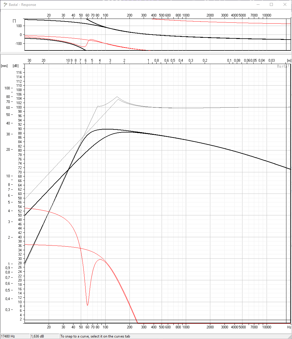

I am wanting to design and build my own rear and height channels for my small 5.1.2 home theater, but I am no expert in speaker design, so I’m looking to get some feedback before going straight to building.
About the current build plans:
I am using the 4” SB Acoustics SB12PFCR25-4 bass mid-woofer and the 3/4” SB Acoustics SB19ST-C000-4 dome tweeter. The drivers are mounted in a 4.8-liter ported box, tuned to 60 Hz. The expected transfer function can be seen in the pictures below, along with the 3D models.
Other than knowing that boundary gain is a thing, I don’t know how to predict or simulate it, so I don’t know how to account for it when designing the speaker. Will I get an excess amount of bass with my current design if I mount the speaker on a wall (and close to the ceiling in the case of the height channel)?
I have also read that boundary interference is a thing of concern with wall-mounted speakers. My understanding is that it’s simply one of the downsides of having a wall-mounted speaker, but is there anything you can do to mitigate the effects of it during the design process?
I am also a little unsure about the port position on the side of the speaker. It is a little unusual, but I don’t see why it should be a problem.
Other than that, if any of you have any thoughts or comments about the design, then please let me know. 🙂

Yes, but that's not a disadvantage, as it improves available amplifier headroom by the same amount.Will I get an excess amount of bass with my current design if I mount the speaker on a wall (and close to the ceiling in the case of the height channel)?
Do you mean that I could EQ the bass down on my AVR and gain the extra headroom by doing so?Yes, but that's not a disadvantage, as it improves available amplifier headroom by the same amount.

Yes, absolutely, the apparent increase in efficiency reduces the excursion requirements on the driver (at these boosted frequencies) thereby reducing distortion and amplifier power, but this requires downward EQ as you've correctly guessed.Do you mean that I could EQ the bass down on my AVR and gain the extra headroom by doing so?
It's not a good idea to use BR on the rear speakers if they are that close to the wall and ceiling or even the corner. It will sound boomy and very squishy. A sealed enclosure is the best you can do in such a situation.

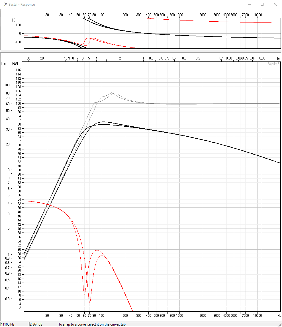

I get your point. I can't get a smooth system response with a tuning any higher than 70 Hz. The picture below shows the driver in a smaller 3.8 liter box tuned to 70 Hz. I don't seem to gain much from doing so. It saves a little bit of driver excursion before the tuning frequency but increases after it.Because that's what subs are for. Reducing cone displacement where possible is ALWAYS a Good Thing.

Also all of the 3 design suggestions Basta provides suggests tuning frequencies below 60 Hz with ever larger box volumes. I don't know how valid the suggestions are though.
I hear many people use the word "boomy" bass. What exactly does this mean? Is it just a word for too much bass? If so, wouldn't it be more beneficial to make use of the bass extension that a bass reflex provides, now that space isn't a limiting factor, and just EQ the bass down and gain some extra headroom as @newvirus2008 pointed out?It's not a good idea to use BR on the rear speakers if they are that close to the wall and ceiling or even the corner. It will sound boomy and very squishy. A sealed enclosure is the best you can do in such a situation.
No, that's bloated, imprecise, soft bass. It's usually too loud too but that's not the main problem.
If so, doesn't it make sense to make use of the bass extension that a bass reflex provides, now that space isn't a limiting factor, and just EQ the bass down and gain some extra headroom as @newvirus2008 pointed out?
No, because it excites the room modes most at that placement. There should not be any bass played at the rear speakers, therefore you don't need headroom in that range. And without a port no mid-garbage can come out through it. That's important because there's likely nothing at the walls that can absorb it.
All speakers receive a full range signal so they play bass too.No, that's bloated, imprecise, soft bass. It's usually too loud too but that's not the main problem.
