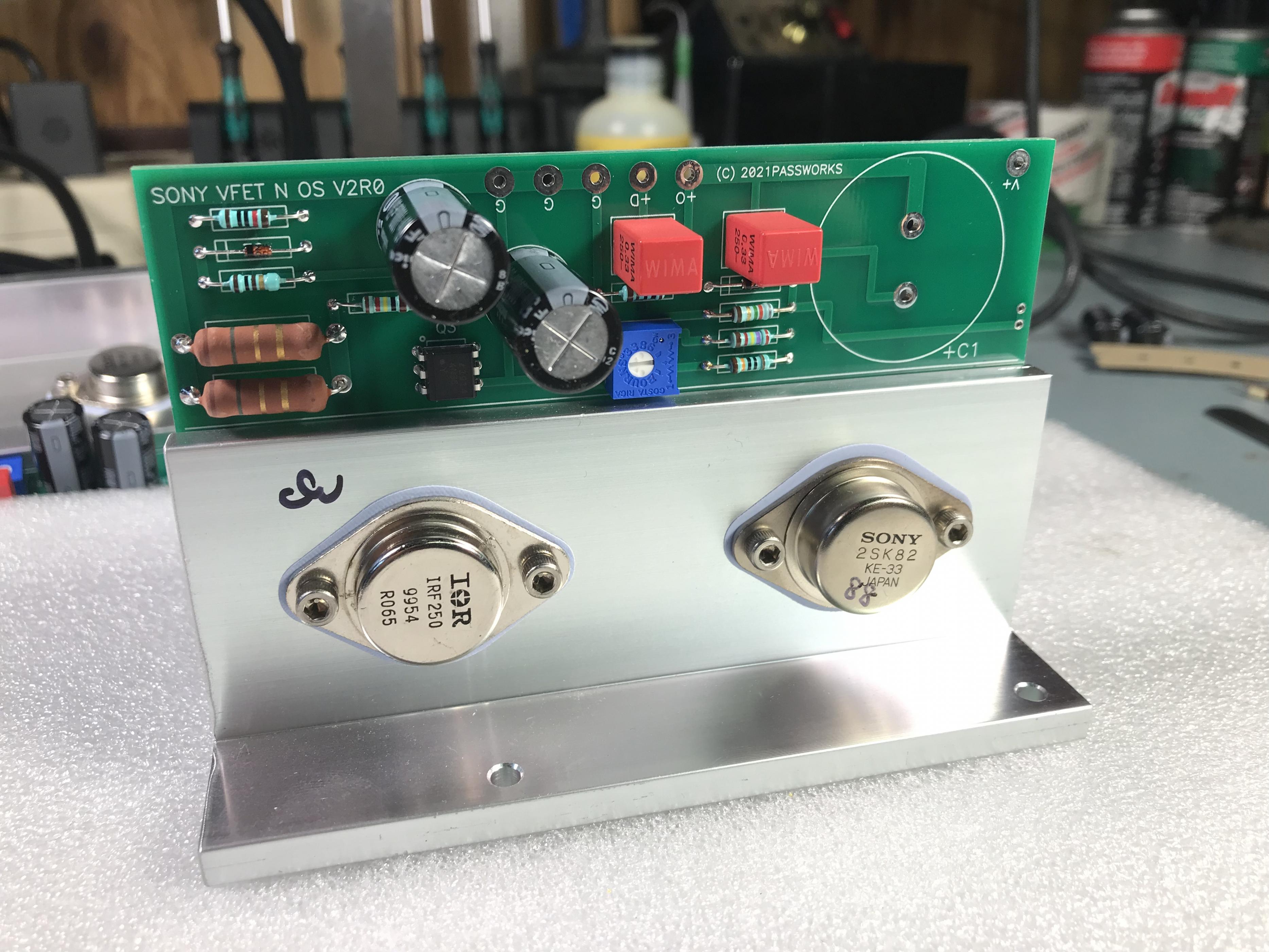

Most of the general assembly of the VFET pt 1 will carry over well to pt 2. In particular, pay attention to the location of the OS brackets – they are best positioned toward the front (thick plate) of the amp, in order to leave sufficient room for the various FE boards.

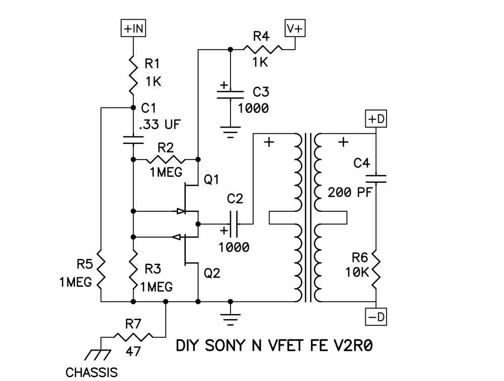

Nelson's document is a good guide for populating the boards with their components. The overall wiring diagram in that document should be followed closely as well. What remains tbd is the location of the new PS filter board and the wire lengths. These you may solve as a community of enthusiastic (even fearless) amp builders. 😉

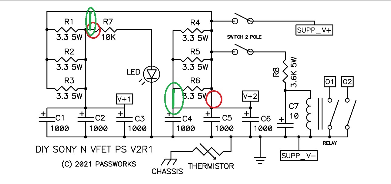

also it looks like there still may be a thing or two that will need to be changed...
Ben posted this: https://www.diyaudio.com/forums/att...2606d1628286248-diy-sony-vfet-pt-1-a-2-ps-jpg
Only in the schematic of the psu if I think. The board is ok.

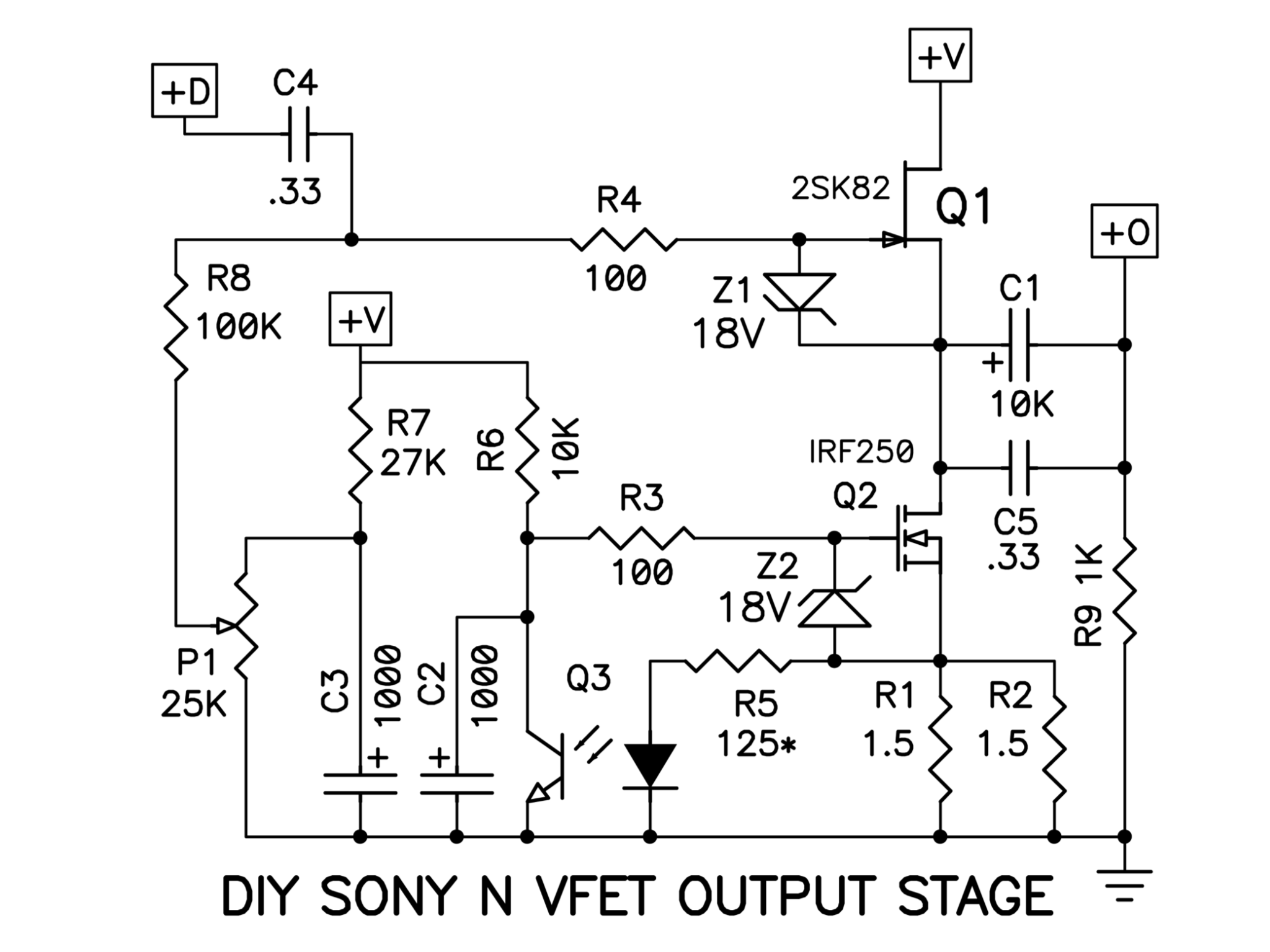

On another note, I have some 82ohms instead of 100ohms included in the kit for R4 of the OS board. They are only gate stopper to prevent oscillation if I understand correctly so they should be ok but I would like to confirm with someone more knowledgeable than me before soldering them in.

you;re good with anything between 47 and 220R
Great thank you ZM!

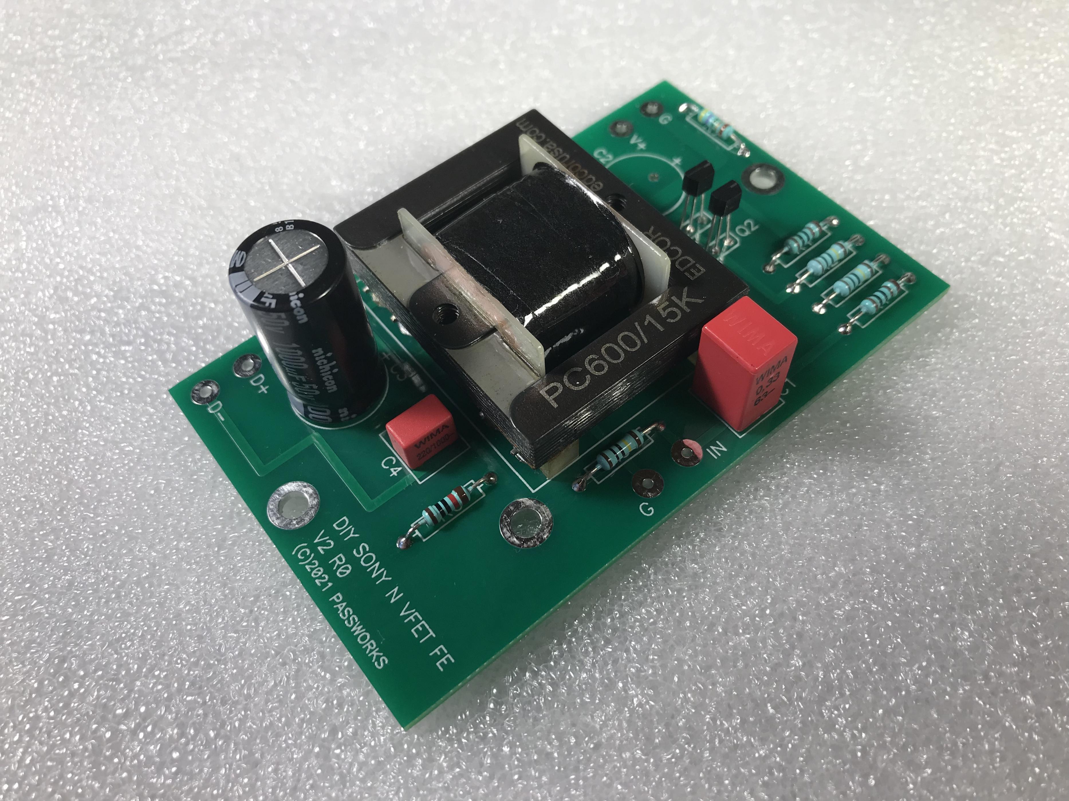

The boards are looking great! Everything is already stuffed appart from the big caps on the output which will be upgraded with some Nichicon KG, and C2 on the front end which will be replace with some Nichicon KZ. And I have to say that I really like the nice finishing touch from the master 😀

Very nice! I wish I could say I'm not jelous, but I'd be a LAD if I denied it. 😀
