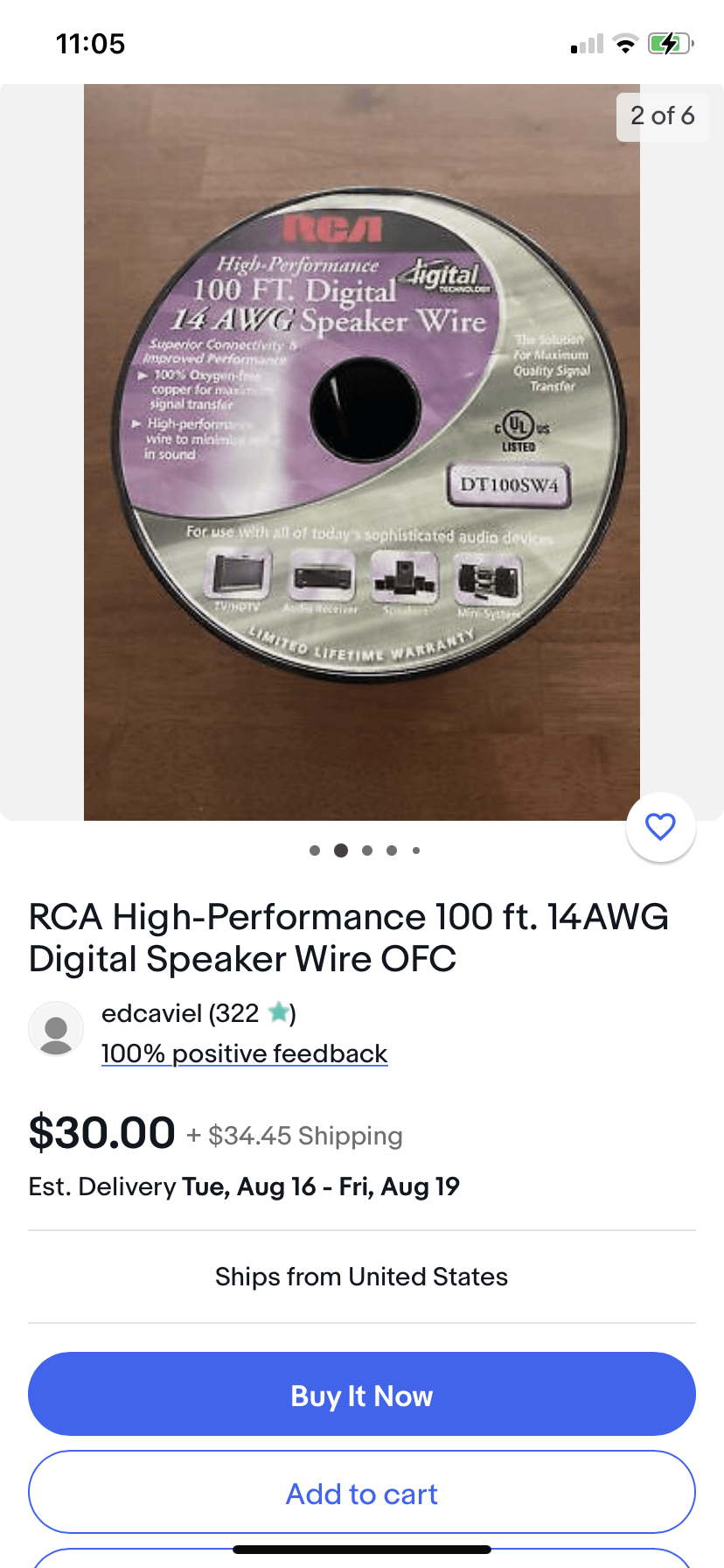

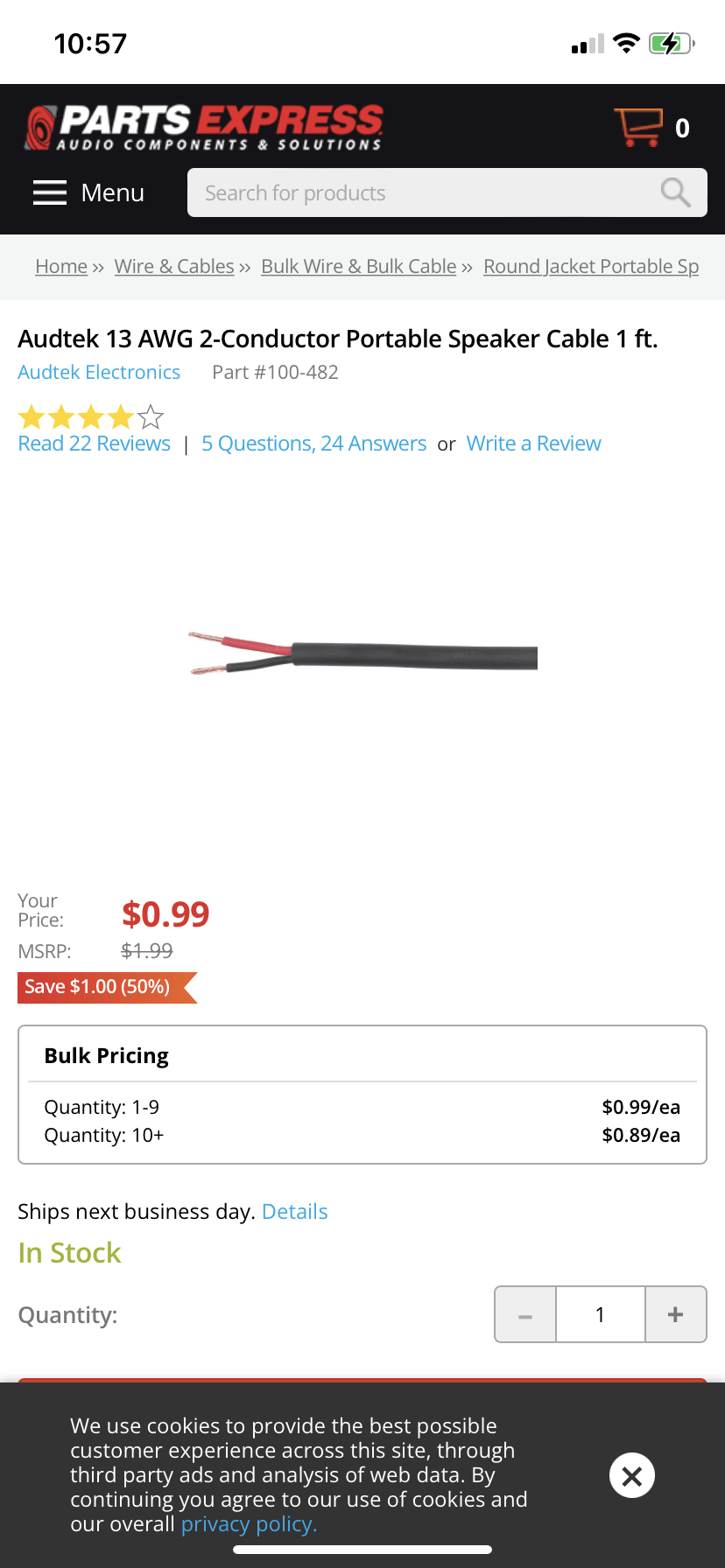

Look at Amazon Basics 14ga speaker wire. It’s jacketed so it will take more abuse and it’s cheap. $38 for 100 feet! Don’t waste money on fancy cable it will make no difference in your situation. Get quality 1/4” plugs that can take some abuse, stick to Nuetrik or Switchcraft. Make sure to use the strain relief within the connector to hold the wires. Most fail because they are yanked on and the strain relief helps keep them together. If you use the jacketed wire make sure the jacket is held by the strain relief not just the wires.
The best cables I have used to date that made a huge difference is the RCA speaker cables At 14 gauge for a P.A. System at work. Here a picture and link for you. It’s to long of a story but, The best bulk cable for P.A. Speakers in wire by the foot was the this cable at parts express. Here’s a picture and link for you. Decent cabling and rugged to. Plus it’s OFC Oxygen free copper. Good luck. Jeff
https://www.google.com/url?sa=t&rct...org/wiki/RCA&usg=AOvVaw3yQ9CJhVqXl-NBk0ipMlGY
RCA defunct in 1987, many people are using the trade mark in different categories.
The wire is 30 USD, + $34.45 shipping, so 64.45 USD landed at your door in the USA.
Looks very similar to the Amazon cable. Red and black wires in a poly jacket making a round cable.
Personally. I would prefer a standard name rather than a brand which is defunct, so the quality is anybody's guess.
Buy double insulated (jacketed) wire from electrical parts sellers, see if you get in military surplus places.

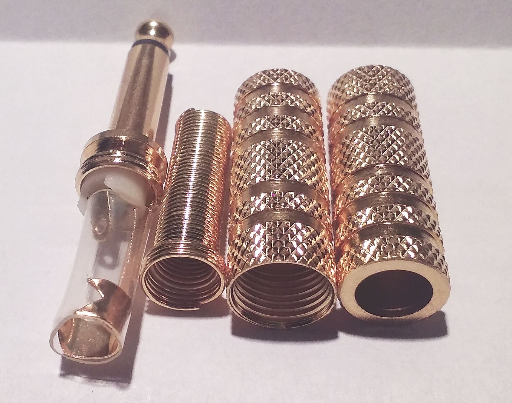

Same feeling here 😉 but IF both amp and cabinet have 1/4" jacks installed ... what else can you use?I would NOT TOUCH ¼-phone plugs for speakers, now that Neutrik speakONs have become widely accepted.
New builds are fine, but on existing equipment, telephone patchcord plugs and jacks have been the standard for almost 100 years now.
^^^^^that.While Speakons are great and reliable, the Passport system does not have them. He needs 1/4 to 1/4 cables.
Don´t know what Country are you in (it´s always important to state that) but if a Metric one (easy, anywhere outside USA) , standard speaker cable for PA/MI use is 2 wire round sleeve "appliance" wire (power drills, vacuum cleaners, etc.)
Size is by square mm.
In general maximum you can fit through plug cover caps is 2 x 1 mm^2 , equivalent to about 18AWG; so 16AWG and even 18AWG are hard to impossible to use.
Premade commercial speaker cables beat that by using custom molded oversized plugs, nt much of an option for a home builder.
Although if you search around you may find spare oversized plugs.
Neutrik and Switchcraft both make 1/4” plugs that will take 20mm diameter cable and are designed for “speaker cables”. Saw them at PE when looking for plugs big enough for two mic cables, so its not just something custom only an OEM can get. Wish they would make a TRS version.
12/3 would be tight (its tight for 2 pole speakons), but 14/2 SJ or SJOW no problem.
FWIW I use "regular" plugs but drill end hole up to internal cover diameter, guaranteeing maximum possible wire diameter.
Standard guitar plugs get up to 2 x 1 square mm round power cable, when drilled up they take up to 2 x 1.5 square mm type.
Original size:7.9mm diameter, internal barrel size 10.2 mm, a significant difference when you are trying to squeeze cable there; I use a 10mm or 10.25mm drill, just enough to drill narrow rim out.
Remember to deburr it, use some fine emery paper or cloth, and of course you lose the cheesy "spring relief" ... no big deal.
You may add your own by heat-shrinking around barrel end and inserted cable, it helps some.
After final assembly of course.
Useful diameter increase is substantial and justifies extra job.
Of course, If you can order oversized plugs, by all means use them.
Here I try to work with what´s easily available over the counter, so all standard stuff is cheap and plentiful; anything else a PITA.
