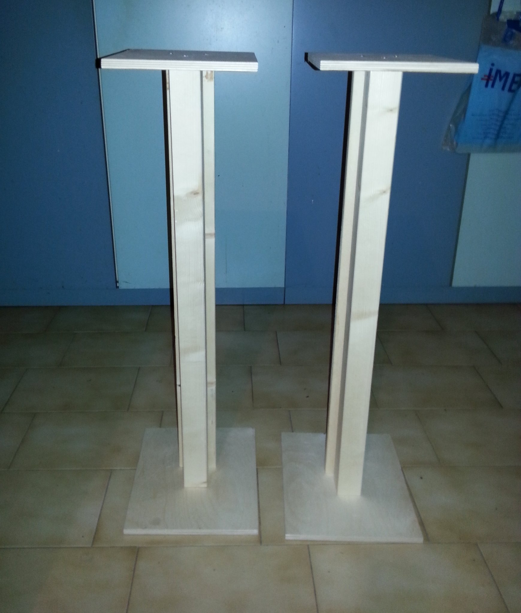

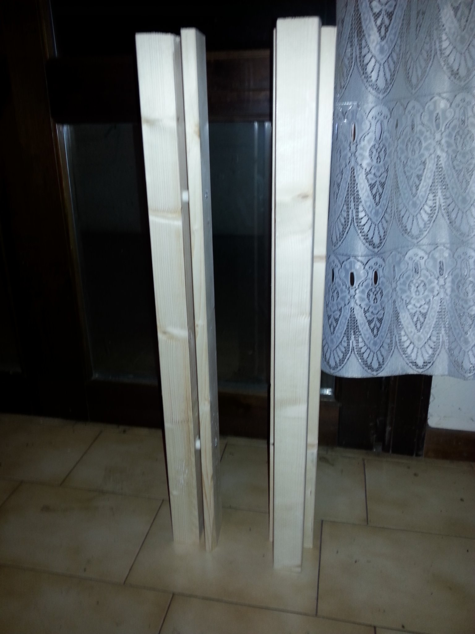

Hi all and happy Christmas,
I've just finished two 80 cm tall speaker stands made from fir wood, regarding the vertical supports, and multilayer plywood for the bases. I wondered wich kind of dye/varnish were suitable for both materials. Asking to a friend who is carpenter he told me that I should use two different kinds of treatment: mordant or water-based color followed by gloss or semi-gloss transparent varnish for the fir, and a white primer and specific coloured paint for plywood. My idea is to have a walnut color, a little glossy, for the vertical elements and a glossy/matte black color for the basis. Anyone experienced with that? Thanks in advance

Yes, I forgot to say that I make some trial on a piece with two differents paints, one is acrylic paint from a fine arts shop, also used for wood according to the seller. The other is a "wax effect" mordant light walnut colored. The results are differents but in both, the grain of the wood is shown. I'm a little doubtful on which is my choice. If I can use just only one technique it would be better, but I have two differents woods: plywood and fir. I only uesd screws and spacers, as soon as possible if you like I attach a photo.

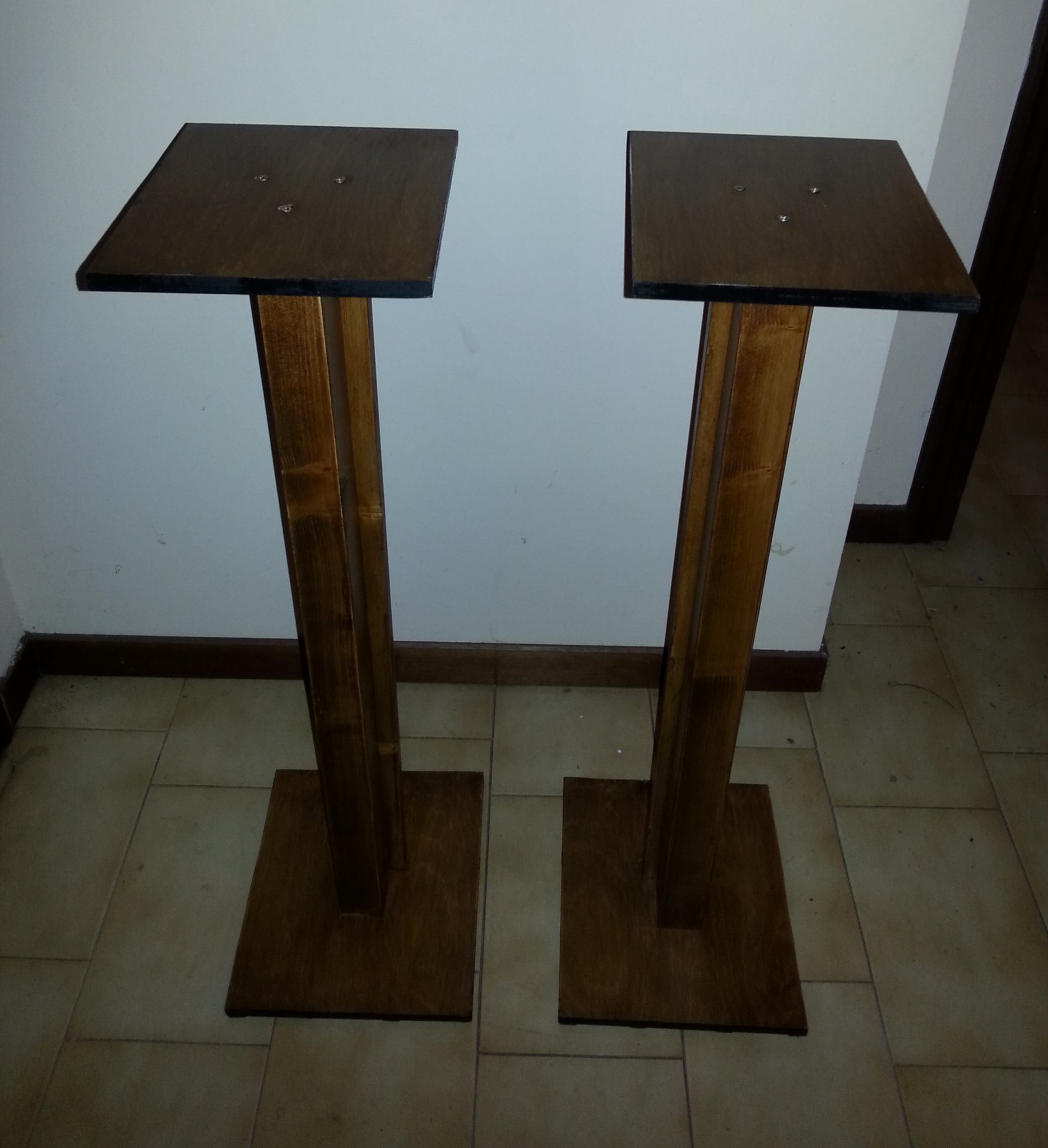

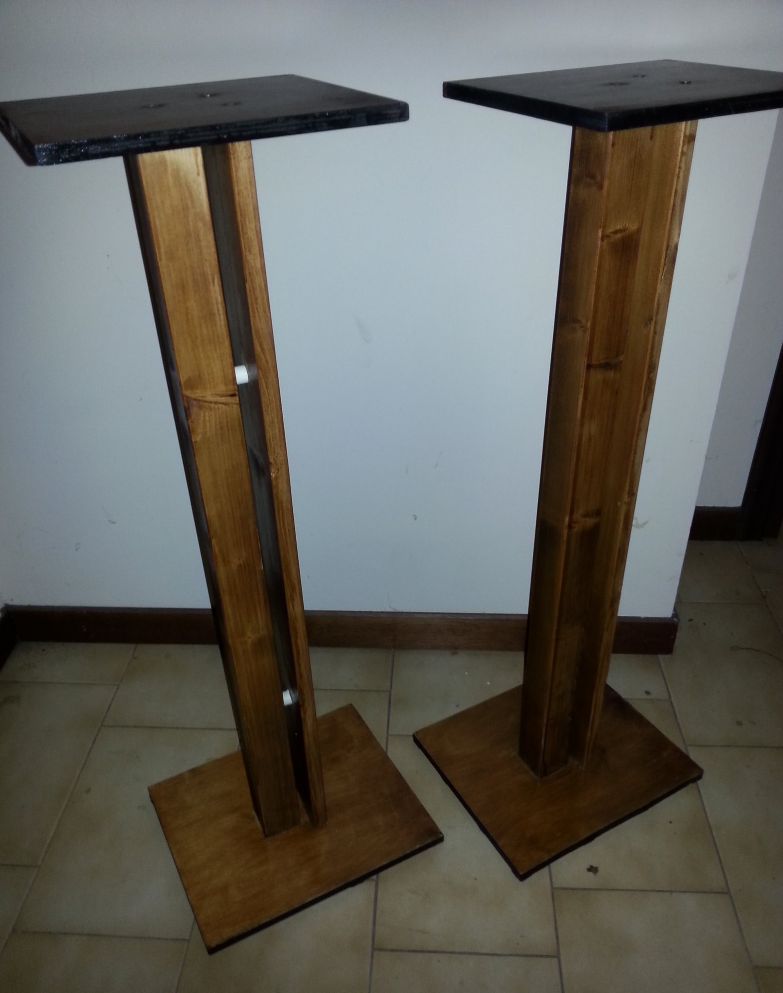

Finished the speakers stands some days ago...The painting involved several operations, I hope correct overall (I partially followed the instructions by my friend carpenter), but I am quite satisfied with the result.
First, I sanded the raw wood with 180 sandpaper, being the fir rather tender. I applied a coat of synthetic impregnating agent on the columns while I treated the basis (as they're multilayer plywood) with a coat of nitro filler, not diluited.
After, I sanded again all with 220 s.p. and applied everywhere a second coat of the agent. The varnish is clear walnut.
The time to dry the handwork was a little long, then used 280 sandpaper and repeated with the third and last coat of agent.
For the finishing I wanted to use shellac, which I prepared by myself (40g shellac flakes dissolved in 200ml EtOH 99%). Before applying the solution I sanded with 320 then used shellac pad. After half a day I repeated the process twice, last time with the solution diluited in EtOH 2:1.
I forgot, I painted the edges of both bases for each stand with High Heat Spray Paint (the one that is also good for ovens), at the suggestion of my friend. Then I finally coated them with transparent finishing varnish "sopraffina" (monocomponent alkyd enamel).
