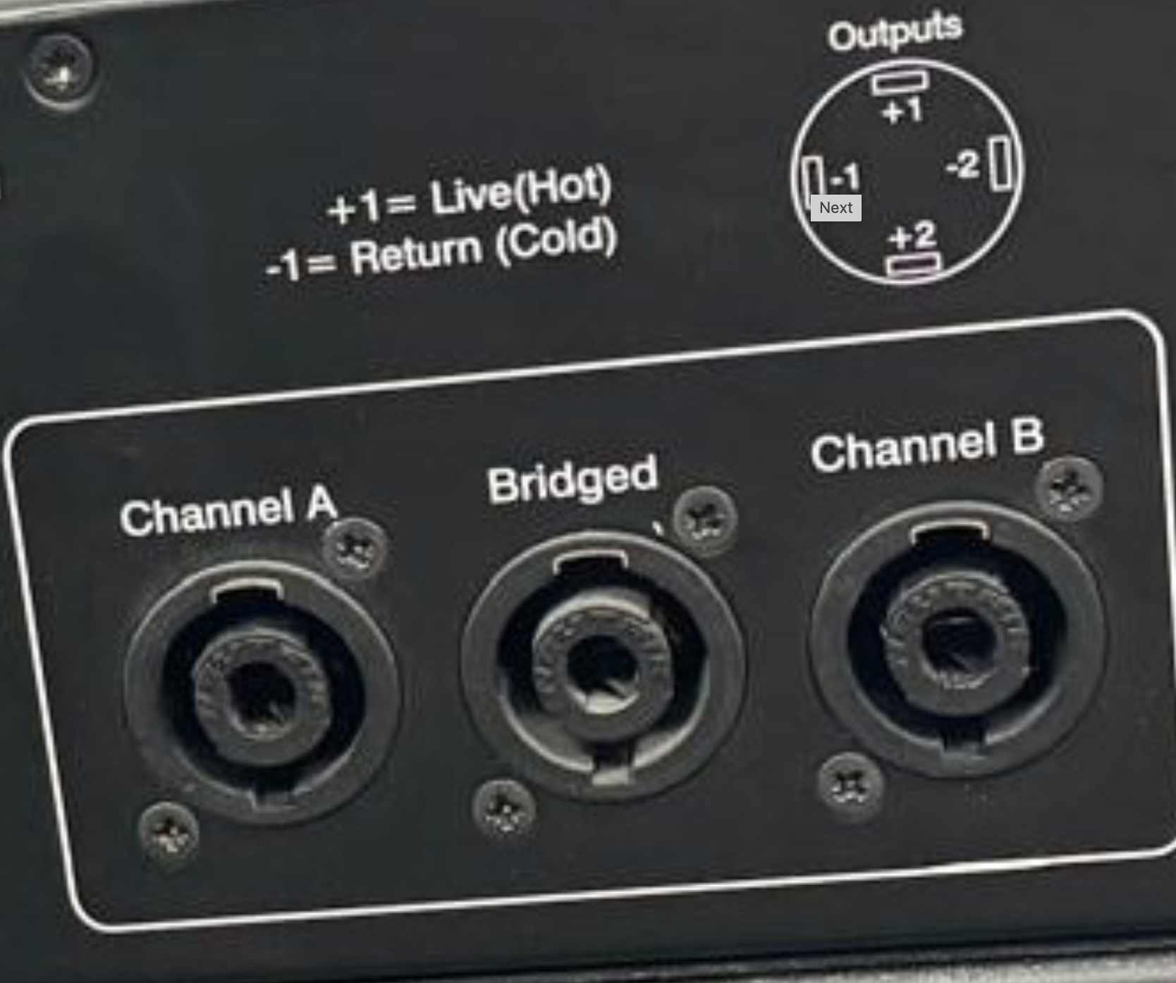

There are 2 and 4 pole Speakon connectors (even 8).
I will use this cable for my home audio. No bi-amping or bi-wiring. I read that 4 pole is for bi-amping. Does it also mean for bi-wiring?
Would not be future proof to get the 4 pole if in the future I want to bi-wire (not-bi amp) if I get bi-wireable speakers?
Will be using a pro amplifier hence the desire to build a speakon cable.

Funny that you mention it, as I was considering the same thing yesterday. I believe that it would be more than reasonable to get a 4 pole so yes, that it can be used either way at the other end. This means, how you wire it will determine the use for it. Bi-wiring or bi-amping are possible using this 4 pole option.
Obviously, I would need two pairs of cable for one channel/speaker, so doubtful I'd go that route but why not get the 4 pole.
Any specific brand you will get? I guess I'd go Neutrik?
I have used Speakon connectors at my speakers for decades. I make my own cables, but some cable companies have Speakons as an option.
Use the 4-pole and, yes, buy the real deal, Neutrik.

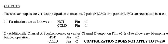

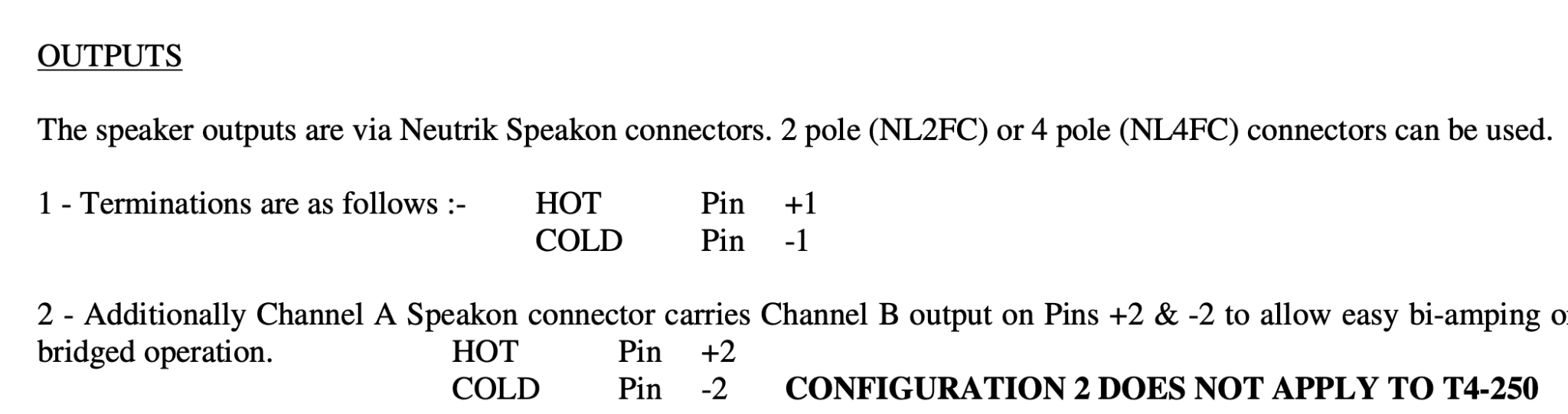

This is what it says.I would get 4 pole and if your amp has speakon outputs just check on the manual which set of pins it uses. Yea go Neutrik, plugs are cheap, its cable that you need a morgage for haha

Go for Neutrik and 4pole ( iirc they are cross compatible with 2poles one anyway - depend how you wire them). If you can source it use Mogami loudspeaker cable with it (w3104) in quad configuration and be happy forever ( i've been for more than 10 years). Could be used for biwiring as such too but like russc said it's a waste of money ( and did not stand comparison with quad config on the loudspeaker i tried: quad give feeling to have gained an octave both ends of spectrum! Still i ended with multiamp setup and dsp and cable/speakon allowed it anyway). And if you like big, it's good to have garden hoze size kind of cable. 😂

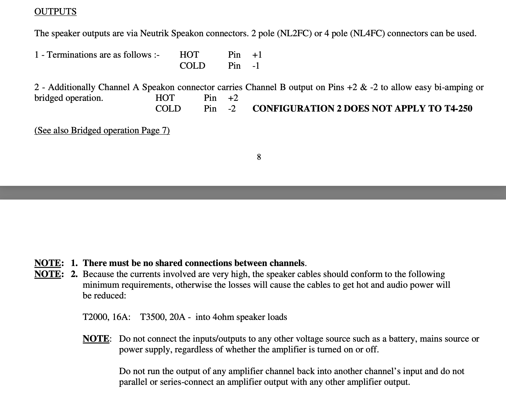

So, I asked this question to Neutrik but did not really get an answer other than use one wire per terminal.

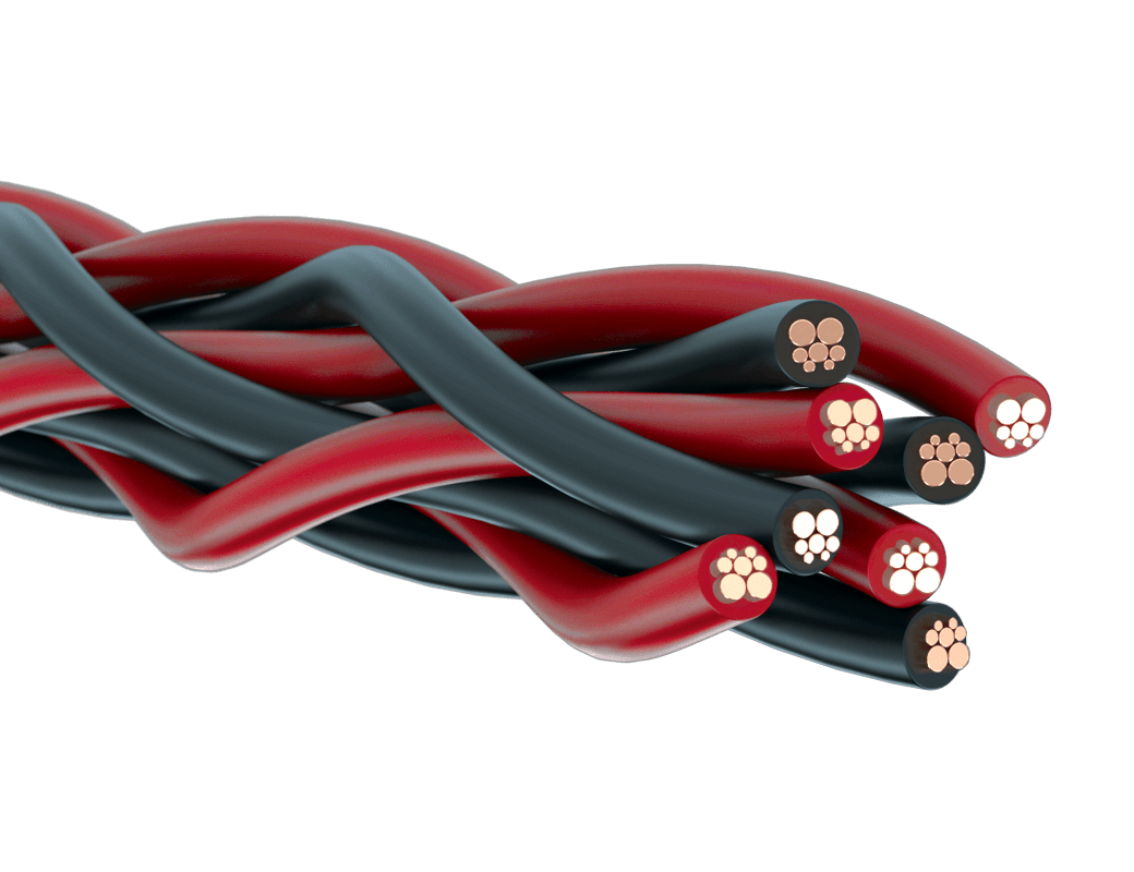

My question was using this Kimber cable connecting to 4-pole Speakon connector; two red wires to +1 terminal, the other two reds to +2, two blacks to -1, two blacks -2.
The speaker end which my speakers are not bi-wireable; connect four red wires to red, four black wires to black.
Something like this:
Two red +1
Two red +2
Two black -1
Two black -2
Four red to red binding post
Four black to black binding post
Would this be a correct way of connecting? I think yes but not 100% sure because I have no experience with Speakon.
