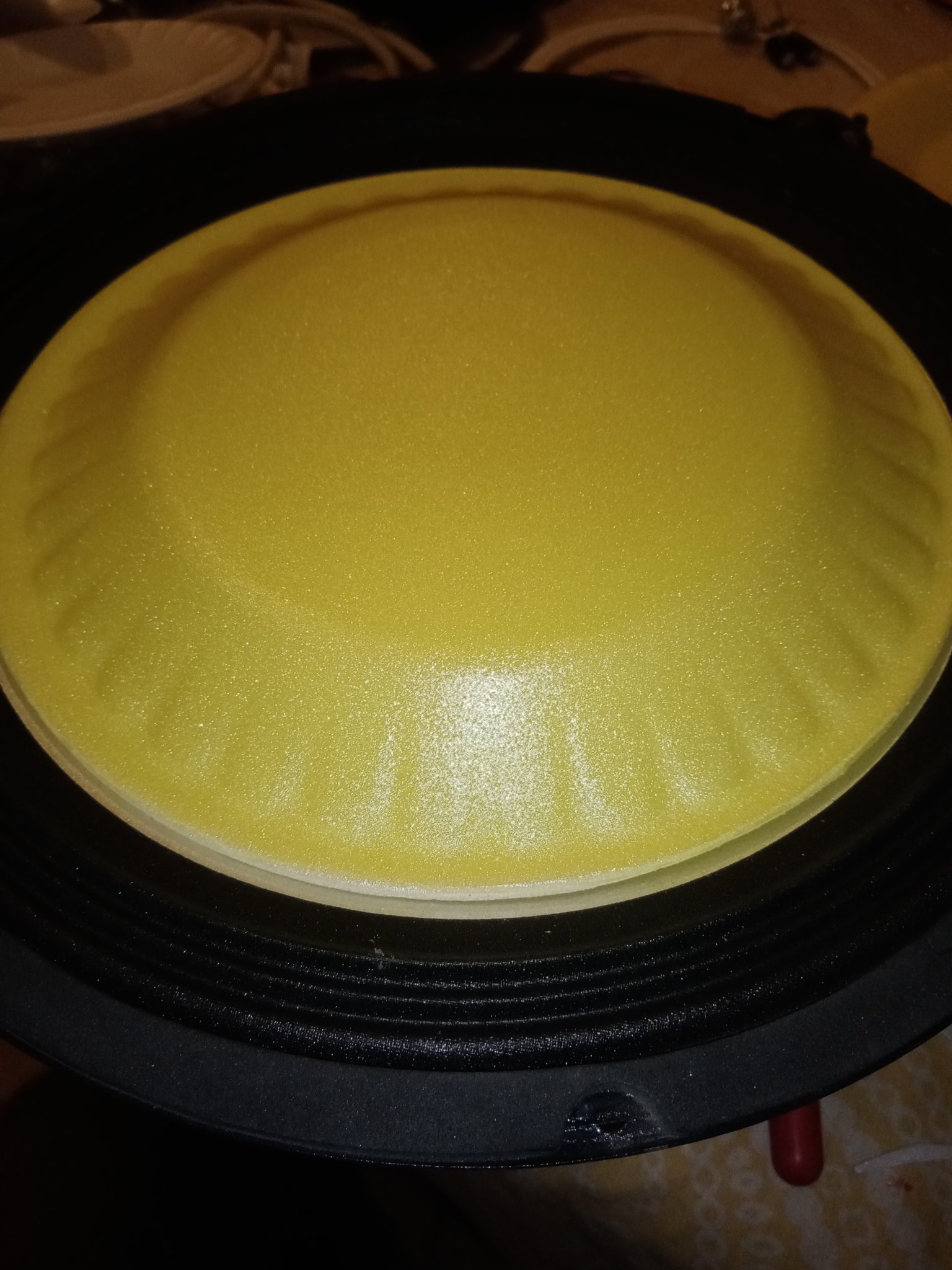

Preparing a 30cm driver for subwoofer use.
Stiffening technique with polystyrol (here dishes for eating).
Forming a "bridge" for the center.
And using silicone seal.
Put a weight on and let drying one day.
Putting a weight on the polystyrol cone.
Its only functional it does not need to be "nice" as the subwoofer driver will not be visible.

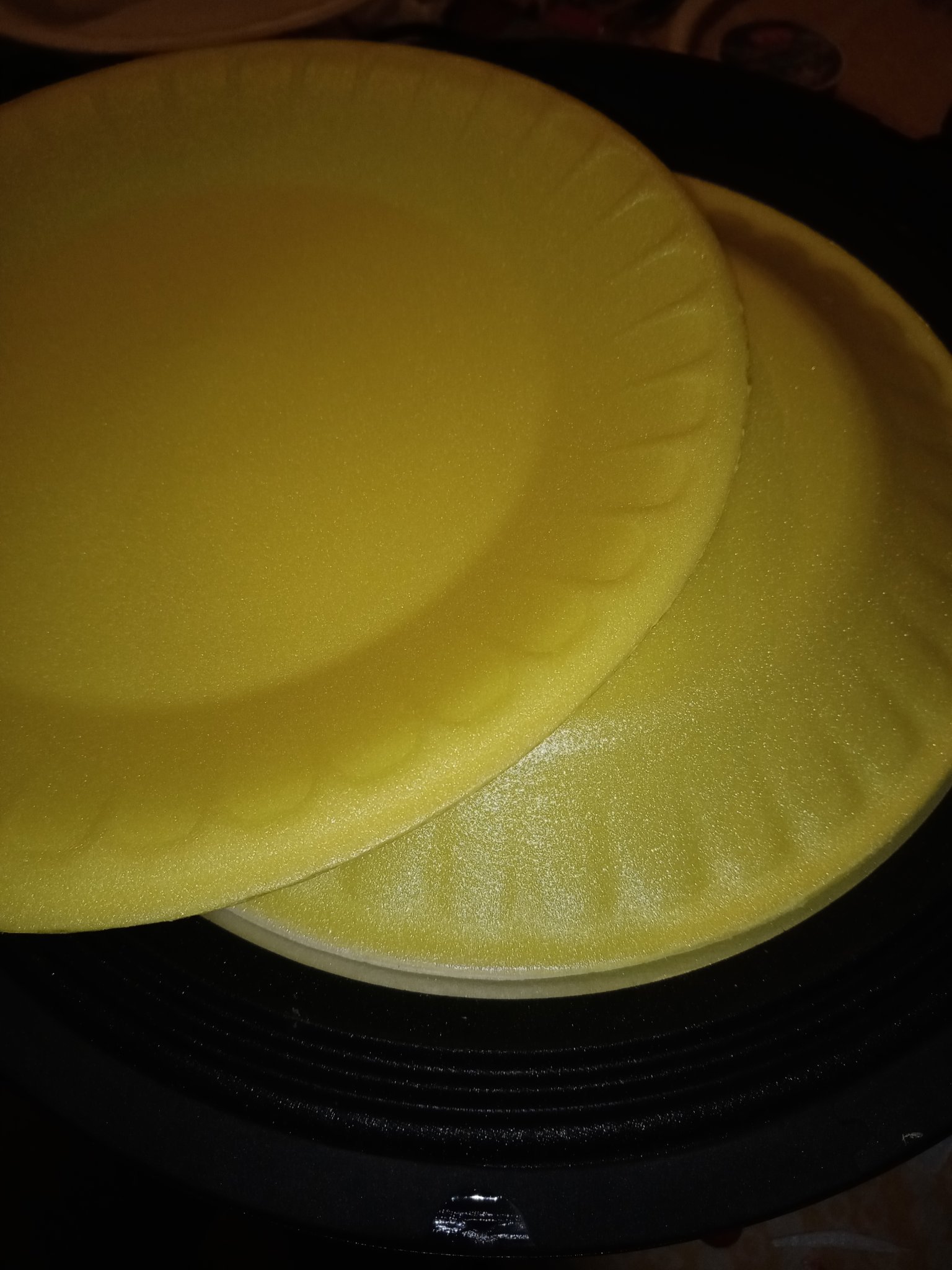

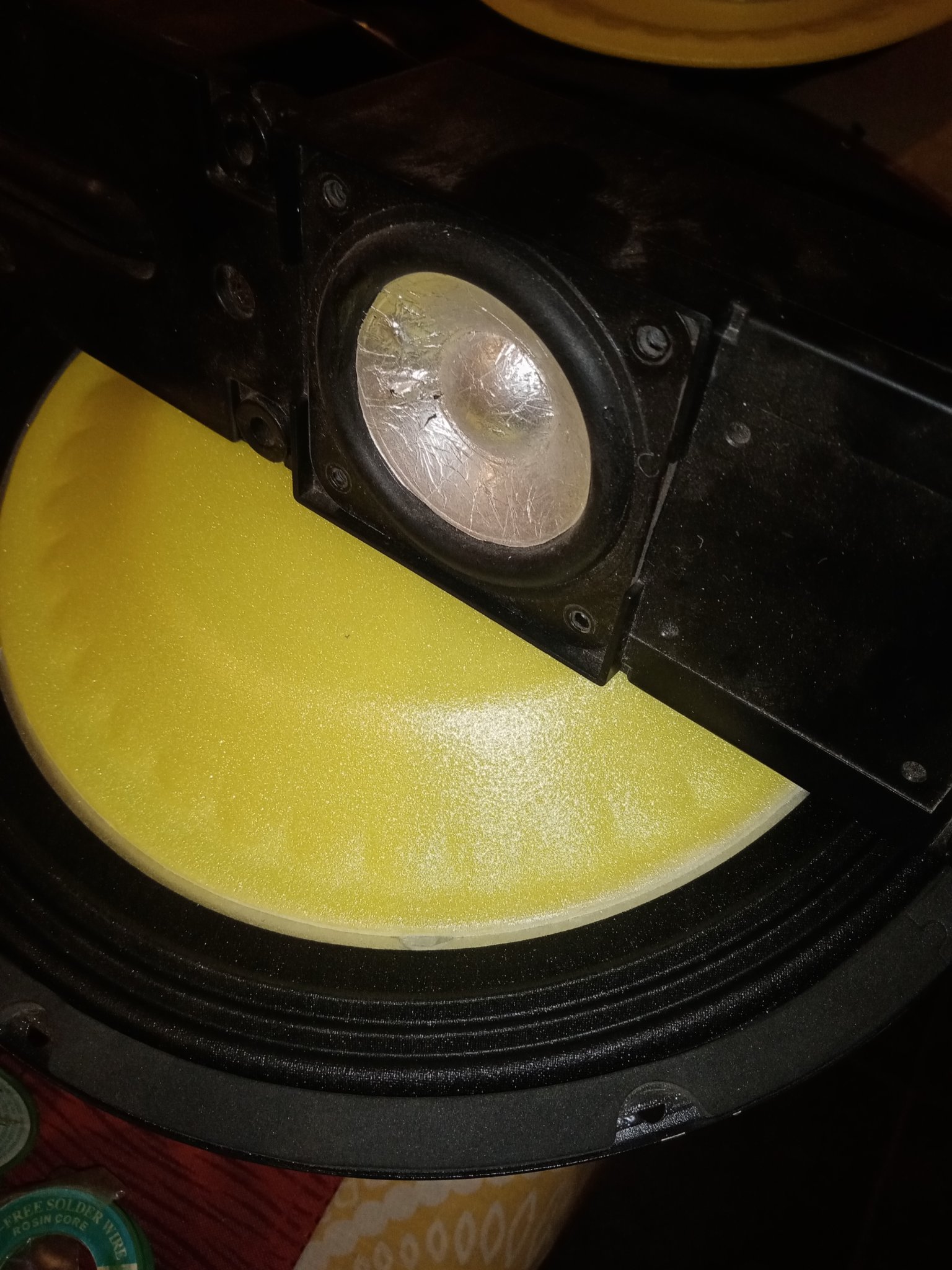

Who does not like the look could add aluminium foil to the polystyrol adding some more stiffness.
However in this example the stiffness is a result of the depth of the construction.
Aluminium foil can be used for making a sandwich cone.

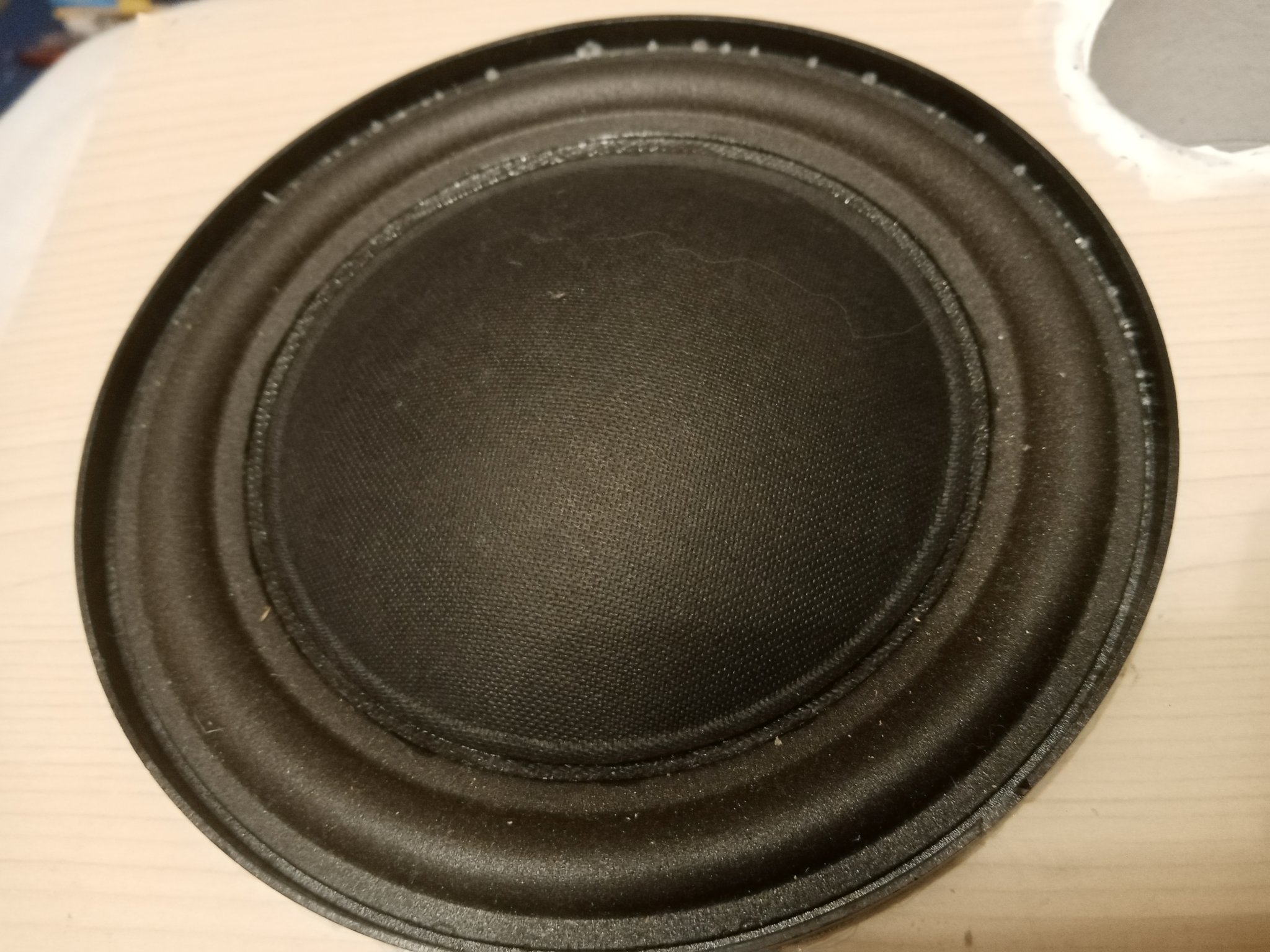

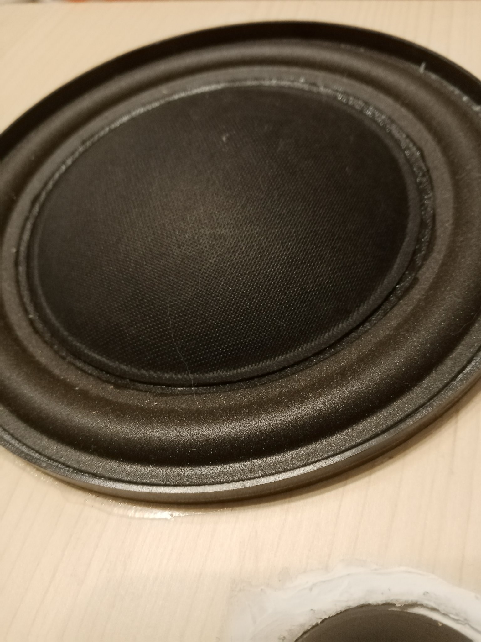

Hello,
here I want to describe how I do make a sandwich cone with aluminium foil.
This can be done with normal household aluminium foil and normal glue you can buy everywhere as "universal glue".
You need a scissor and the materials like aluminium foil, glue and the loudspeaker.
The foil can be applied easily to paper cones / diaphragms.
You can use thin aluminium foil from the gold smith and the glue they sell (in german "Anlegemilch") for making sandwich cones with polypropylene loudspeaker cones as here normal glue will not work. Also for delicate whizzer cones the thin aluminium...

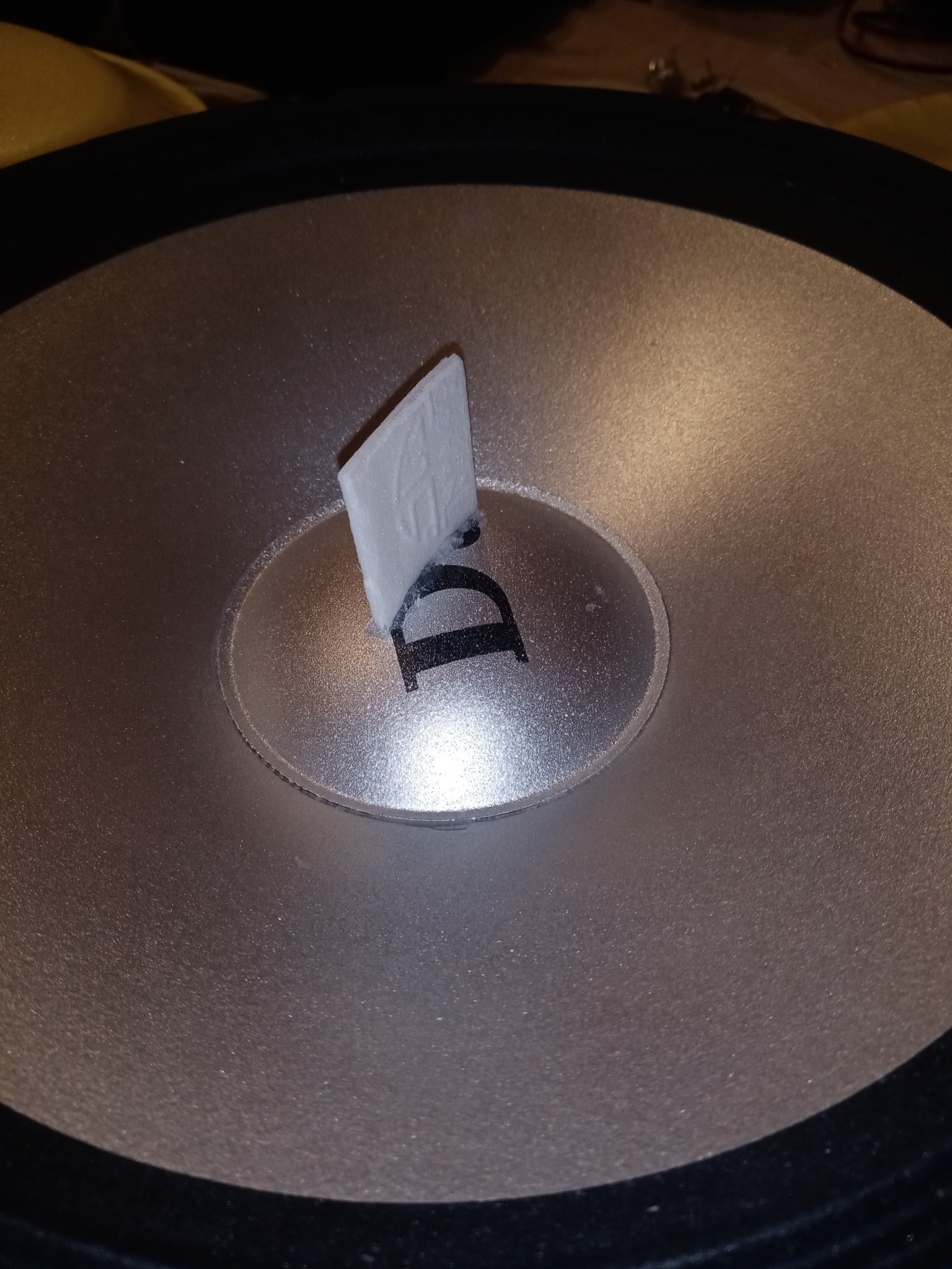

more orthodox diy cone stiffening using
a big dustcap
on a 15cm driver
the subwoofer inside the box is with 1cm concrete and only 3mm wood panels just offering the form for it
a big dustcap
on a 15cm driver

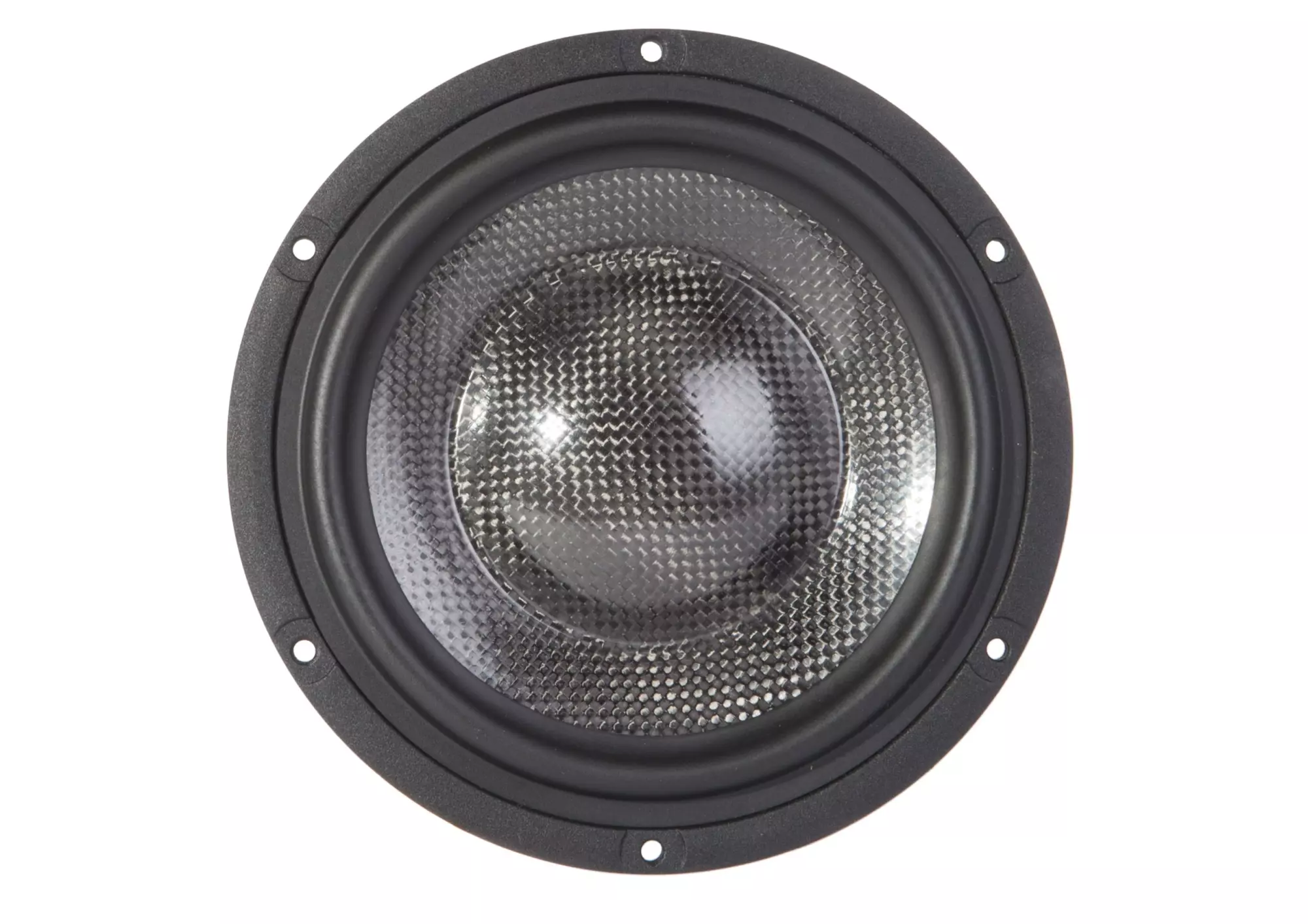

the variations of hard cones I know of are:
Rohacell as a core (better damping than polystyrol)
and carbon fiber for covering it
Morel did a driver (expensive one) which looks pretty good as a fullrange with these materials
Eton
using Kevlar honeycomb core and kevlar coverings
which got over the years better damping maybe due to dampening glue

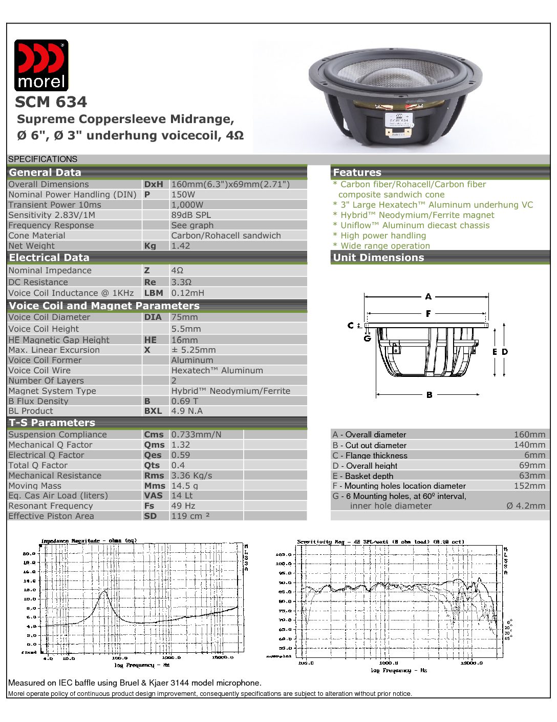

Morel SCM634 it was tested in german diy magazines
https://www.morelhifi.com/en/products/raw-drivers/supreme-45/scm-634-442
the waterfall looks pretty good, too. As I remember.
