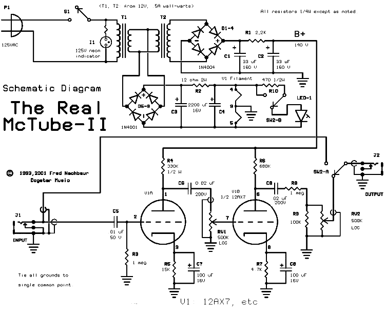

hi, i'm thinking of building an overdrive pedal, a bass overdrive pedal actually. I've run into this 2 schematics:
SWR IOD bass preamp (which is pretty weel known in the bass communitty and has very good reviews).
and the Real McTube II:
Now i have some question:
Referin gto the first schematic.
I understand pretty much the whole schematic, but i don't knowwhich voltage transformers to use for the power supply.
I also want to know, if there will be any difference in performance adding a load to the power output on the power tube, or there will be no difference sound wise.
Referring the second schematic.
Would it be posible to use this schematic as the input for the EQ section of the first schematic? and not using the tube gain stage of the first schematic?
thanks! i'm an engineering student and i have basic electronics knowledge. I'm reading a few tube books. Do you recomend any?

Well the first schematic isn't a pedal- it's a whole amp! (And there's more solid state in it that I care for!!)
The Real McTube is, unfortunately, p*ss poor. You can get it sounding half decent if you totally redeisgn it, but then it's not really a Real McTube anymore. It is however, a good place to start. It's pretty easy to get it going and then tweak to taste afterwards.

Merlinb said:The Real McTube is, unfortunately, p*ss poor.
Yours is the first negative comment I've heard about it. Can you give detail to your comment?
Most tube OD's are not meant for bass and sound crappy with them. As a bass player, look at running the tubes at *very* low current (I have 1Meg on the 12A_7 anodes with 250 to 300V supply and the anode set at B+/2 bias). Follow with a cathode follower or varieties of.
thanks Geek, i'll experiment first with something you propose. But i wanna build the whole fisrt schematic sooner or later. I need to know what the 53VAC from AFX1 means....i guess it's 53 volts of AC ?!?! so i would need a stepdown to 53V? but homw many A's it needs to handle.
It's being regulated to a 15V split supply. Any transformer with a 30VCT and higher secondary @ 500mA will work I'd say. Rather than Zeners and resistors, you can use a 7815 and 7915 for simplicity.

oh yeah i see, so i just find a setpdown to 30V with two 15V outputs and a pair of voltage regulator (one for +15V and one for -15v) and then i don't need the whole power supply part of the schematic!!?!?!
