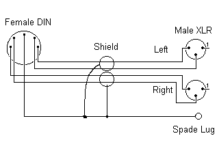

DIN Phono Cable -
DIN Phono Cable -
I am going to make a DIN to balance phono cable. The wires I am going to use are Neotech NEI-2002 and Cardas 4x33 shielded. The construction is based upon Ayre's. The Neotech wire is not cheap but it is still acceptable. The length of the cable will be about 4 feet long. Each channel gets 3 feet of Neotech wire and a foot of Cardas wire. Any suggestions are welcome.
