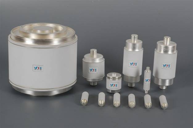

First off vacuum caps are available in the small pf range. I seem to recall a 100pf
10kv being about 2" x 3" .
Could you recommend any manufacturers?
I have seen even a variable HT vacuum capacitor for HF transmitter use. Very special construction.

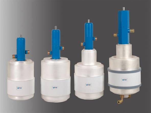

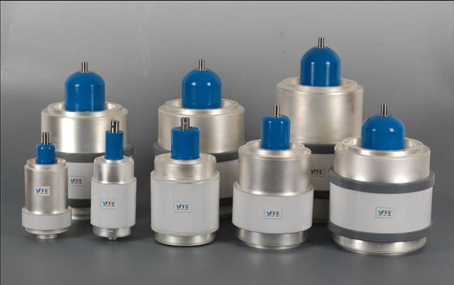

Sparked my curiosity somewhat: My uncle was literally 'cooked/fried' during his years as a WWII Radio man with all the exposure he endured near transmitting equipment. I know they have been used for decades as antenna tuning couplers for short wave & AM transmitters......but a curious search found this from Greenstone USA:
From their Website: ( I learned somethings )
Current VacCap applications: Plasma deposition and etching equipment for the semiconductor industry, flat panel display (LCD) and data storage (HDD, DVD) manufacturing......Plasma fusion.....High frequency generators for drying/sealing etc......Antenna tuning units or couplers....AM and Shortwave Broadcast Transmitters......Medical MRI
Current designs are usually one of either: 1)Fixed vacuum 2)Variable vacuum 3)Variable vacuum water cooled.

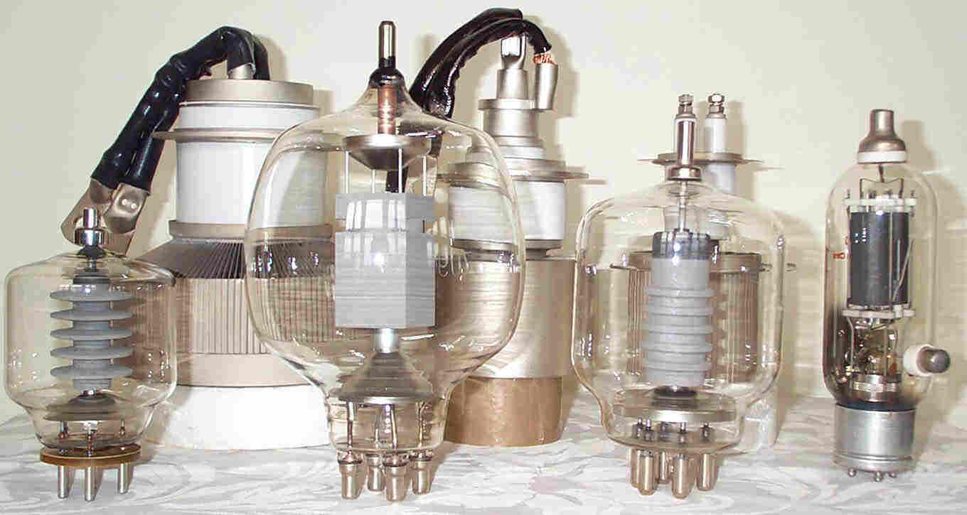

Broadcast vacuum tubes
Broadcast transmitter tubes are still basically unchanged......they will 'cook' you: nowadays at least they're well known for that..
Of real DIY interest.....appears these guys are gearing up to also made 'production' audio-grade Valves.
