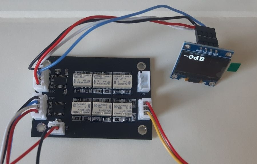

I have a similar project with 1dB steps, -63dB max attenuation:
The MCU can handle potentiometer, encoder and i2c control. For the input/output selection and more control I was thinking to have another module. Not everyone needs multiple inputs/outputs 🙂

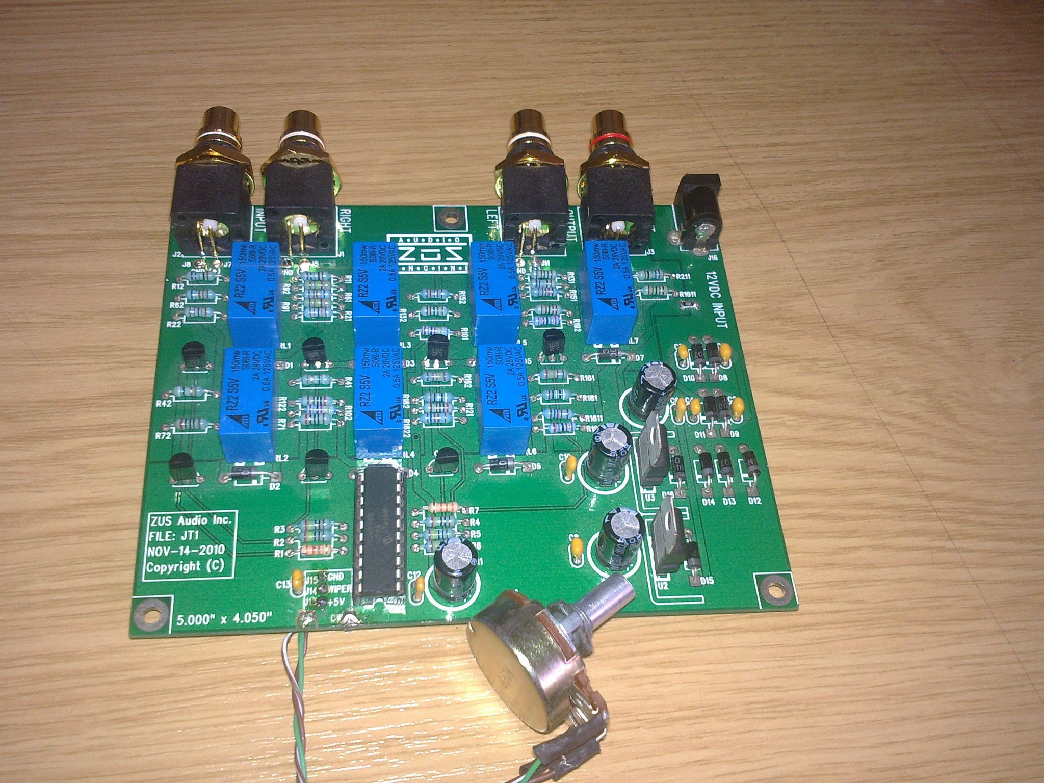

I have an audiophile quality relay based attenuator that is fully balanced, and has many features. Arduino Mega driven. See:
start at post #508 for the last design.
