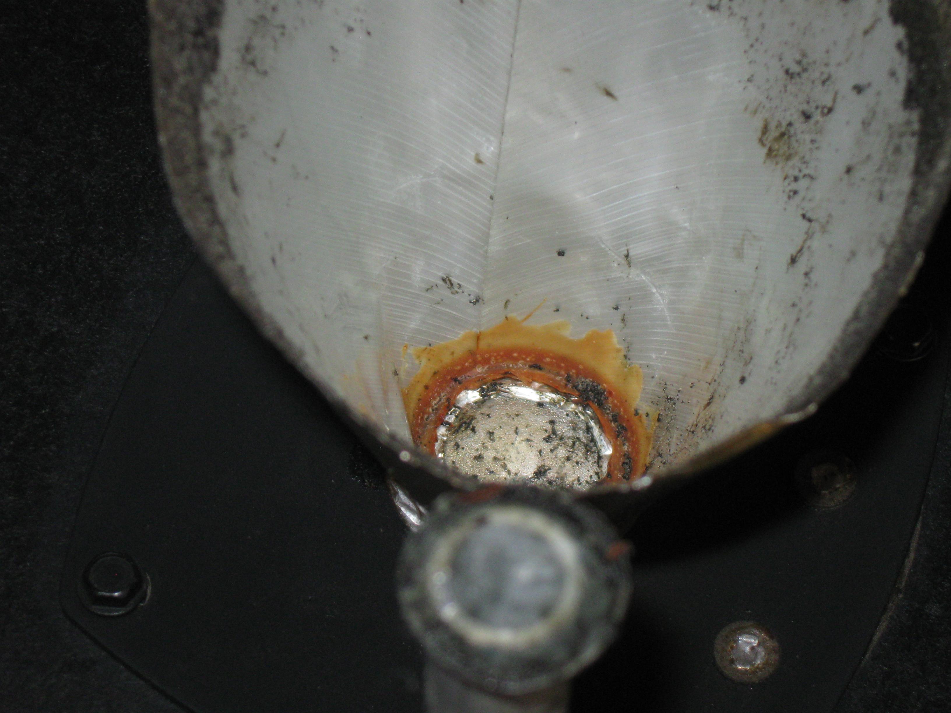

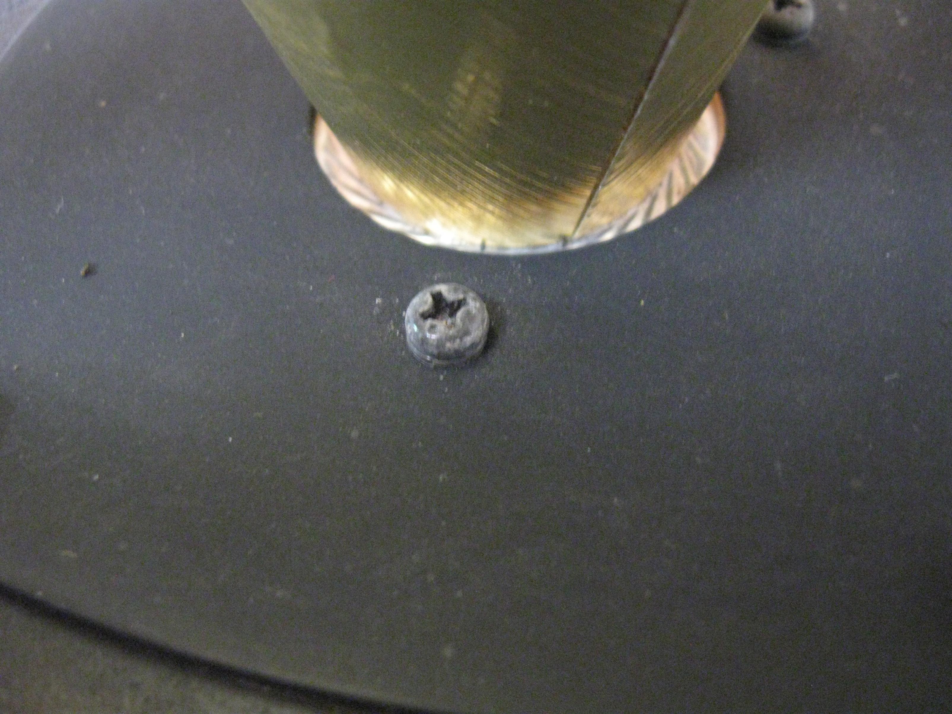

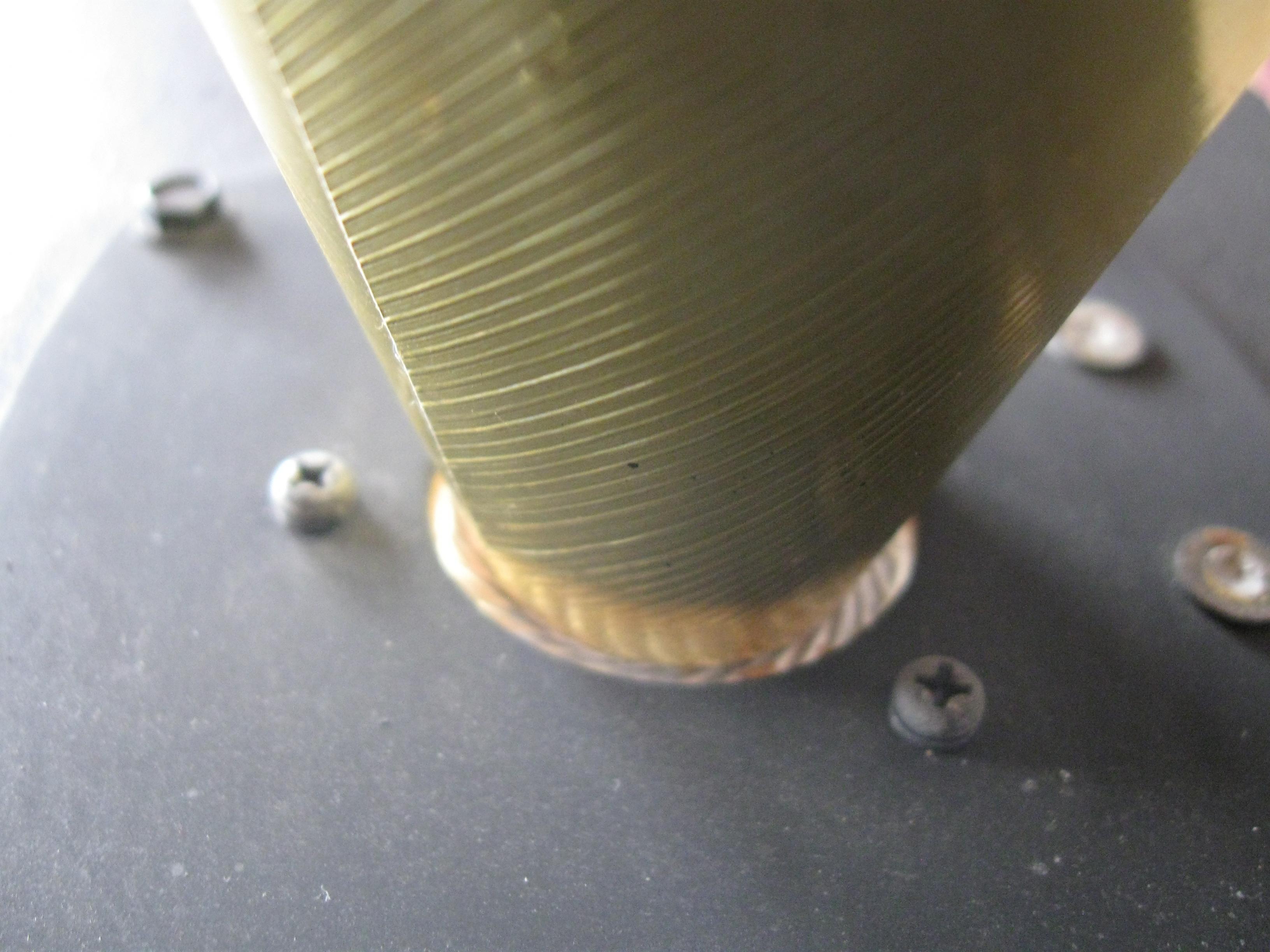

Here is few shots. I will take more if needed.

Cambe-
Please send a few more photos- I would like to see the whole banana as well as the top. Especially the top- we need to see if they did anything inside that may make it diffcult for you to get them apart.
I don't recognize either the "cone" or the driver. The ones we built did not have those diagonal striations, nor did the Seas done tweeters we used have, but as I said, I don't know what Infinity did when they went on to production.
At this point, assuming there is nothing inside you can't see holding them together, I'd say you have a very good shot at remaking these. So far, I see that you can take them apart using an offset screwdriver with a very steady hand. Remember that magnet is going to try to ruin your efort.
Once you get the top plate off, you can use a caliper to dertermine the diameter of the voicecoil. Now you know the VC diameter of the dome tweeter you want to look for for a repair. Check Parts Express, and look for cheap tweeters you can take apart.
If you can find a dome driver that's close, you should be able to seperate your cones from the voicecoils. I would suggest you use a Dremel with a thin cut off wheel to avoid deforming your cones. They smell bad, but in a steady hand, they can be effective without a lot of collateral damage.
If you want to take it to the next level, let me know. If you wish, you can PM me, and we'll talk on the phone.
Jay

Cambe-
I want you to look very closely at the area at the base of the cone. Is it white, sort of like putty? You may want to try to get a tiny bit of it on the end of a toothpick.
I may have misread your photos- that could be white heatsink grease smeared over the surround of the tweeter-
J

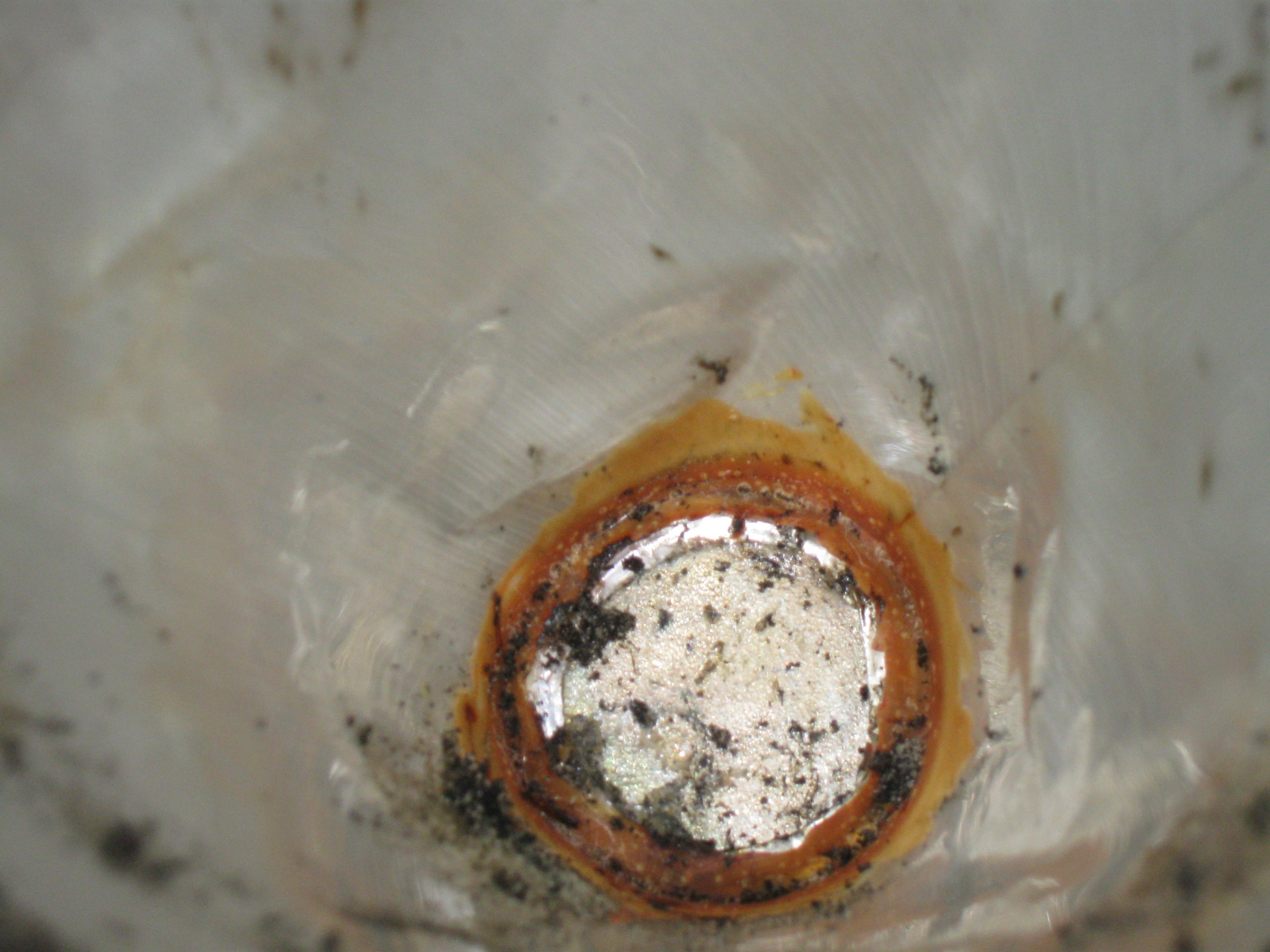

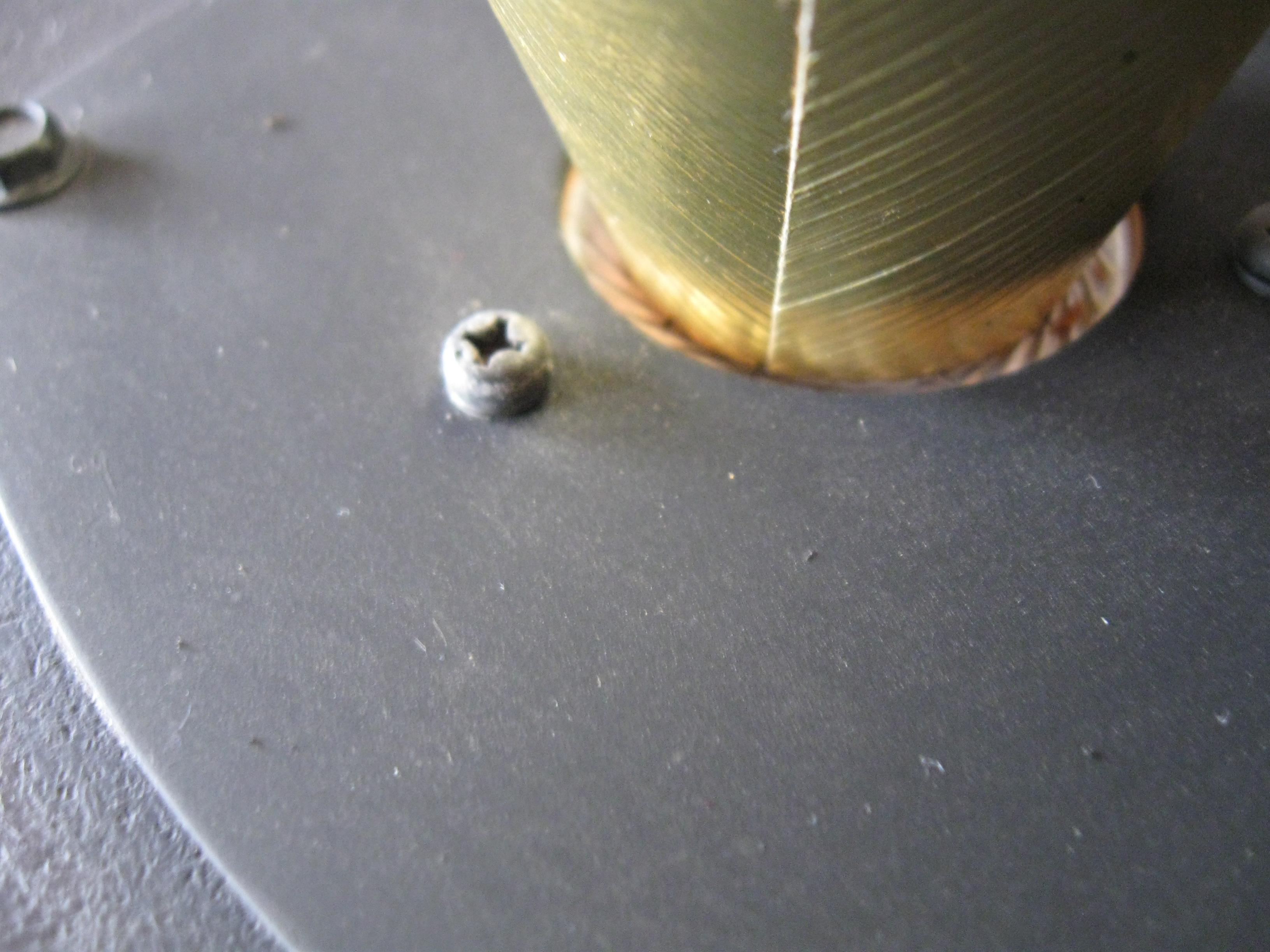

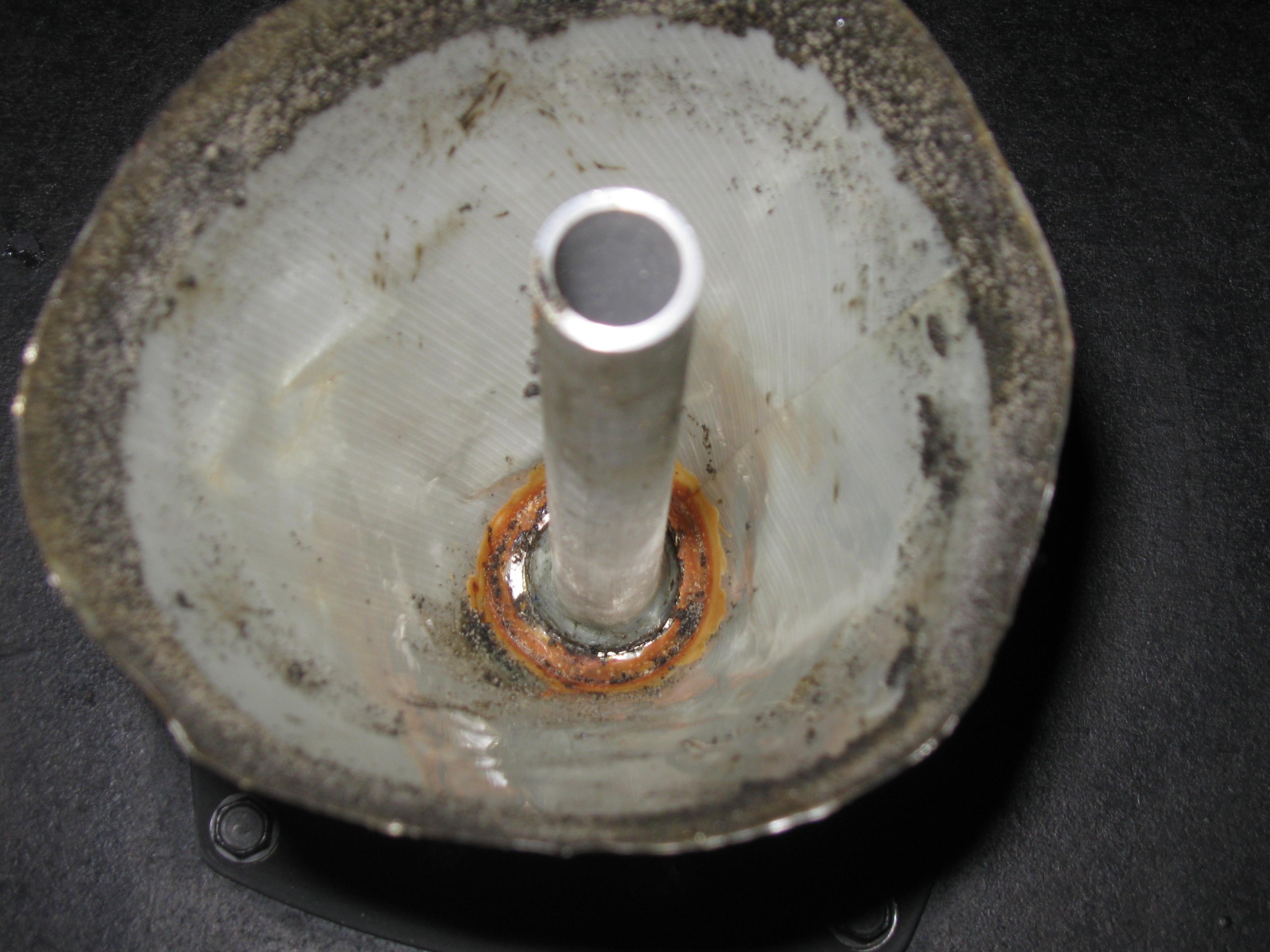

Hi Jay,
Here's a few more pictures. The tweeters once had a "poured in" expanding foam in them which has long deteriorated.

Cambe-
Well, they sure don't make damping materials like they used to. My original assesment is obviously wrong- you need to start over. You can certainly do this if you don't mind mind experimenting.
I'll be happy to help, but right now, my shop is in storage, so I can't do a build along and trade photos with you. The most difficult part is getting the dome cut off of the tweeter and fitting your new cone to it. Be prepared to make several, because you're going thave to figure out how to damp out resonaces in the "cone", (that's what the foam inside was doing) and terminate the edge so the acoustic wave does not reflect back down the surface. Trial and error and a lot of listening.
The damping and termination was and is where the "voodoo" lies. You can use just about any thin material that is stiff enough to transmit sound and hold it's shape.
