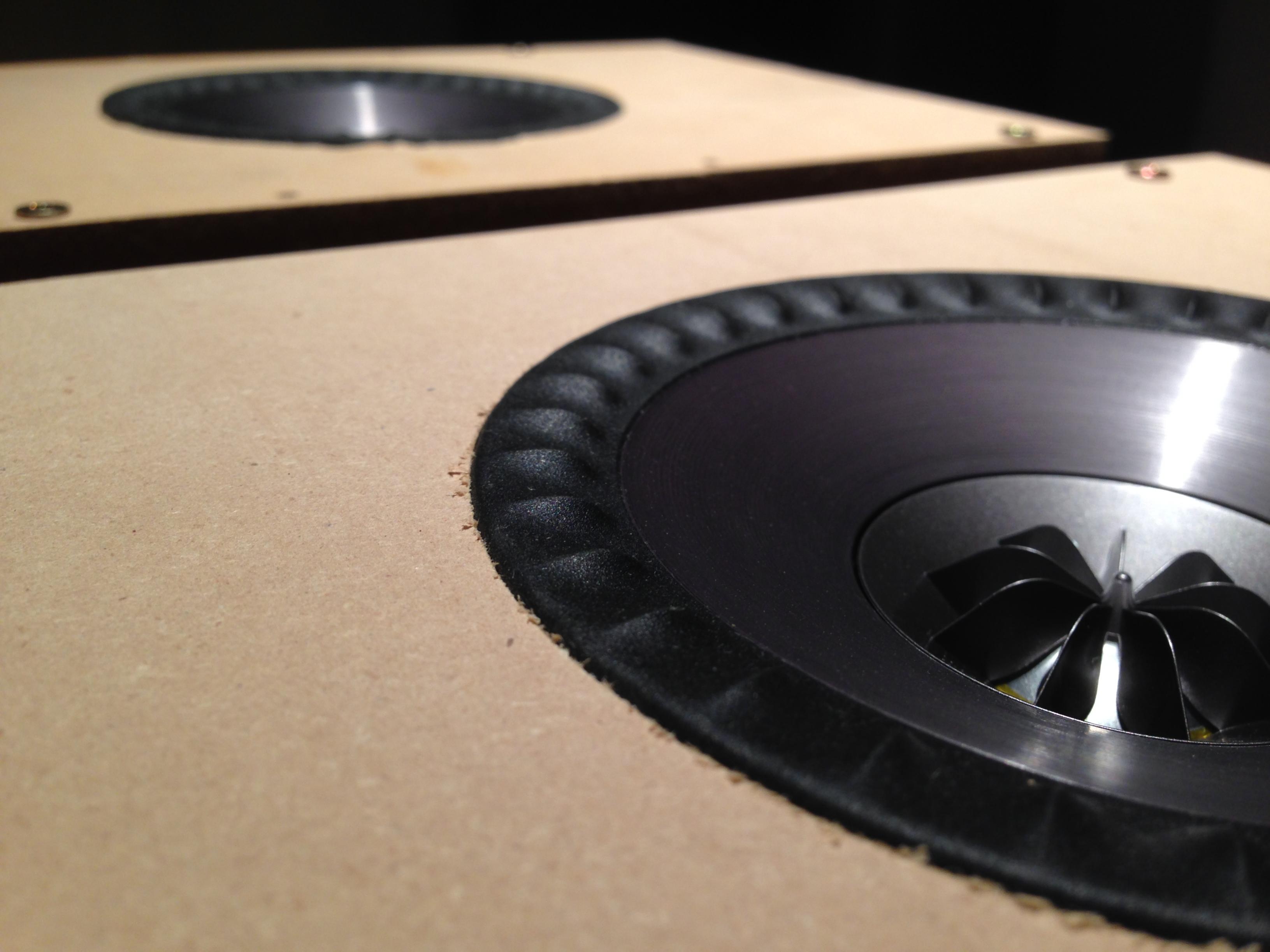

After making the driver cutout there isn't much material left to hold the driver with screws. So, I went for a brace from the back to push the driver into the front baffle. I put some rubber sealant tape thingy along the cutout and on the brace.

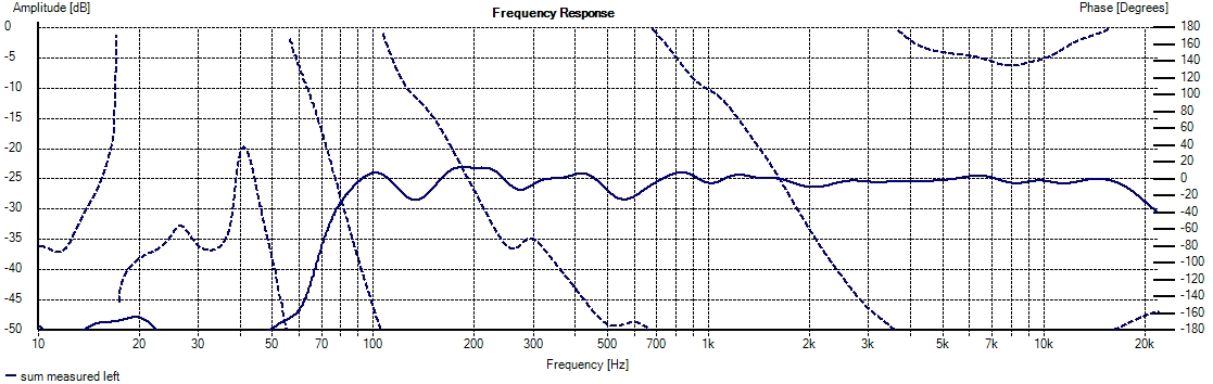

I haven't spent much time on the crossover. It is something like a 4th order LR4 around 2 kHz (using MiniDSP). There is good phase overlap through the crossover and it sounds like one driver.
The sound is fantastic. It sounds very similar to my big system -- A7+SEOS-24. Tonally, it is very similar. The most surprising aspect was the size of the soundstage -- it is huge. Images are quite large, realistic and comparable to the BIG system. It extends well behind and to the sides of the speakers.
Dynamics are also quite good, although, they are limited when it comes to percussion. Music that has heavy content below 200 Hz starts to cause strain. But if they can be crossed at 200 Hz to a woofer, they ought to sound even better. Anyway, they sound quite good and I can finally calmly work on improving the A7 cabs. Questions? Comments?

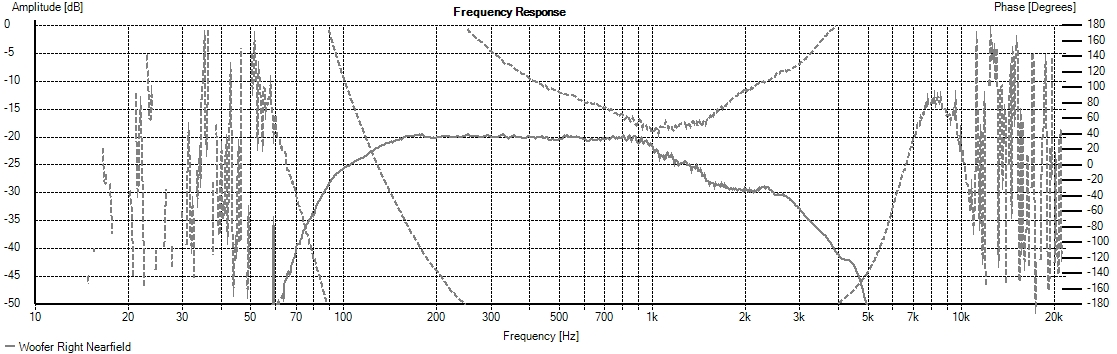

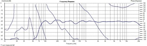

Pics show the setup, cabinet, flush mounting, nearfield woofer response (unsmoothed) and farfield summed response (3rd octave smoothing).

On-axis looks good! Have you measured off-axis?
One think that hit my eye is that bump in the woofer response above 2kHz - or is it dip below since you aim xo at 2kHz? Anyway with minidsp you must use PEQ to make the acoustic slopes to follow acoustic measured LR4 curve also past xo-point. Only below -30dB level becomes not-so-important. This kind of easyness of response shaping make dsps superior to passive xos (unless you are a genius with loads of components to throw on a board)

Thanks for your comments, Juhazi. No, I have not measured off-axis. Actually, I need to take the speaker outside to make proper farfield measurements. It's been windy and cold outside, maybe next weekend.
The first curve is the woofer nearfield. The mic is placed a few mm from the center of the cone. In such a measurement, the intent is to get an idea of the box alignment and the HF should be ignored, so, ignore everything above 1 kHz. I'm not showing the spliced nearfield/farfield response. I have it, I can post later today.

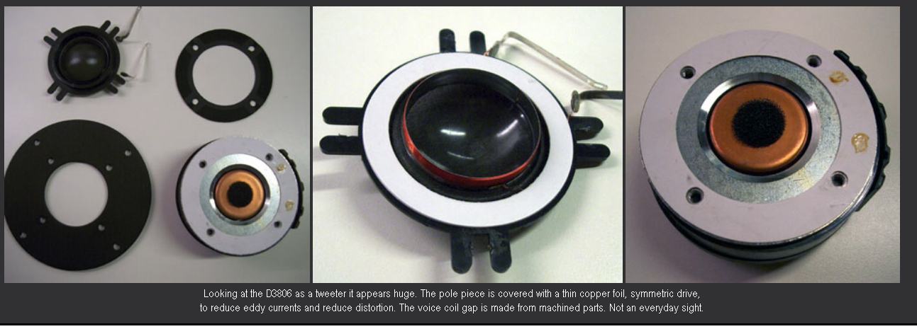

I use the KEF SP1632 (KEF R300-R900) in my design and it sounds awesome. One thing though, I wouldn't use the tweeter much below 2.5kHz, because it starts to distort like crazy below that. Distortion is of no issue if the tweeter cross-over is around 2.8-3kHz.
For details on KEF measurements:
KEF SP1632 Measurements!

I was surprised by the soundstage size as well. The woofer is very smooth, as you can see in the nearfield, unsmoothed measurement. I used to think there is a problem with metal cones as well, but I just don't hear it. If the frequency response is smooth and you tame the resonances, it probably doesn't matter what material the cone is made of.
