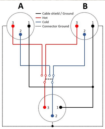

Hi guys! Im having a lot of problems trying to make an a/b switch pedal! I'm trying to replicate this one
https://www.stompbeat.com/index.php?route=product/product&path=61&product_id=64
but I don't find the right diagram for the switch connection! can someone help me?

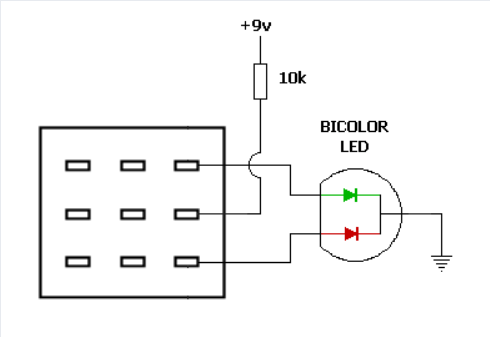

What you need is a dpdt push button switch
If you need led indicator, use a 3pdt push button switch instead.
