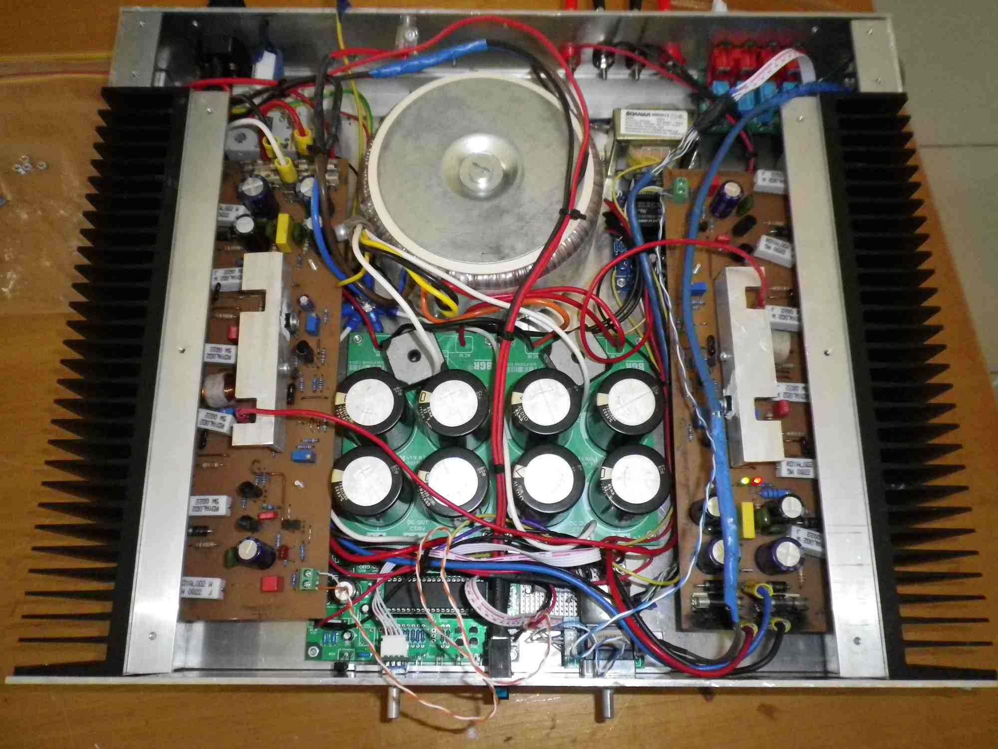

Although the schematic is large, the board really helps to simplify building.
This might take an hour or so of soldering, but it should be easy.

I used a 600va 2x40v one for mine. The amp is capable of 180w into an 8 ohm load so there is some headroom. or you could use a couple of 300va ones. Oh yes and I also installed a soft start.a beginner question: how big of a transformer do I need for this amplifier, and can you recommend any?

A quick PSU question -
I have a pair of single 120v primary/49v-0-49v secondary transformers of indeterminate VA, but the best guess is around 300. They should be great for a HoneyBadger.
I am planning on using one per channel.
The build guide mentions about 40,000uf per rail of filter capacitance. Does this change with a dual-mono setup like I am planning? Of course, I could just go nuts and have an excess of caps, but that doesn't actually appeal to me. (And anyway, 80v caps are expensive...)
Any ideas or suggestions?

Hi 6L6!
I have tried 'em amps with as low as 10,000uf per rail for two channels!

I have doubts about the settings of the presets "ccs" "bias" and "offset", nor understand the meaning of 'r18' and 'd3 (zener diode) "
Please read post #2 and click on the "Direct link to original documents" and then read them carefully. Or you can go to the store and download the construction pdf and read everything carfully. All the info you need is already there.My query was about settings
