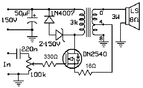

So here's what i am thinking:
a single TO-220 DN2540 on a 200v supply. 60-80mA and a 5K:8 transformer load. 10ohm source resistor. Cap across source resistor?
unsure of power output or even if this is feasible?
thoughts?
I am looking to do a small 1 transistor / mosfet amp.
Thanks!

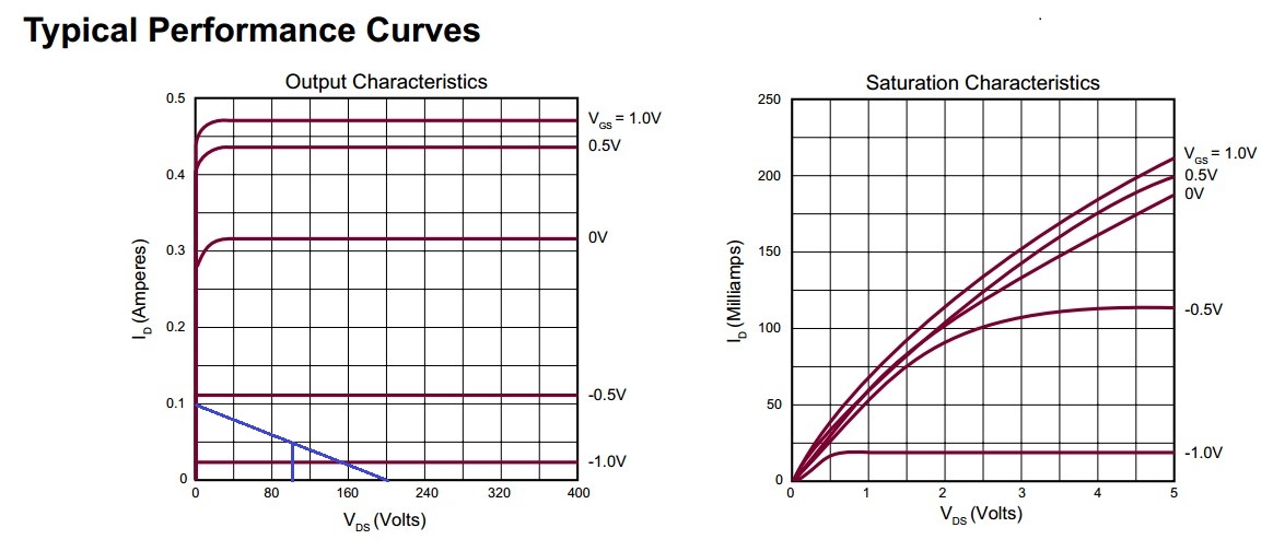

The TO-220 has a 15W dissipation limit. If i go to about 75% of that or 10-12W would that work?
thinking 150v supply. 60 mA to 80mA.
If i do 3 DN2540 in parallel.. could use a Edcor 1.25K:8 output transformer. might get 10W output power.
Even with a decent heatsink you would not go above 5W on the 220?
100V@50mA with 1k:8 would get ~1watt of output and be doable for 1 device.
