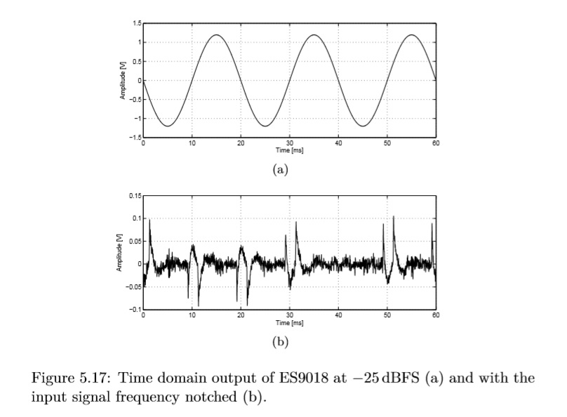

A lot depends on the type of DAC chip as to which opamps might be suitable. For example of one type of problem, Scott Wurcer once posted a picture of an ESS hump distortion residual showing what is clearly a non-PSS (periodic steady state) type of distortion. The DAC chip was an ES9018. IIUC the output stage opamps ESS was using at the time were AD797. Also IIRC, Scott said the picture was taken from a study done by ESS:
These days the opamp of choice used by both ESS and AKM is OPA1612.
Some of the other opamps recommended in this thread may not be suitable for use with some sigma-delta DAC chips for reasons described in a couple of threads over at ASR:
