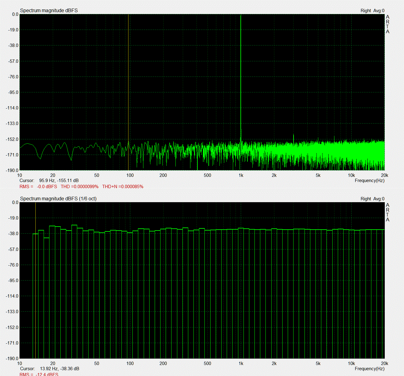

This depends on your sound card. With mine I have the option to feed the digital signal being processed by the sound card straight back into the computer without any conversion going on. This makes it very easy to see if windows is performing any shoddy sample rate conversions too! Have a look at the input options in any of the programs you are using, if all you have is mic input and line input then you're screwed and will have to do a loop back. If you've got like wave monitoring or mix monitoring then you might be okay. ARTA will function for free, but wont allow you to save.
Attached is my card in internal loop back mode.
