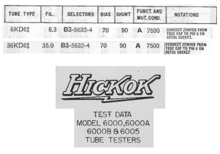

If you have one can you please share what your roll chart says for 6KD6 and 36KD6? My chart is old and does not have them. Thanks!
Chart is available at https://elektrotanya.com/hickok_600..._tube_testers_tube_chart.pdf/download.html#dl
I have a better copy but too large to attach here. The jpeg attached should be easier to read.
