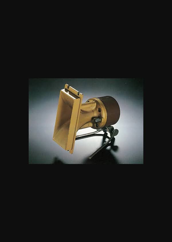

You may find this interesting, only thing is the tweeter I could not find anywhere.Nice looking woofer. What do you know about it? What do you know about the tweeter?
https://www.google.co.uk/url?sa=t&s...sQFnoECBcQAQ&usg=AOvVaw0TjMKTHhhMYTsKOf3dDKAW
Hope its a good read for you. Also could not find my speaker there and the network devider, some sort of crossover unit in a box that allows volume control for horn tweeter. Cleaver stiff/thinking back then.

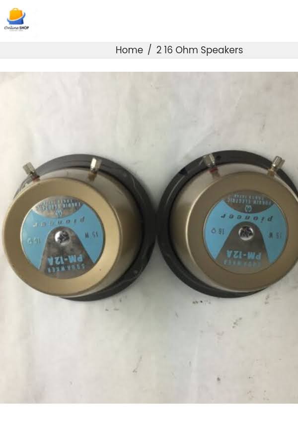

I ma not sure your model number is correct?
Seen several places different drivers in CS-A31. But im not sure, look in the first link.
I believe the PW-12A driver of your is the same as the PW-30A. dont know how close the pw-12c is to pw-12a in specs though, but linked below.

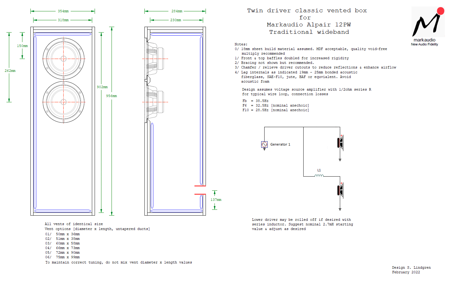

To Astrojet. What's a wide band 2.5 way? Sorry for my ignorance but I only know what I know. Asking questions helps. Thanks any suggestions on what I should do with my speaker?
This with the PT-3 on top. Matching widebands with an inductor on one and a cap or something on the tweeter.
Your woofers look awesome and if they haven't degraded too much over time, I'd try to use them in what would no doubt be an unsuccessful 3-way Frankenstein if they were mine -- and the lack of success would be due to my relative inexperience in speaker design.
But, my best suggestion to you would be to start a new thread based on them and let the amazingly knowledgable and kind members of this forum help you find what you are looking for.
https://www.markaudio.com/wp-content/uploads/2022/08/Double-12PW.png
