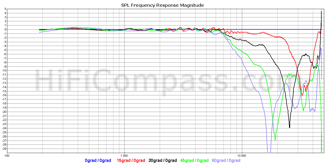

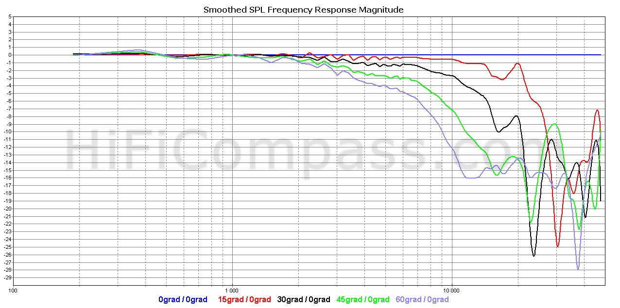

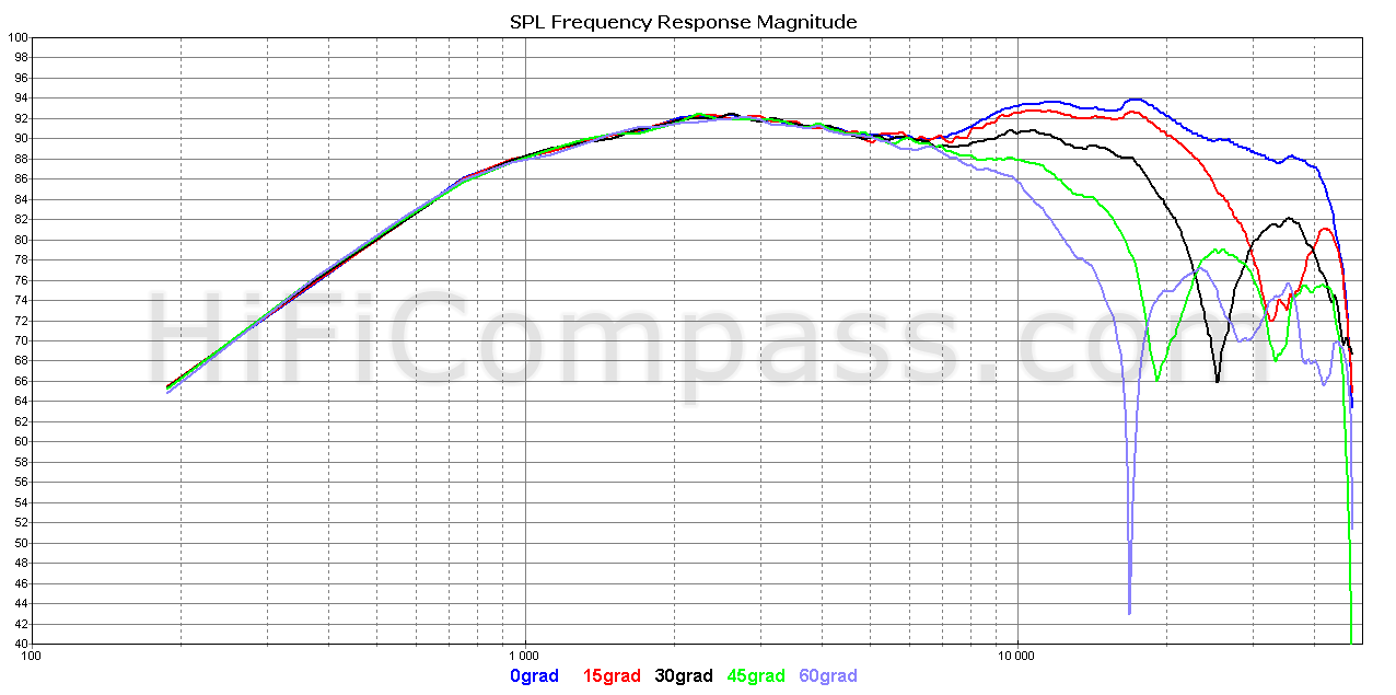

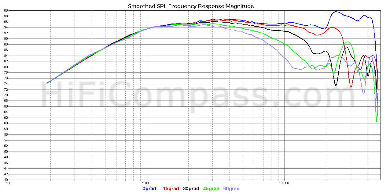

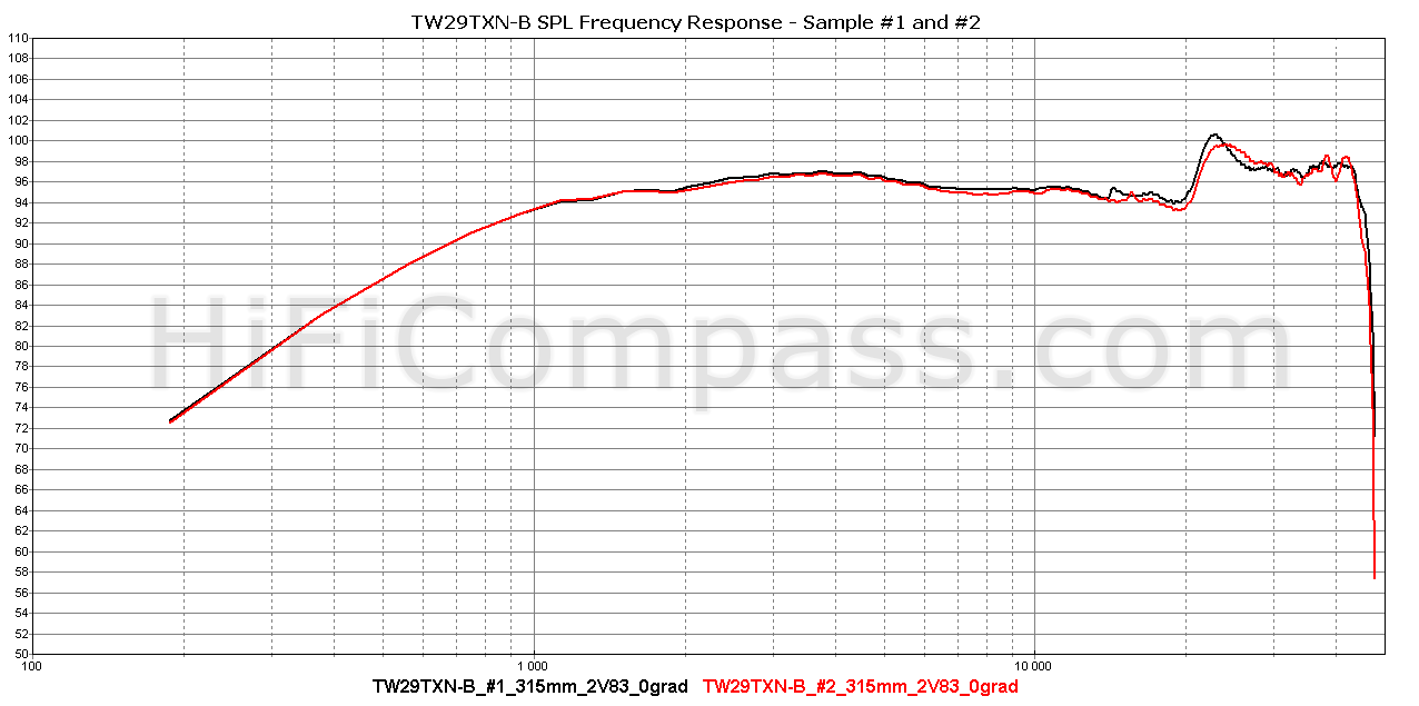

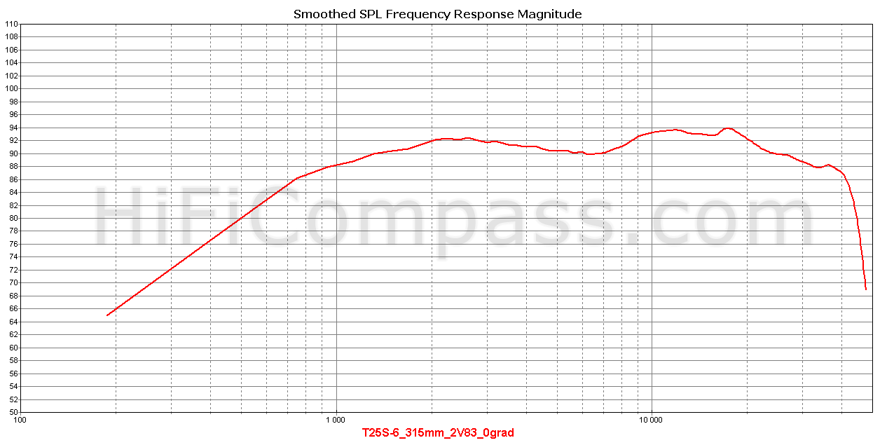

Hi, thanks for answers very interesting read. In this specific case, tweeters im goin to use are:
-T25s-6 bliesma (silkdome)
-Tw29txn-b 8textreme)
Are these well behaved on ultrasonic end?
