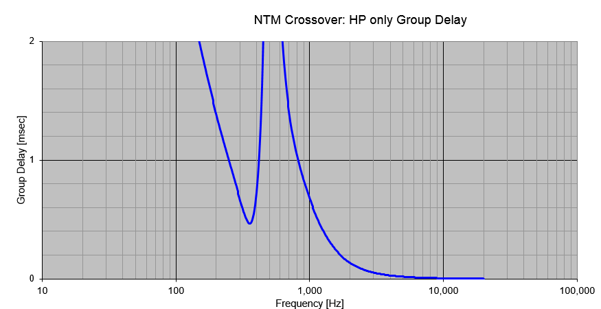

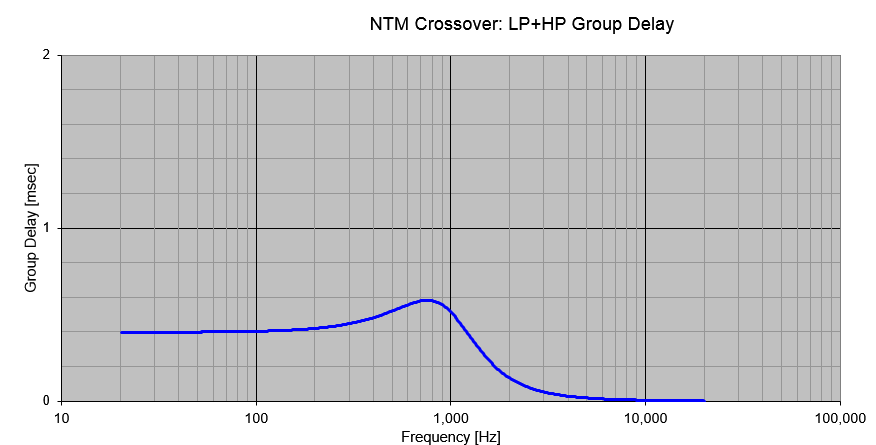

I have attached the some plots of the group delay of the NTM crossover of order 4 (filters only, no drivers included). I happen to have a sim of it so I am using it as an example, but this would also apply to the LR4 crossover from which the NTM is derived.
The "system" of lowpass plus highpass is characterized by a low peak in teh group delay at the crossover frequency of 1k Hz, with the woofer (<1kHz) having more delay than the tweeter (>1kHz). The individual group delays for woofer and tweeter can look quite different. For example, I disabled the woofer output and then calculated the group delay for the tweeter only (attached). You can see that the tweeter's group delay contributes to the peak at 1kHz, and between about 1kHz and 2-3kHz the GD is dropping down to the passband level from the peak at 1kHz. You can more or less ignore the rising part below 1kHz or so, because this will be "weighted" along with the SPL when both drivers are enabled. But it is good to keep it in mind when planning group delay EQ strategies.
What happens if you try to add digital (frequency independent) delay to the tweeter to match the passband group delay to the woofer group delay? This will make the group delay peak at 1kHz higher, and that is definitely not helping the situation. And the same goes for analog allpass. Neither of these approaches are a great solution.
The best and most general way to achieve flat group delay for a loudspeaker system is to first develop the crossover, then measure the group delay, then use an FIR filter to flatten the group delay profile for the entire loudspeaker and crossover system. The FIR filter can be inserted upstream from the crossover. You can also flatten the group delay of a loudspeaker with a passive crossover in this manner. An FIR filter can be designed to have the "inverse" of the group delay profile of the loudspeaker as a function of frequency. This results in flat group delay and is easy to achieve down to the 50-100Hz region. Below that the woofer will have a sharply rising group delay curve and an FIR filter will require many, many taps to be free of ripple, etc. Above 100Hz you can get perfect "linear phase" (same as flat group delay) response using this approach.

Digital (frequency independent) delay and allpass (frequency dependent) delay are both tools in the toolbox. But neither of them are exactly what is needed. This is because the delay that you would like to equalize of the loudspeaker (in total) or any one or more individual drivers is not frequency independent.
Understood. So, basically, because of this kind of connection between frequency and phase, analog circuits can't give you a clean answer.

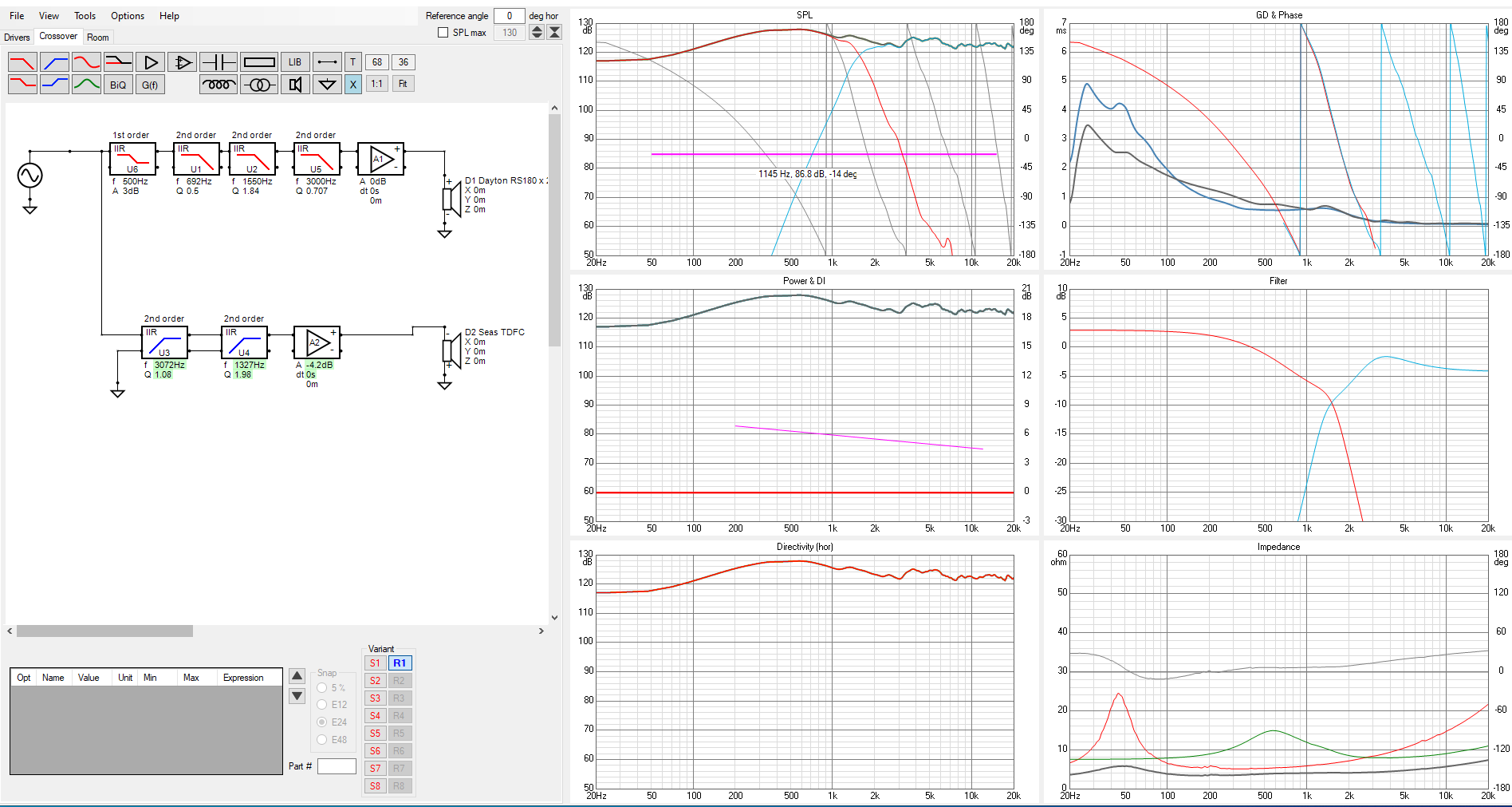

BTW, after your post, I went and read up the NTM crossover page at Rod's site. Interesting. I went over to one of my own designs and looked at the group delay graphs. For a fairly steep 6th order two-way xo (left side of image), the group delay graph is shown in the top right-hand corner. I guess there's a clear correlation between the SPL curve and the group delay curve -- your NTM has a dual-hill SPL curve and so does your group delay curve.

I guess I'll just continue to do this for my analog active xo, since VituixCAD lets me sim active blocks.
