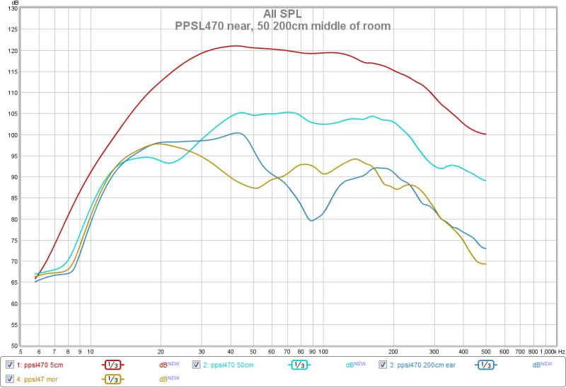

Anyway, I like downfire low bass and have made two different multiway speakers that way. And a subwoofer with two 15" drivers slot-loaded. The attachment shows the 2x15" PPSL measured nearfield and at various spots in the room.

Look like gold is an almost perfect place to sit as a near ideal sub house curve. While the opposite for green.
C'mon tell us that gold mic location is standing on your head in the corner?
I get similar results when I move my mic around (I use a mic floor stand - very helpful tool). Makes you wonder why people calculate passive crossovers to two decimal places when the room is the big influence. With passive crossovers there's no feasible adjustment later.

Golden line is "mor" which stands for th emic being in the middle of the room also vertically. The 50Hz dip is vertical mode nulling in this case.
Yes, measurements tell many stories! Nearfield is the standard for subwoofers and reliable per se. But even at 50cm ground plane in a room starts showing room modes and reflections!

Golden line is "mor" which stands for th emic being in the middle of the room also vertically. The 50Hz dip is vertical mode nulling in this case....]
Great. You don't have to stand in the corner.
Gold line MOR really does seem like a great place to put your chair for best bass SQ.
Near-field and anechoic (out of doors) certainly have their place as standard lab (in vitro) techniques. But for the DIYer, it is the "bottom line" (mic at your chair) that is the criterion.
