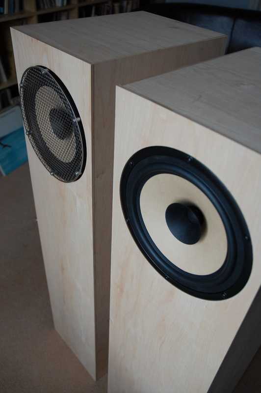

Has anyone measured or heard a difference when the driver is roughly 1/3 from the top dimension versus at the top ?
On more of a pencil, or mltl design, absolutely, anything column-like, where 2 dimensions are fairly close, then the 3rd dimension is 2-3 (or more) times larger, pipe-ish basically, I can see offsetting the driver, even seen the measurements.
My thoughts are it wouldn’t matter much on this big sealed 1 x 1.618 x 2.62 ratio box.

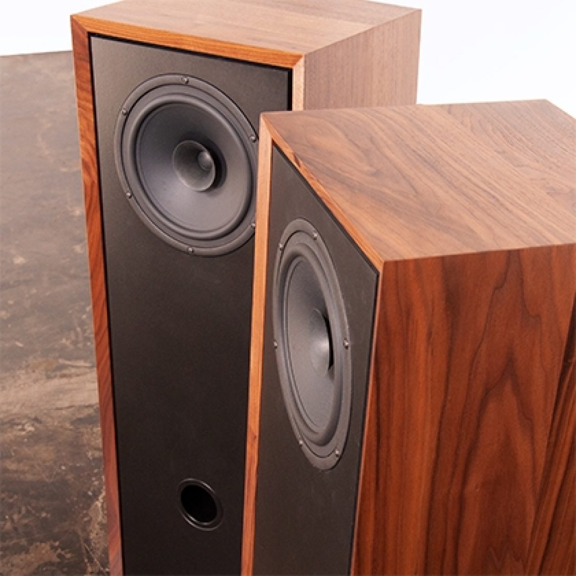

I don’t think placement (as long as not too close to a wall) will have little affect inside, but outside it will.
Not sealed but why not place driver also using the golden ratio?
This one not as big as yours (17 litre net, maybe 18-19 if it was sealed)
http://www.planet10-hifi.com/planset/fatCGR-extents.pdf
Bur i am working on a 35 litre one for things like Alpair 12pw, maybe CHN-110.

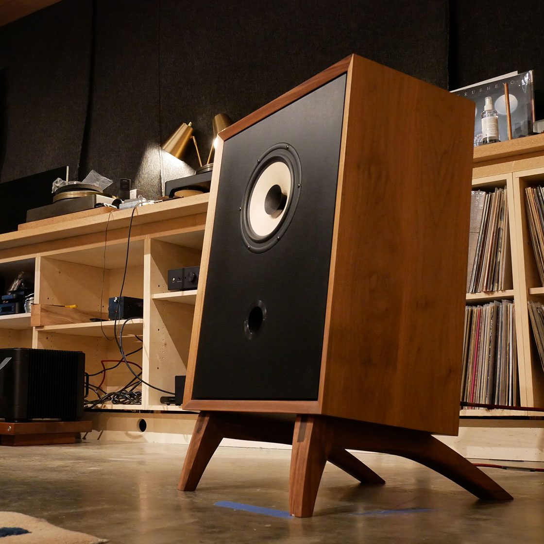

I agree, why not offset it, but....................
It is nice to not have a driver centered 20" off the floor also.
Especially if it will be occasionally used for tv...........
the raven 3 seems to be at the top too .............
https://parttimeaudiophile.com/2022/01/30/fern-and-roby-raven-iii-loudspeakers-review/
or even the recommended box by seas for the sealed f8 exotic............
https://www.tnt-audio.com/casse/seas_exotic_e.html
I'm not saying it's better, just thinking it may not be a deal breaker if you want the driver off the floor (without stands).....
fern & roby raven

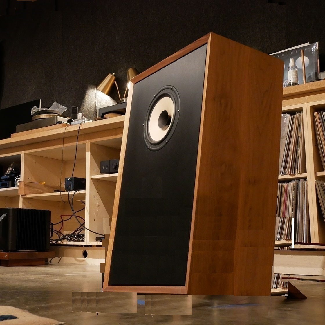

That is probably too much tilt-back. It takes little. 5° is sufficient for these (which are sealed and close to the dimensions in your example.
dave
