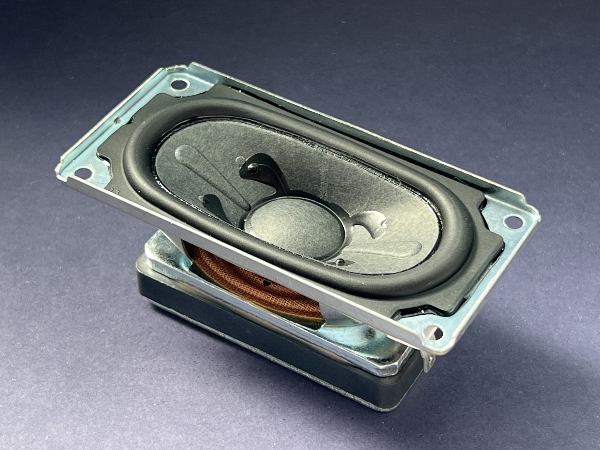

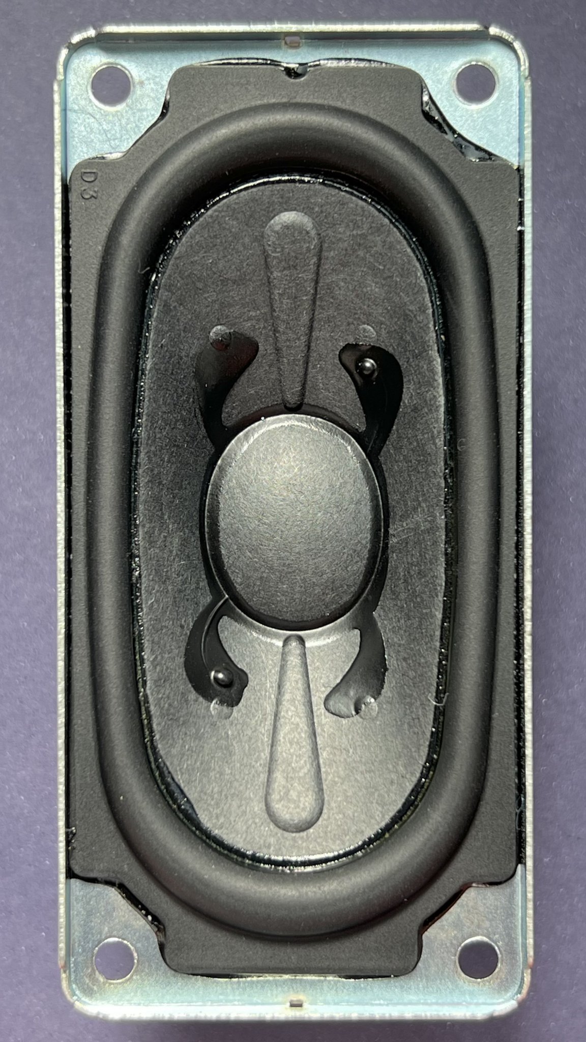

Has anyone used this driver for anything, Visaton SC4.6FL 1.6" x 2.4" Full-Range Speaker?
It appears to have a great frequency response and might be good as a driver for arrays. The downside is the power handling is only 5 watts. I don’t see that as an issue if 24 of them were used in a tower. $12.14 each!

I think you are correct with vertical mounting. Not having an actual driver in front of me, this driver may have slightly different dispersion between its horizontal and vertical planes. It may have less dispersion in the vertical direction while exhibiting wider horizontal coverage much like a planar driver or a slot driver.
My main issues with this driver is its power handling, its low sensitivity (80 dB) and its 10 dB roll off below 200 Hz down to 100 Hz. Also I have questions on how to mount this driver to a baffle. You have only a small lip edge to inset the body of it into the baffle.
The SB10 driver I suggested earlier would be a better performer and more straight forward to assemble on the baffle.

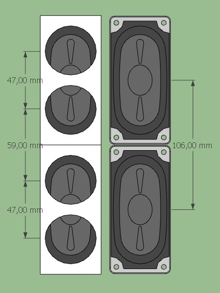

I thought they would have to be vertical for proper dispersion, but I guess not?
Vertically will give the best horizontal dispersion, but horizontal gets you a closer centre to centre. You’d have to do some experiments to see which compromise works best (for you).

First of all, thank you very much for the Near Field Line Array white paper. Reference document for many.I think you are correct with vertical mounting. Not having an actual driver in front of me, this driver may have slightly different dispersion between its horizontal and vertical planes. It may have less dispersion in the vertical direction while exhibiting wider horizontal coverage much like a planar driver or a slot driver.
While on the subject of the vertically mounted rectangular speaker, I would like to know if it would be useful to use a bulkhead in front of the driver to reduce center-to-center distances.
