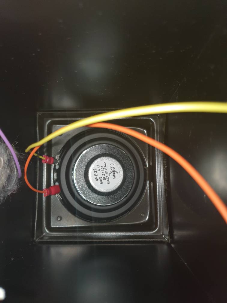

Finally got these done.
The drivers settled down a bit with some hours on them. I started cleaning up the cabinets to powder coat, only to realise the previous owner had painted them black... rather badly. The Anodised aluminium underneath was in pretty decent nick really once the paint was removed. I had some melamine acoustic foam so redid the bits round the tweeters, the grilles were sanded a bit with a dremel to clear the driver frames and new grille cloth fitted with hotmelt glue.
Overall for my £60 or so outlay I'm pleased with them. They sound pretty good, image superbly as desktop speakers, look very presentable. I picked up an old Rel sub to fill the bottom end in, which should sort things nicely I hope.
