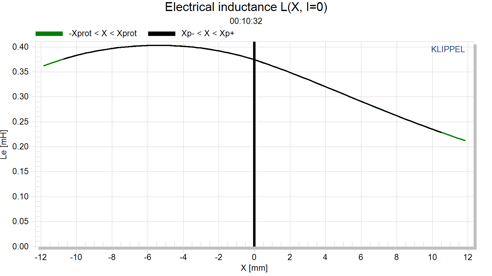

But in practice: Le impacts how much the impedance rises in high frequencies. With Le=0 then above the impedance hump the impedance will pretty much be flat. With Le>0 then impedance rises in high frequencies.
Then there is also the problem that usually, Le varies along the cone stroke. This means that when the cone is say +5mm Le might be 0.45, but at -5mm it might be 0.35. This is why Klippel tests for example plot Le as a function of the driver stroke. A high Le is more bothersome than a low Le but is not really a major issue. A high variation of Le on the stroke, however, is a problem and is often a major cause of distortion in the mid-high region. On average, better drivers (more expensive!) have less Le variations over the stroke.
Edit: Here are images to clarify from Erin's Audio Corner
Here is a plot of Le(x) where x is the driver stroke position:

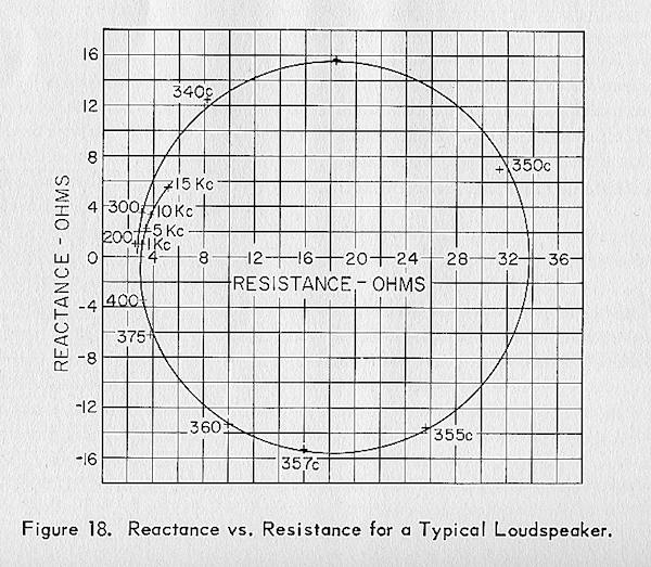

It may help understanding to see a full impedance plot, something very rarely shown for a driver, though not hard to measure. This is from an old General Radio Corp. manual for one of their bridges. Remember, capacitive reactance is negative, inductive reactance is positive.
In that graph, should the line in the middle actually say impedance? And that would be showing the driver resonance to be around 352hz peaking at near 34 ohms? I'm hoping I understand what is going on here, LOL!
Yes, at resonance the reactances cancel out and the device is purely resistive. Thus, I think the x axis is correctly labeled as resistance. No idea what ancient driver they used, but I do think the graph is a bit idealistic, or maybe more points should have been measured.
