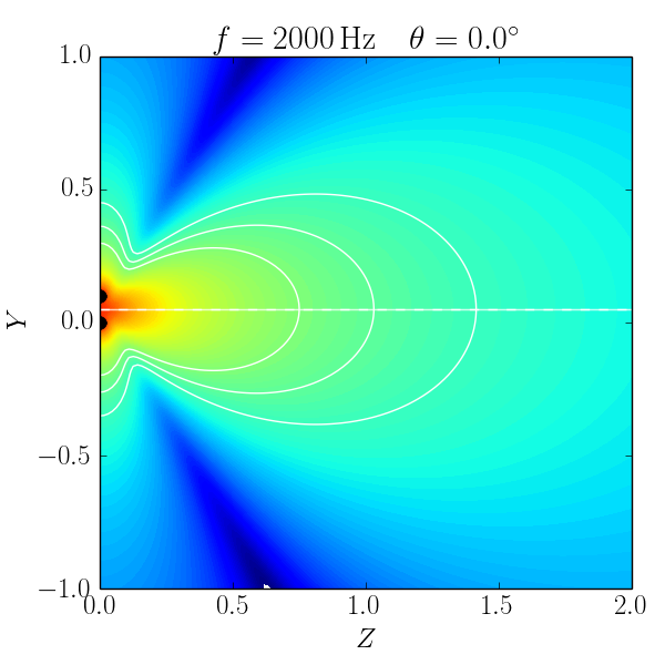

Understanding lobing is critical for successful crossover design. Here are a few simulations that illustrate the situation for a 2kHz LR4 crossover and 1cm dome drivers:
1. 10cm driver spacing
2. 20cm driver spacing showing lobe narrowing

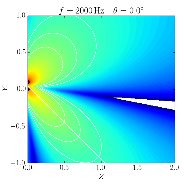

3. 10cm spacing and -10cm acoustic center offset showing downward lobe tilt

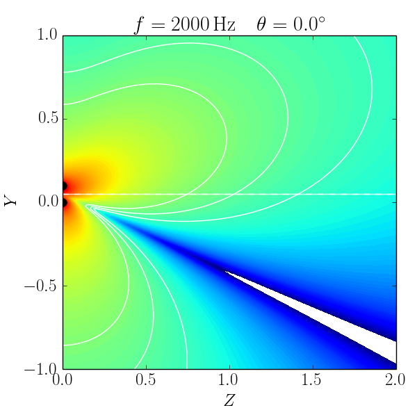

4. 3rd-order Butterworth instead of LR4 showing upward lobe tilt

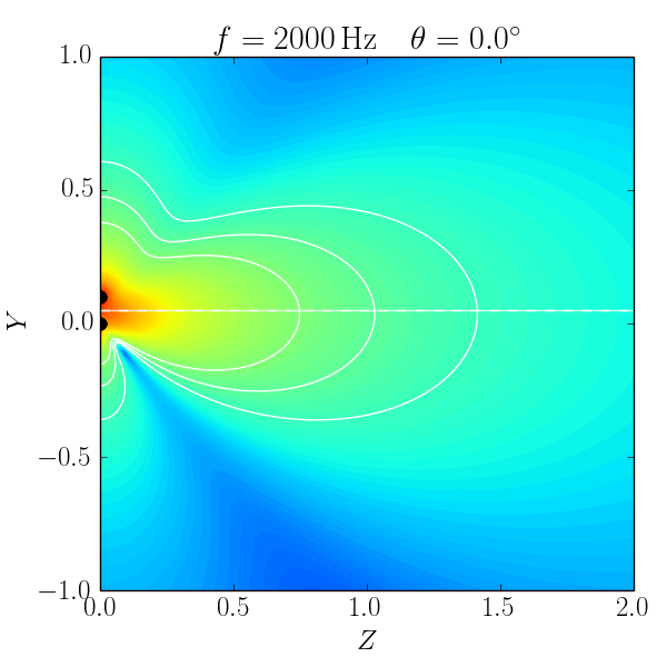

5. 6cm woofer showing (weak) lobe asymmetry.

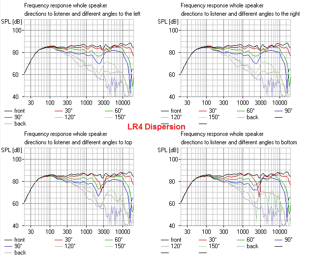

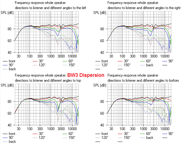

This is the BW3 Sonics Anima by Joachim Gerhard. Lot to like there.
18dB/octave 90 degree phase BW3 is quite special. It has more consistent dispersion off-axis than 24dB/octave phase aligned LR4 which always has a notch above and below axis. In other words, BW3 doesn't change its sound so much with listening position.
Amusingly, a reviewer criticised Joachim's design for falling off above axis. He just flipped the polarity on the tweeter to fix that. The lobe then went the other way. 😀
