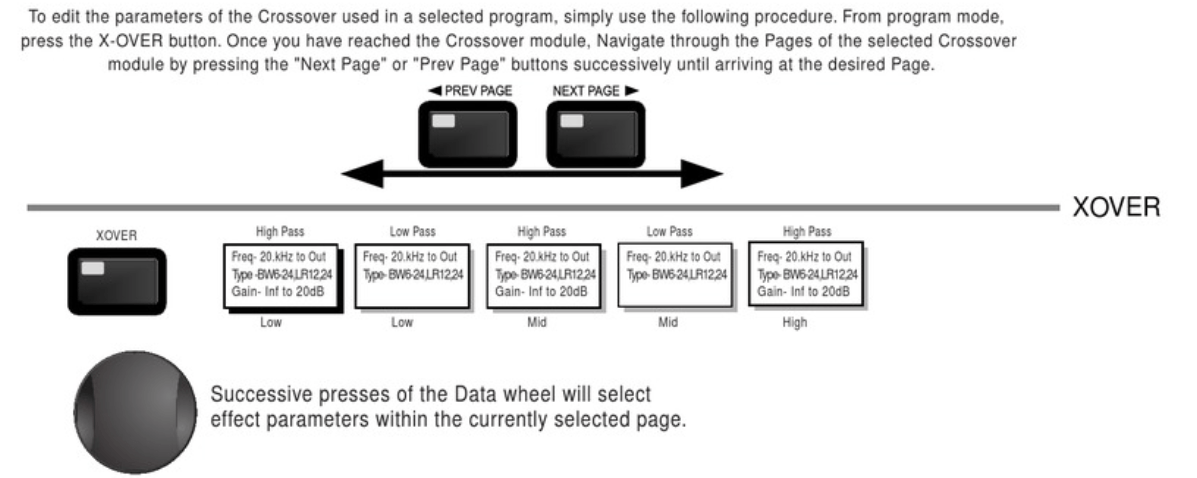

I looked through the user manual for this thing and I can't find anywhere to adjust the output gains, it just seems incredible to me that this device won't let you adjust the relative levels of your outputs.. how does one balance a 2 or 3-way sound system with it?
Conaski,
After learning on the DRPA, I found it harder to navigate on the Behringer DCX2496 😉
Page 22 of the user manual shows how to edit crossover parameters- each Xover output (Low, Mid, High) has gain adjustment from off (-inf) to +20dB.
If you don't look at the little boxes in that picture, you won't find anywhere to adjust the output gains in the manual.
Art
