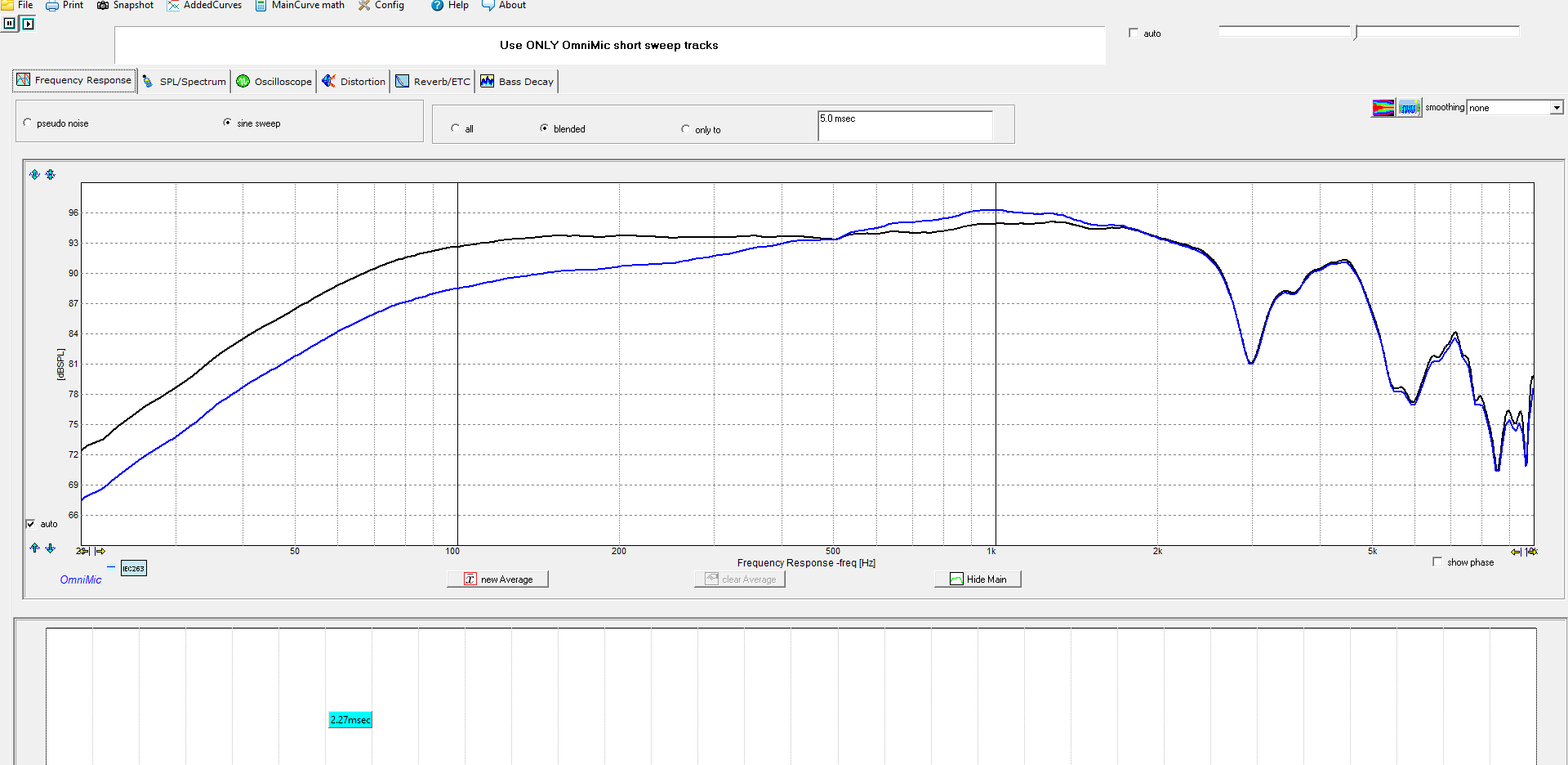

Here is an example. This is the measured response of a high quality 6 inch driver (Satori MW16TX-4).
The black curve is the infinite baffle response. I measured this with the near field technique. From 20 Hz to 2000 Hz, this driver has an almost ideal perfect IB response.
The blue curve is the same near field measurement, but adjusted to be equivalent to a 4-pi "open space" measurement with a typical small monitor sized baffle (10 inch x 14 inch).
When compared to the infinite baffle response, you can see that at 100 Hz there is a loss of about 5 dB. At 1000 Hz there is a gain of about 1.5 dB.
Any 6 inch driver that I might install in this baffle would be affected in teh same way. Each driver would bring its own response characteristics, but there would always be a -5 dB effect at 100 Hz, and a +1.5 dB effect at 1000 Hz. It is a function of the baffle shape.
