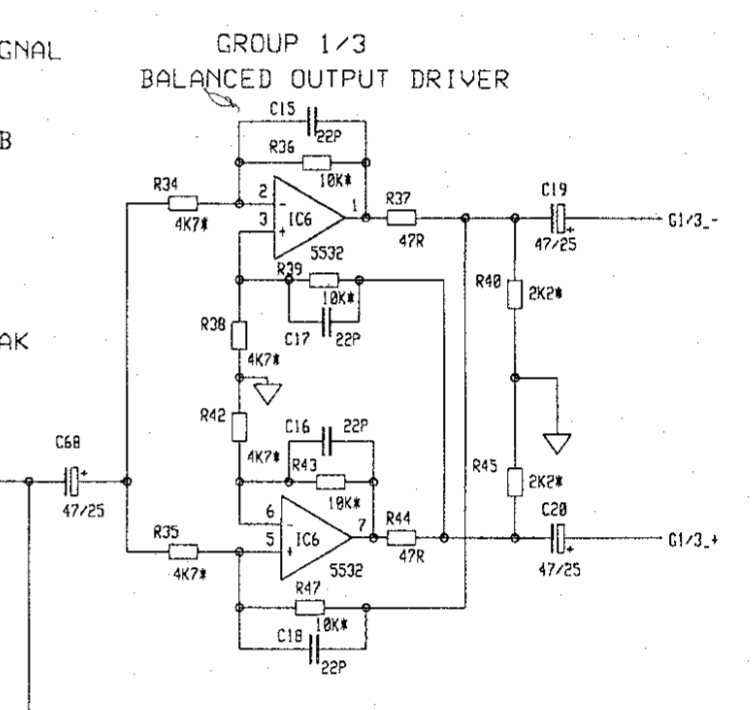

Because of supply issues a few years ago, Allen & Heath stopped using this type of chip for a balanced line driver and use a TL072 instead.
Turnes out cheaper to produce and more reliable. There are many 16pin SMD to DIP convertor boards available.
