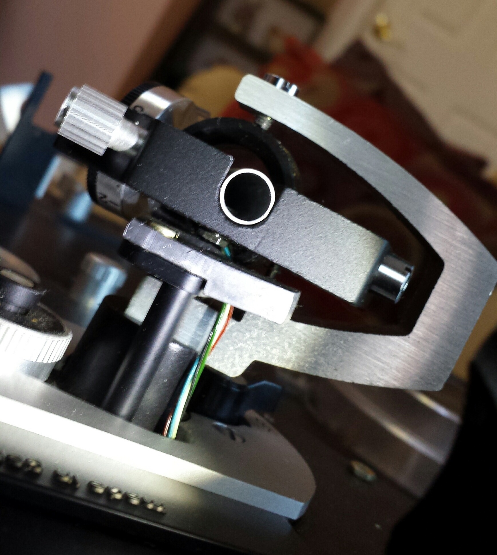

Tonearm
Here is a picture of the back of the tonearm tube. There appears to be a hex headed screw or something attached to the bottom of the tube which acts as a stop, maybe?
The clearance between the bottom face of its head and whatever it stops against is about .030” thus limiting the vertical movement. Is something adjustable here?

Removed the tonearm to gain sufficient access to the suspect screw. Plus, it gave me the opportunity to see how it goes together. Fashioned a 4.5mm open ended wrench and snugged the culprit screw. It is one of two bayonet screws. Cleaned the steurepimpel and mating surface of grease.
Reinstalled, adjusted cueing mechanism and voila, with an AT140LC mounted at 1.5g, this things tracks and sounds wonderful.
All I need now is to figure out why the strobe lamp is not working. I cleaned contacts and reversed the lamp, but still doesn’t light up.
