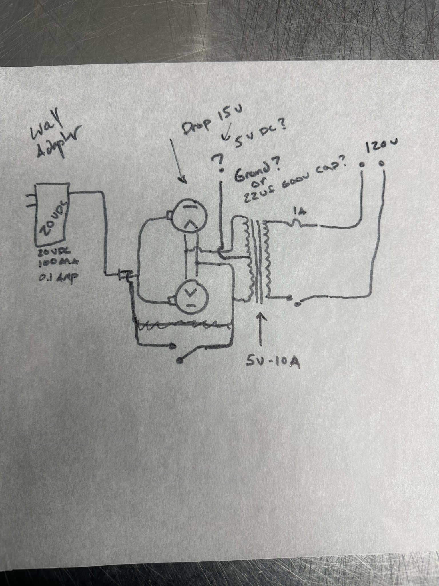

Hi! So first things first, I understand everything about the dangers of these tubes and how to properly heat them and all that other jazz. I also have worked on guitar amplifiers for a few year. So, I’m green but not green green. With that said, I’ve always wanted to build a MV display of sorts, flip switch ohhhh ahhhh kinda thing. I have two NL866a and their filament transformer that came out of a Kepco power supply. I’d like to somehow not use a second transformer for the plates and just stick to the two tubes and the FT. I crudely made a sketch. Laugh away 😂. Am I in the ballpark? Do I need resistors on the leads going to the plates? Again, Just trying to get em to glow for a display. Thank you!
That circuit can't work as-is, but regardless, a line operated, non-isolated circuit is a big no-no.
So bedsides the non-isolated part, care to share what else I’m missing or anything to get me to where I’m looking to go? Thanks ! Will I end up needing another transformer then?That circuit can't work as-is, but regardless, a line operated, non-isolated circuit is a big no-no.
You'll need a 120VAC primary power transformer, with the right secondary voltage and current capability for the HV.

The person I got the set up from was able to get them to ionize by applying 12vdc to the plates using a Eico 20v transformer and two 39 ohm resistors with the negative attached to one side of the filament.

Circuit-wise, it wouldn't work as there's no circuit where the current can flow.
The circuit from the top of the primary you drew isn't closed. Where would the current return to?

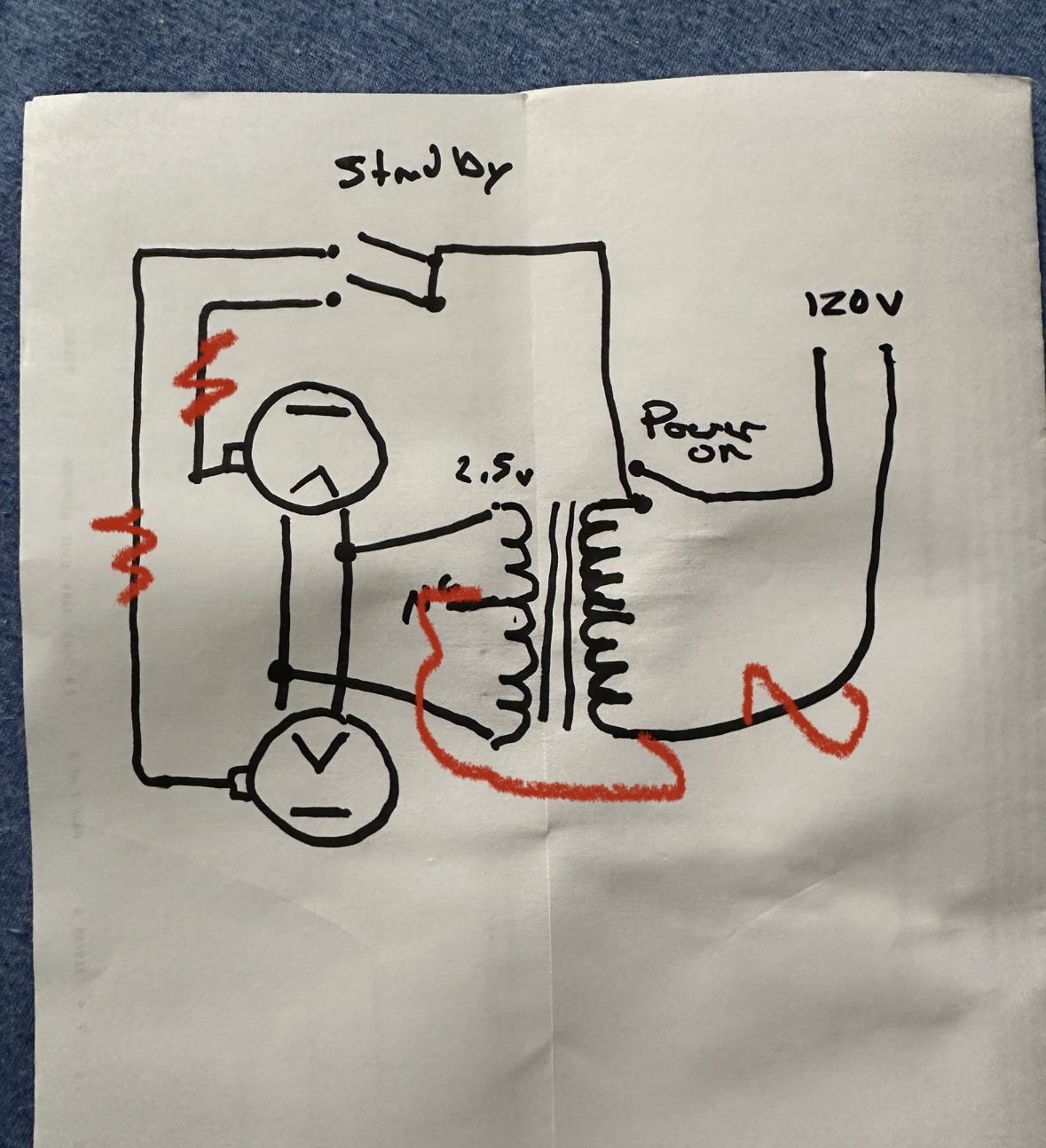

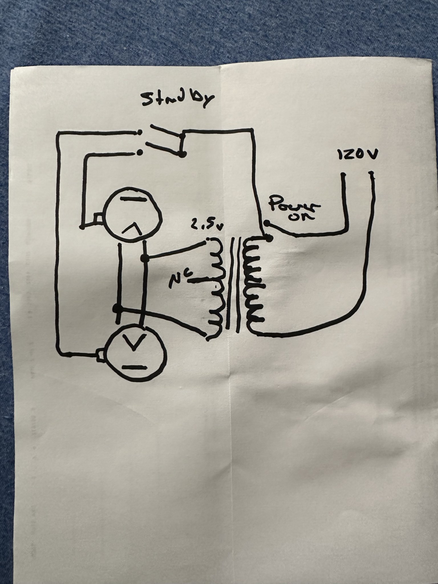

The NC transformer center tap to the lower 120V line wire , the plates each with big series resistor to limit the current to the standby switch . And a fuse for the whole circuit ...

If you want to make them glow, just run DC through them with a current limiting resistor calculated for the rectifier rating. Although some can glow at 12V, I would use 20V. Some MV rectifiers have higher strike voltages than others.

Would this work? I’m still curious what to do with the red/yellow ct wire. On my fender amps is grounded.If you want to make them glow, just run DC through them with a current limiting resistor calculated for the rectifier rating. Although some can glow at 12V, I would use 20V. Some MV rectifiers have higher strike voltages than others.
Like this? Edits in red!The NC transformer center tap to the lower 120V line wire , the plates each with big series resistor to limit the current to the standby switch . And a fuse for the whole circuit ...

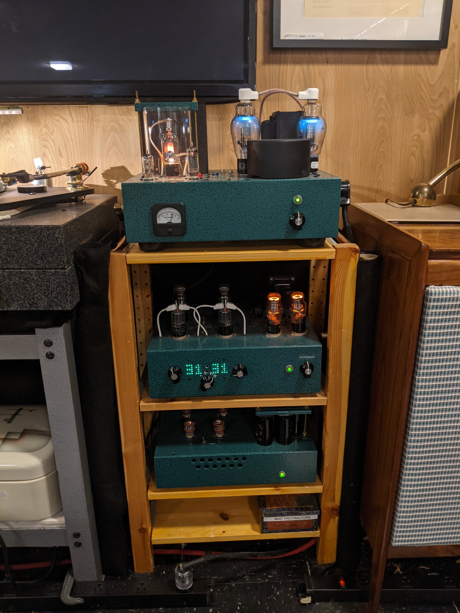

I use a pair on 2 monoblocks mostly for looks but they are functional. IIRC, the size of the glow is directly related to the current draw so unless you are powering something you may be disappointed.
My opinion? Don't mess with them. This is like PCB oil capacitors - it's not just a health hazard. When one of these suckers gets popped, it's a hazmat issue. Even relatively small amounts, when scattered significantly, get very, very expensive to clean up. An 866 might be a few thousand dollars to clean up if it were to break. Something big like an ignitron could be $50,000 or more.
Yep, 666A's glow brighter with a heavier load, nice set up Mr WM.
