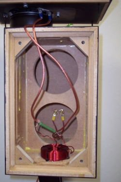

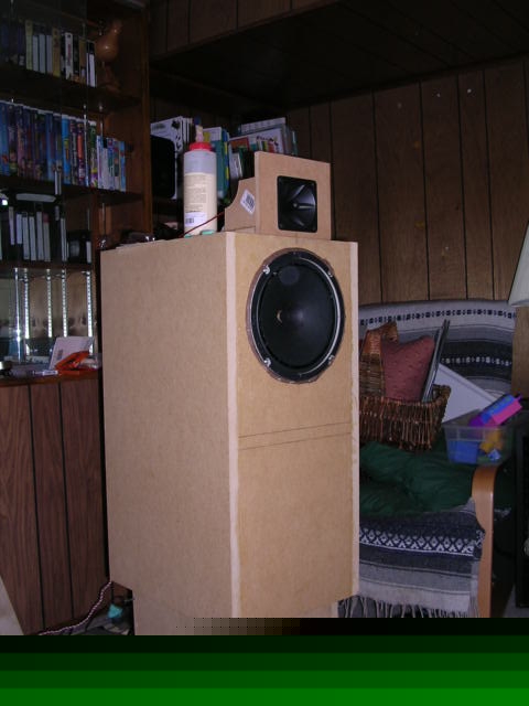

Here's the idea. I built my new Jordan JX92S monitors using the .3ft^3 (.25ft^3 nominal) prefinished boxes from Parts Express. I also bought a pair of ScanSpeak aperiodic vents, which I decided not to use. The boxes have a vertical shelf brace running down the center of the box with two circular cutouts. The hole is just the right size so you could glue the ScanSpeak vent to it using Goop brand goop. You could seal off the other hole.
I don't know what if anything that would gain, and I won't try it unless I can figure out a way to make it temporary, because, well, I can't imagine they could sound any better. But it's an idea I wanted to throw out there.

Interesting idea,
I have often pondered a similar idea..although a bit more complex.
Take a cabinet similar to yours except maybe a MTM w/ 2 6.5 inchers on the front baffle. In the baffle separating the front and rear chambers mount one of the same drivers. Use a high current pot to either:
1.run the coil on the 'inner' woofer variably open <--to--> shorted. (I have no idea if that would do anything.
2. Run the inner speak actively through a pot. Sort of like a 'loose' isobarik with adjustability ??!
I wonder what would happen. could we adjust Q on the fly?? HMMM

The classic dual-chamber aperiodic box
Web page: http://www.t-linespeakers.org/classics/dynaco.html
Also i believe NAIM is doing something similar with some of their speakers.
At higher frequencies the driver mostly sees the little box... as frequencies decrease the driver will start to see the larger box thru the resistive port....

I recall posting something about a kit from Dynaudio called the TWYNN that is an MTM with 17 W-75 drivers each having a separate chamber and an aperiodic vent. The vent dampens the impedance peak and the whole system with a D-28AF tweeter sounded beutifiul to me.
Northcreek does something similar but they fill the normal type vent with straws, or you can simply drill small holes in the cabinet I'm told and achieve the same effect.
