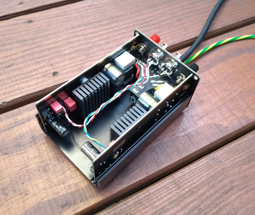

I just modified my dual-TPA3221 amplifier to provide differential inputs, with the input opamps and volume pot bypassed. Photos attached.
It was a pain - the case is small, and it was impossible to fit full-sized XLR connectors to the rear panel, and the rear panel is glass-fibre, not aluminium! I had to use mini-XLR connectors ... then I had to make up miniXLR-to-XLR cables, and also miniXLR-to-RCA cables.
Modifications now complete, I just compared several different configurations:
1) different voltage power supplies: 15V (as supplied), 19V and 24V
1a) adding capacitance to the power supply
2) using differential inputs, versus using single-ended inputs. The TPA3221 is a differential design, but it permits single-ended inputs simply by grounding the negative input pins. Be warned - this feature does not apply to all Texas Instruments amplifier chips - you can't do this with a TPA325x series amplifier.
My source is an ES9018 DAC with transformer output stage, which can be pin-configured for balanced or unbalanced output.
3) with single-ended input, adding a tube pre-amp between the source and amp.
STAGE 1 - Differential input mode, 15V vs 19V vs 24V switch-mode power supply
15V - nice sound, but maybe a little bassy, and some roughness in the treble.
24V - the rough treble is gone, but there's now more mids/highs, and overall a bit bright.
19V - Best. But still a hint of brightness.
STAGE 2 - Single-ended input mode, initially with 19V power supply
Well to my surprise, this just sounded "right". A more subtle, musical sound compared to the slightly bright sound in differential mode.
Then I tried the 15V supply and 24V supply, and while the differences were not as pronounced as they were in differential mode, 19V was still the winner.
STAGE 3 - Single-ended input mode, add capacitance multiplier to the 19V power supply.
The cap multiplier I have is by Allo, and it has an adjustment for voltage-drop, with a maximum drop of approx 12% of the input voltage.
At first listen, I could not hear any difference from the previous test, and I was going to report the cap multiplier as having no benefit.
But then I thought to check the voltage-drop, and I saw it was set to only drop 0.25V. I increased this to a 1.5V drop and listened again.
I should point out that up to this point, the differences I heard were in terms of bass/mid/treble balance, and also overall brightness.
But now - wow. No change in tone or brightness, but an increase in clarity and imaging.
And since the cap multiplier brought such improvement to the 19V supply, I then re-tested with the 15V and 24V supplies - the cap multiplier brought similar improvements to these power supplies, but 19V was still the best ... well actually with the cap multiplier in series, the voltage is now 17.5V.

- Class D
- DUAL MONO TPA3221 Pictures Inside
