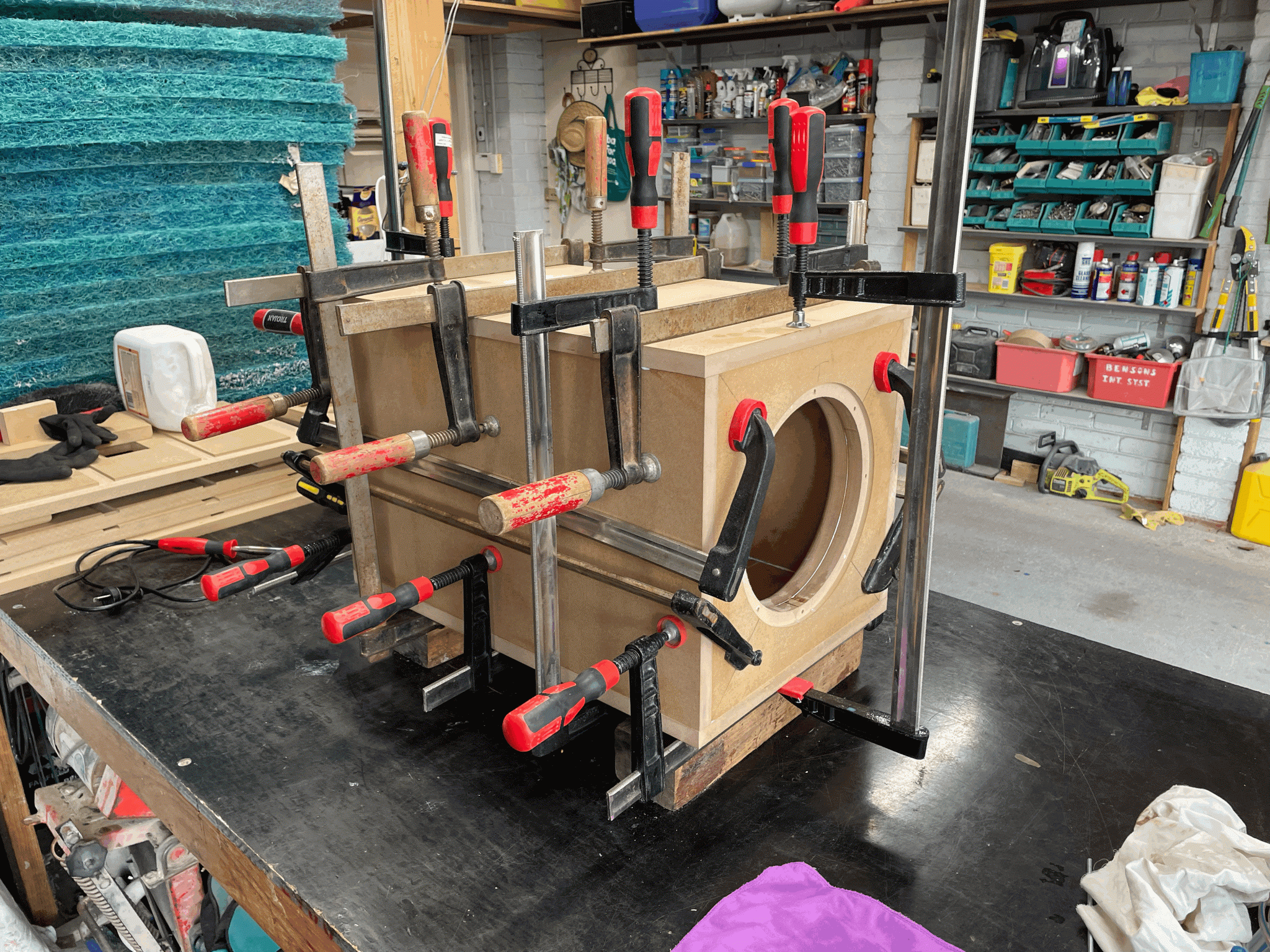

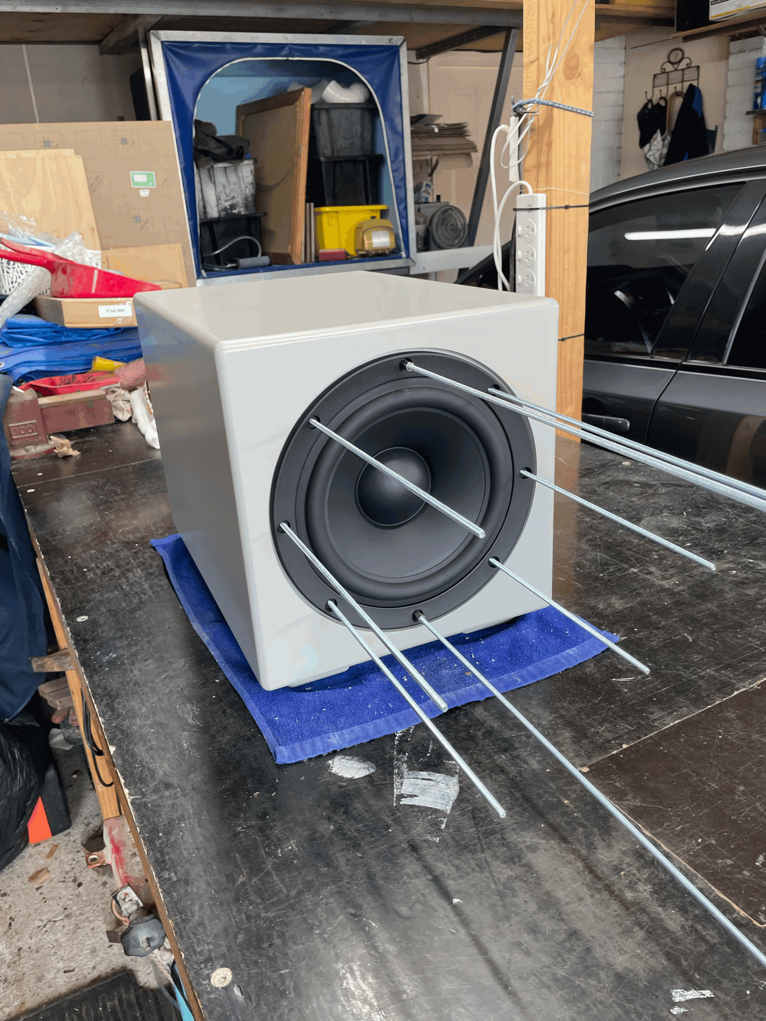

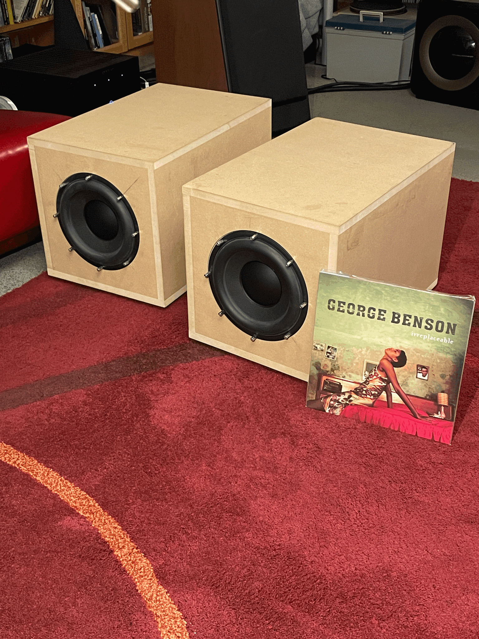

Here are photos of a dual opposed 10" sealed subwoofer I designed for a music recital hall. A pair was used for accompanied vocal performances. The drivers are two 10″ SB Acoustics SB29SWNRX-S75-6 coupled with 5mm threaded rod. The enclosure is 25mm (1") mdf with double thickness baffle, interior volume approx 60 L. Used with a Behringer iNuke Class D power amp. After testing with high level 17 Hz tones, the set up crew reported feelings of nausea on the following day, so I guess they did the job ok. Opposed reaction works great, no discernible box vibration at high level.Using 1" thick walls and bracing, that yields a 1.5ft^3 box. I think a pair of UM10-22 (18ltrs sealed) would work here, and they are okay being boosted.
