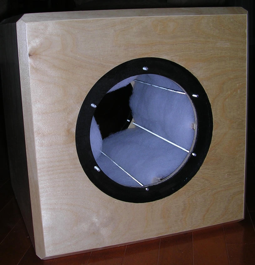

OK for my tiny sub project I am trialing 2 8 inch opposing SB Acoustics subs
8″ SB23MFCL45-4 / Polypropylene - Sbacoustics
They are beautiful drivers.
I am trialing this method of coupling with 4mm threaded rod, 4 mm bolts and hex rod coupler (coupling nut). See pic. Yes I know they are too close - mybad did not measure depth. I might need to increase box size a little.
I tightened it so much the MDF started to bow in the middle.
At the very least I think it needs some sort of extra support, even just a bit of pine in the middle where it bows.
But the main problem is that it needs top and bottom off to be able to install the rods. This is almost impossible to do when you consider finishing (I was going to wood veneer).
Is all this really worth it? Are just normal wood screws really that bad?
It is such a small box I would think the drivers are pretty well coupled anyway.

That's an unusually small enclosure for what I normally build, so I typically have a fair bit of bracing as well, but you don't need to get out the long torque wrench and max it out either.

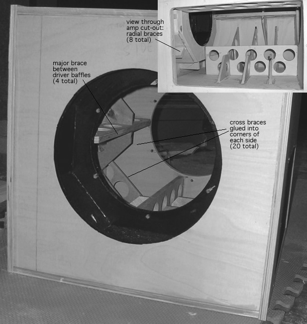

MDF does not have great screw retention, using machine screws and "Hurricane" or "T" nuts are a good idea for supporting heavy drivers and maintaining even screw tension.I tightened it so much the MDF started to bow in the middle.
Metal rods don't serve any useful purpose with such small baffles, and may "ring". With larger baffles, plywood or wood bracing works better, and does not require removal of a side to install the drivers.

What I did was install some additional cross-bracing and then the rods will not be able to bow the box at all. I added some stuffing into the box after installing the rods. I hope the photos explain it.
I also used 8” drivers, which provide plenty of ooomph for my home theatre and have been in use for a decade.

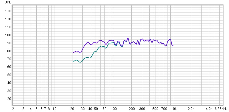

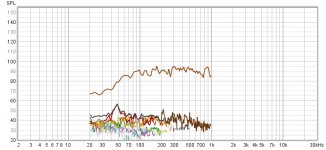

Here are some results.
Currently pissy little 50W amp x2
The gain needed is about 20 dB and I was expecting 10dB so more than I thought. I was working off a 14.4L box volume.
The distortion is also weird. What is that at 50Hz? This is unboosted distortion too.
I am wondering if it needs a bit more cabinet depth to give the rear of the drivers some room. Even 1cm or so. Modelling does not show volume improves performance much until you have more than double the volume which is not going to happen.
It sounds pretty good - better than one of my other commercial subs (not the B&W which is the gold standard).
I am waiting for my new amps to arrive which should improve things a lot. Volume is still a bit limited due to all the EQ and small amp.
PS. It passes the beer on the sub test easily. I cannot see any disturbance at all so the opposing drivers plus bracing is working.

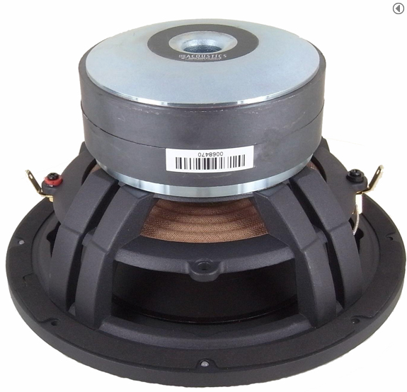

too close? Magnets touching would give best coupling.

Dave,too close? Magnets touching would give best coupling.
The SB23MFCL45-4 has a vented back plate, magnets touching would reduce voice coil cooling and affect compliance.
I’m not a big fan of polepiece vents, but that means some sort of vented spacer to allow them to breath.

I have PhD in electronic engineering and specialise in DSP FWIW. I design by science. Probably better qualified for this build than anyone bagging me.
It is not a matter of ego - just trying to see what is possible with modern drivers, amps and DSP. Tech improves with time people ...
Anyway, it has taken me a little while to sort all these combinations out given RL commitments.
8 litres was indeed too little when using two drivers. I settled on 14 litres and 20 litres depending on drivers.
8 litres would be OK for 1 driver at lower listening levels than I used for some of the drivers but then you lose the vibration cancelling effect.
I settled on the JAB5 power amp with their recommended 36V LRS-350-36 power supply. 24VDC supplies are insufficient even with 4 ohm speakers to compensate for the necessary boost as they clip at moderate volumes with much bass input. This is a great amplifier.
Anyway, the following drivers were tested from approximate worst to best...

I kept the 4mm steel rods as ringing did not seem to be an issue but appreciate the comments about this. Plucking them showed quite a high resonance well outside the bass region and was inaudible in practice with music.
Additional bracing (pine) was also used to prevent warping of the panels when the rods were tightened.

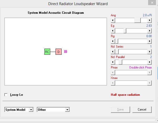

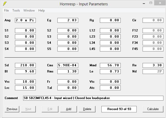

WINISD Pro Alpha was used which also enables checking design parameters of the drivers are not exceeded. I am keeping the last two subs for myself ...
