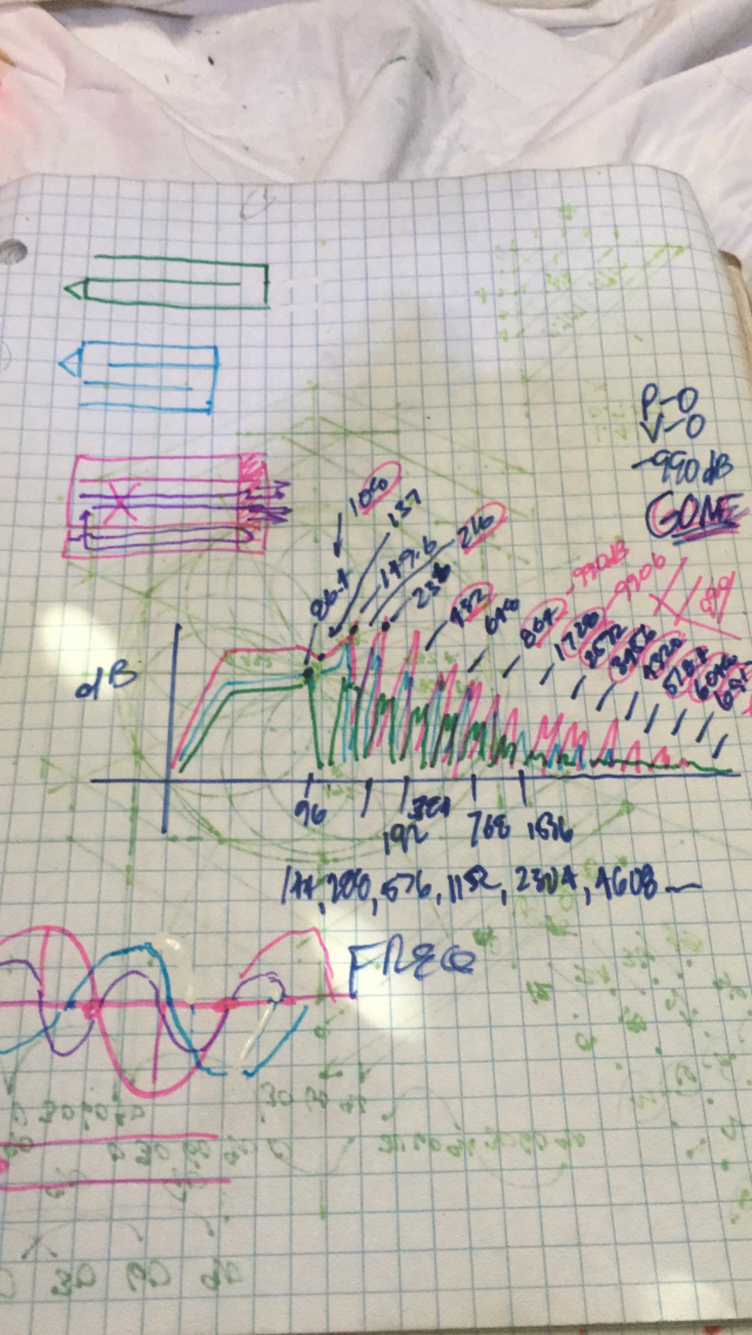

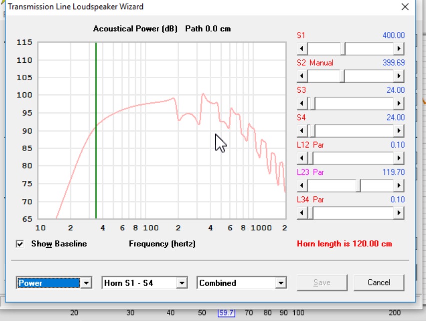

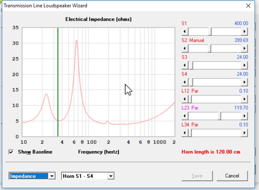

my best suggestion to sim two sub tline
open two instances of horn resp
add same driver value
but on on end of tube and on other instance having it OD on somewhere on tube
and see raw response on both(don't add dampening like rock wool)
if you see one driver dipping at 200Hz and one peaking at 200Hz(i know, you got it) , technically. getting decombing effect
you can effectively put on more subwoofer inside Tline and also fix Tline cons like tube resonance (natural science phenomenon, blow in tube and you get multiple of harmonics peaking)
I will sim one once i have some money to buy good old Dayton ultimax 10 x 4
i want isobaric x 2 (series parallel) in Tline and want to see what happens when we have quad high excursion subwoofer, how low can we go

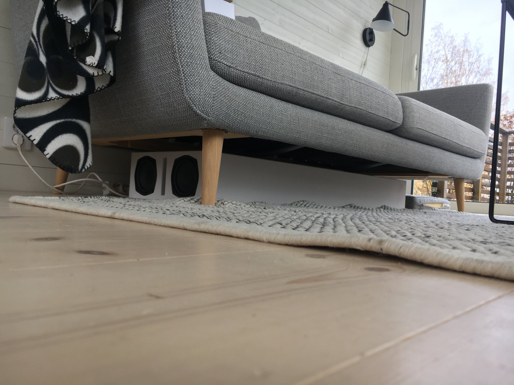

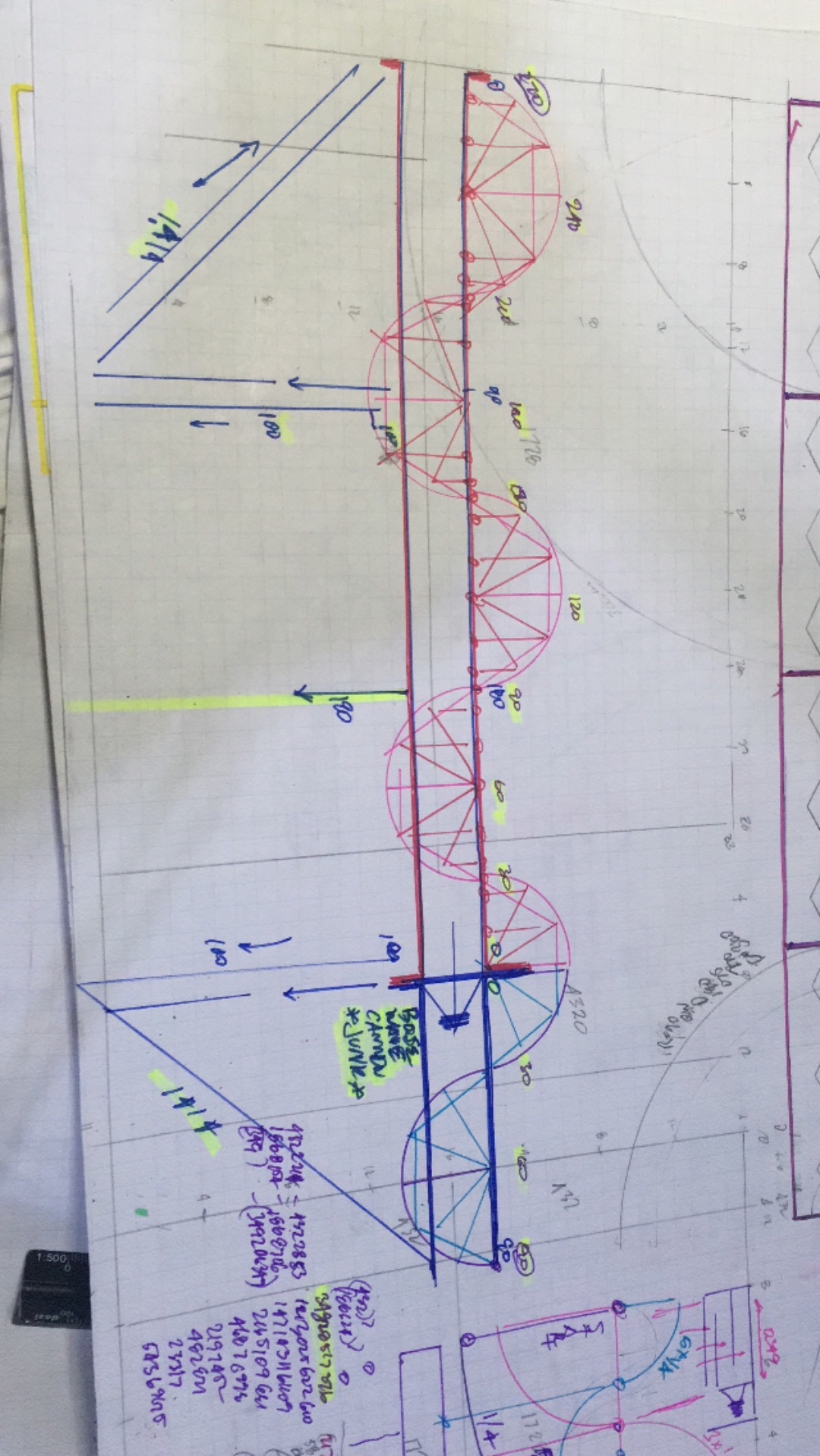

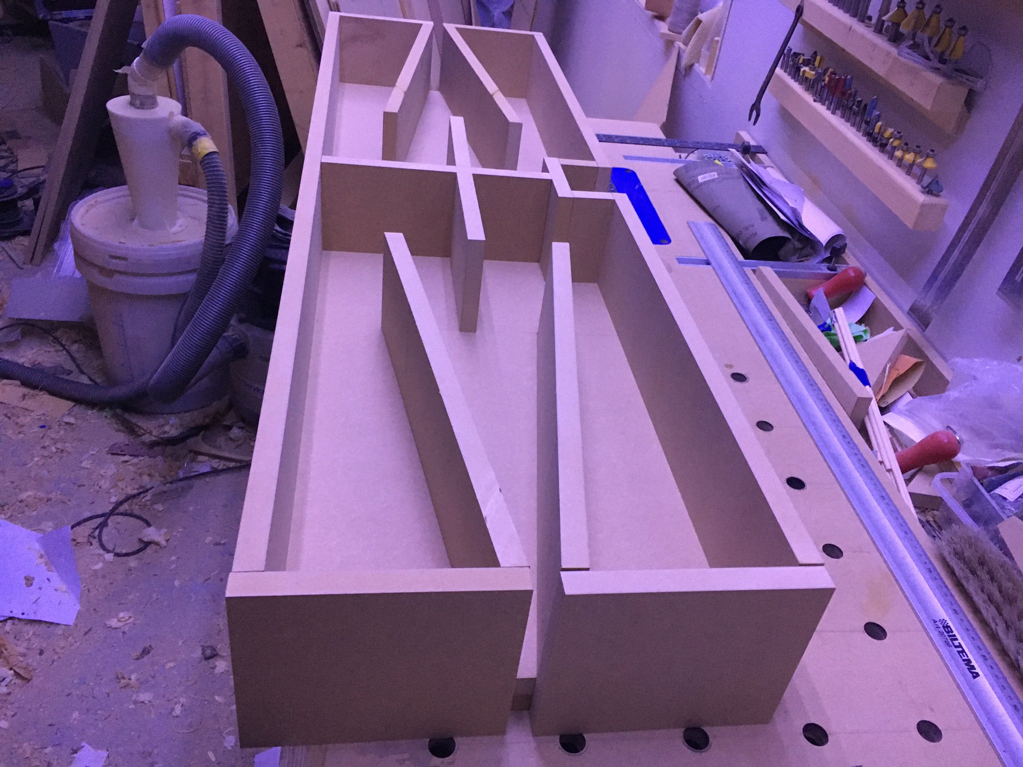

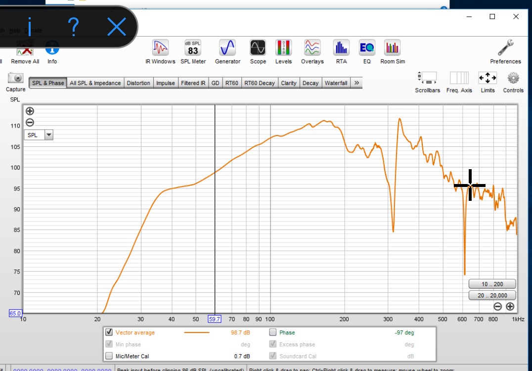

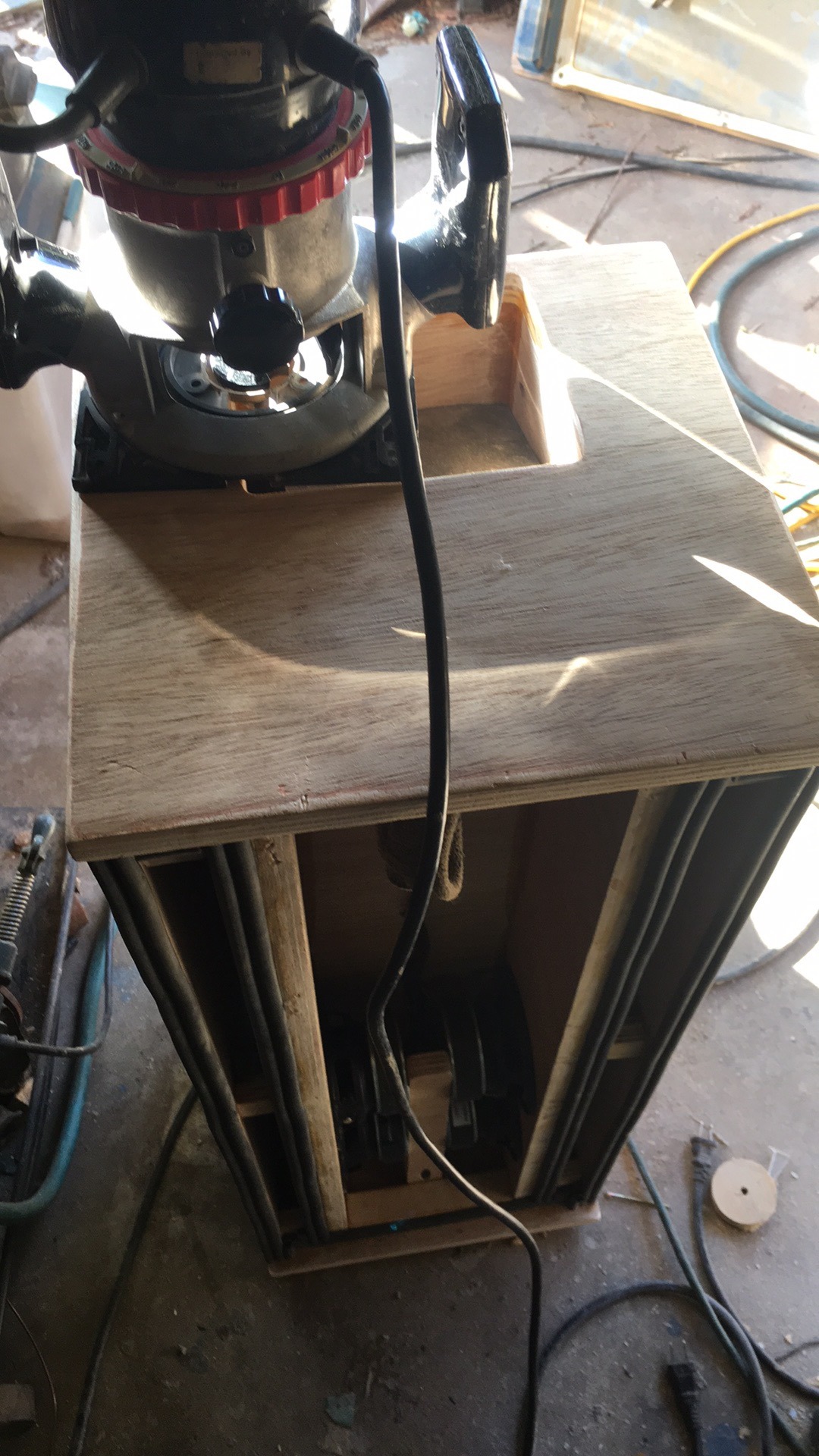

works good it just sucks that you have to have such a small cross-sectional area for your ‘port’… (tl path) You end up with alotta wind speed. Really wish there were more ways to get around it because it’s kind of fun. During Covid I got so cabin fever, I built this enclosure out of scrap wood and OSB shelving i stole from the shed🤪🤷🏻 Goofy but I didn’t care at least I was keeping busy… like you said it ends up having a lot of low end grunt as compared to the SD or two SD versions. You got MMS and motor force and you gave up SD.. I ignore all of that and consider it a brand new set of TS parameters to work with…
Things like the B@se wave cannon Can be made much better if they just pulled it up and stuck together Siamesed with respect to the odd harmonic intervalsThis needed only to use an offset on both sides to start at 30 cm if the total is 360cm . Then it goes from junk to smooth
Perfectly doable.

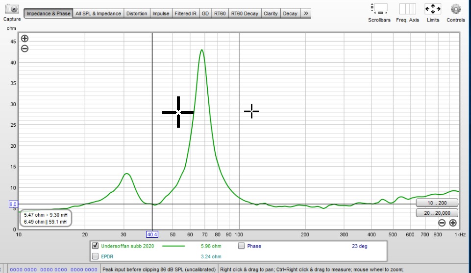

sim in hornresp and build of this “undersofasub” correlated perfectly.
