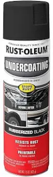

Neither per se, though having some experience spraying Duratex am comfortable recommending the brand, but I imagine a blend designed for rollers better suits the casual DIYer.

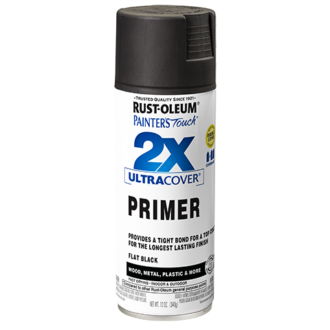

Panels can just be painted flat black for coverage.

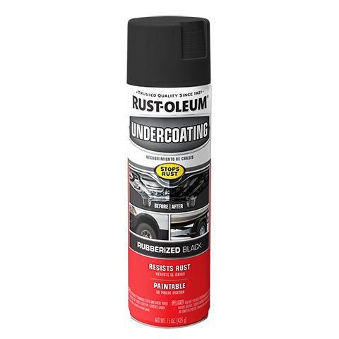

Then for durable finished texture look coating you just use everyday rubberized undercoat.
To get a fine even finish much smoother than roll on bed liner. The glorified Duratex product.
You just spray the rubberized undercoat with a sprayer or like many use it in a spray can.
You mist the surface evenly from a distance to get the light texture.

"Panels can just be painted flat black for coverage.
Then for durable finished texture look coating you just use everyday rubberized undercoat."
I don't know any painting/finishing lingo.
Are you saying just use any old paint for the first coat, and then use that Rustoleum as the second coat?
And the rubberized undercoat paint, it won't have the same durability as Duratex, will it?

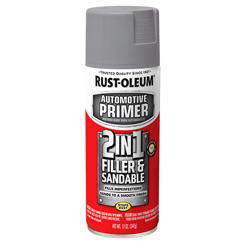

What is a "final finish"? Which flat black works well under the VHT Wrinkle Plus you recommended for good adhesion?
I use rust oleum products and familiar with the datasheets.
You can use filler primer or 2X primers for the rubber under coat.
Since they are all alkyd or modified alkyd
" VHT wrinkle plus" is a heat cured paint and I dont use for speakers.
It requires heat for final cure around 93c and to wrinkle fully.
I use rustolem rubber undercoat as shown for a smoother texture.
