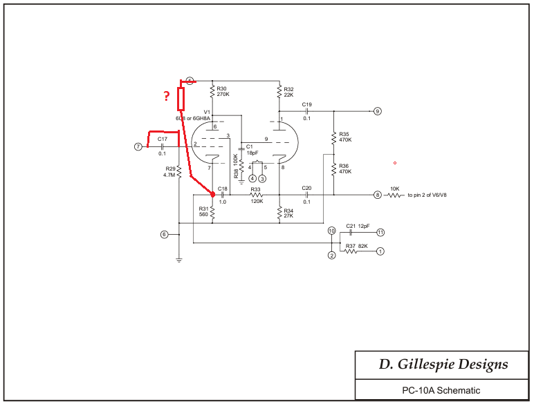

From the original schematic, the voltage at the plate of the 7199 pentode is marked only 55v. Is it too low? I thought it should be 100v or so for healthy operation.
The D. Gillespie Designs PC-10A is a very good base line to start with. The 4.7M input resistor may still cause issue for non-7199 tubes. I would short the input capacitor C17 shown as below. The thing in front of C17 is just a balance pot, which has lower impedance to the ground. It provides more reliable bias for the 7199 or the substitute tubes. Leave the 4.7M there in case the pot open circuit occasionally. Also, an extra cap before the tone stack maybe necessary to block any possible DC offset.
An extra resistor may be needed, shown as below. Without the resistor, the plate voltage of the pentode may be too low. The extra resistor could be anywhere 330K to 3.3M. I would aim the plate voltage around 90v ~ 100v. Thus the triode section has enough head room.

As said in OP, the SCA-35 is very picky about 7199 tubes. If the wrong 7199 is used, from time to time, the sound would be cut out and producing rustling noise. I was thinking there must be something wrong with the tubes, but these 7199s work perfectly fine on my Dynaco ST70. If you compare SCA35 with ST70, the 4.7M Ohm bias resistor just looks suspicious. Not mentioning swap out the 7199 for something like 6BL8 or 6GH8. They all have different bias in the circuit.I looked but did not see what your objection is.
The Dave’s PC-10A mod is not hard to implement with the original board. Basicly, it just adds a RC network to the plate of the pentode section comparing to the original one. I believe I tried at some point. They didn’t resolve the bias point issue.

I suspect the old carbon composite resistors are failing. I did replace all the resistors on the power amp boards, except the 4.7M resistors, because I didn’t have this valve in hand. Although they measure fine when cold, they may open circuit when hot. That might explain why it ran more stable after I shorted the input coupling capacitor C17.
What undesirable behavior did you experience before bypassing C17? Why do you not suspect C17 as the source of the problem? Have you actually checked C17?That might explain why it ran more stable after I shorted the input coupling capacitor C17.
I don’t see why the 4.7 M resistor would cause a problem, even if it drifted some, unless it is so high that it can’t function as a grid leak. C17 and R29 form a high pass filter, and changing the component values will change the cutoff point, but not affect the proper behavior, as long as the component are intact.
I would simply get Dave’s boards (including the EFB/power supply that really makes a difference) and be done with it, but I understand you have a vested interest in salvaging the originals that you have already partially repopulated. Good luck.
It was not stable occasionally when hot. When it happens, the sound will be cut out and producing white noise. I suspect it is the bias issue caused by the circuit design or failing component. I also added 300K resistor shown in the post #4. The plate voltage of the pentode is too low without it. Also I added the RC network as Dave’s board in front of the phase splitter. I figured it would help to stabilize the positive feedback at high frequency.What undesirable behavior did you experience before bypassing C17?
With these symptoms i'd start with replacing the 4.7M resistor with a metalfilm ( and nullifying other changes)
Wait! You have actually installed that resistor between the HV supply and the cathode of the 7199 pentode? How much did it change the bias and performance characteristics? How much is your screen voltage now compared to the specified 32 volts. Why do you think that is too low?
The RCA datasheet has a “characteristic class A working point” with a screen voltage of 50 V. I am sure David Hafler and the Dynaco carefully evaluated their operating point and chose one that worked best. Don’t forget that a change in screen voltage dramatically changes the pentode parameters, and with direct coupling between the pentode and triode sections it could upset the whole operation.
Unless you are true expert I suggest that you undo all the “unauthorised improvements” and rebuild your PC-10 exactly as designed with good parts. The SCA-35 is a masterpiece of compromise and optimization, that worked very well in thousands of builds and one can not make changes without a good understanding of how it works in synergy.
Right now, I am using 6BL8 with the mod mentioned in the post #16. Here are the voltages.Wait! You have actually installed that resistor between the HV supply and the cathode of the 7199 pentode? How much did it change the bias and performance characteristics? How much is your screen voltage now compared to the specified 32 volts. Why do you think that is too low?

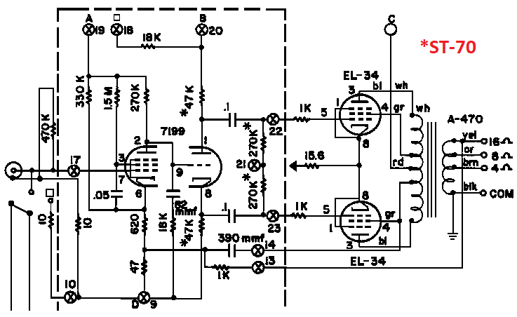

I didn't come up the mod from the thin air. I happen to have Dynaco ST-70, too. It doesn't suffer the issue that the SCA-35 has even with the same tubes. If you look at the schematic of ST-70 below, besides biasing through the cathode resistor, it also has 330K from the supply voltage to the cathode. It allows to use a lower value cathode resistor to keep voltage gain high. My idea is simple, migrate the bias scheme from ST-70 to SCA-35. Personally, I would avoid the Grid Leak bias with 4.7M. You don't really know how much leak current coming out of a tube. It could be anywhere. That's why I want to bypass C17 in SCA-35.
PS:
Also, ST-70 has the RC network in front of the phase spilter just as the Dave's design. I don't really agree with that the network is necessary for ST-70. However, I believe it is required for SCA-35 to get stable with wide range of tubes other than 7199, due to the existence of the possitive feedback.
