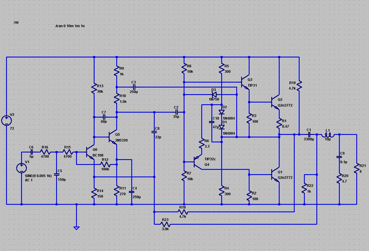

Dynaco Stereo 120 Simulation Model in LTSpice
To establish a baseline, here is a simulation model for the Dynaco Stereo 120 amplifier channel. Play with it some...put in some small signals, 10 mV or so...look at the output spectrum...lots of harmonics, and not too far down...classic symptoms of not enough current in the output stage...look at the output stage currents...output transistors really aren't even conducting.
If you change one of the diodes (say D1) to a 1N5817, (a quick way to model a slight change to the output stage bias) see how much worse the distortion gets.
In an upcoming post, I'll add the bias controller, and show its effect.
The included files are:
2. dynaco stereo 120 stock with TIP Mod.txt - change the .txt to .asc and you can run it as a simulation file.
3. standard.bjt.txt - rename it to standard.bjt. After you have backed up your existing LTSPice standard.bjt file to another name, you can copy this new one in its place. It has all the models you'll need.

Would your bias scheme work on, say, a Naim NAP140-type circuit?
Like the Dyna, the Naim is quasi-comp with NPN outputs, but it uses a dual-rail supply and requires no output cap.

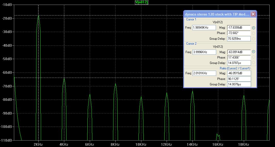

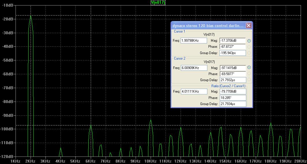

Performance Under Bias Control
Here are two simulations of the amp: both are at 10 mV rms input at 2 kHz.
The first is stock, the second is bias control...harmonics drop from 46 dB below the fundamental to nearly 80 dB below the fundamental...actual measured performance is even better than the simulation!

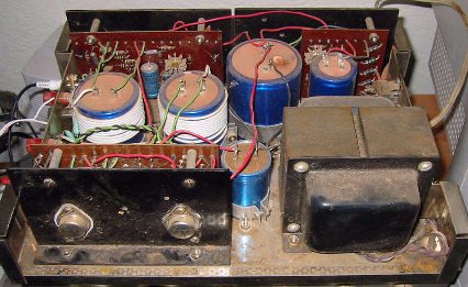

Question, Is this the amplifier that had the output inductor wrapped around the electrolytic capacitor? I think I built about 3 of these...
Thanks for the memories....
Yes it is...
Yes it is...the output inductors wound 'round the big blocking caps...The sight of a dirty old dynaco makes me smile...

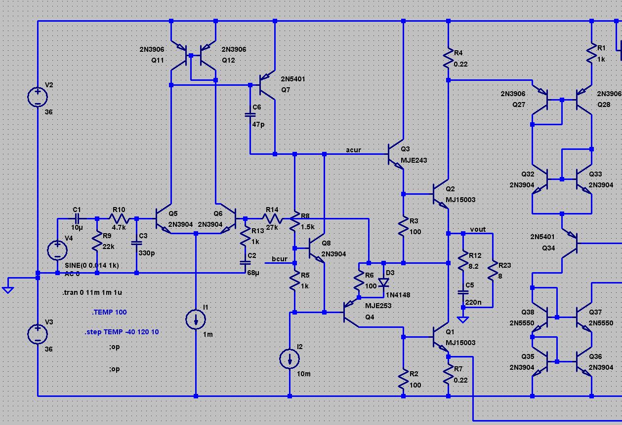

Bias Controller for a Standard Quasi Comp Amp
This is for Mr. dB...it's kind of different than the bias controller I've worked out for the stereo 120...in some ways, it's better...but it's so much more complex that no one in 1966 would have dreamed of doing this...Actually, it's based on a design by Evert Seevinck, just adapted a bit to fit on a standard quasi-comp amp. It could also go on a full comp amp. I have only done a basic tune-up, no extended tweaking, but its performance is quite good.
Eventually, I'll post the circuit for the Dynaco bias controller, but for now, this is kind of interesting...
There are two jpg's...the first shows the basic power amplifier. The second shows the bias controller...lots of transistors! but it works pretty well...it lets you set and maintain a pretty high bias current, which can do nice things for linearity...by servoing the bias, thermal runaway is eliminated...
(apologies...you might have to stare a bit to see how the two connect together)
If anyone's interested, I can post more info later...

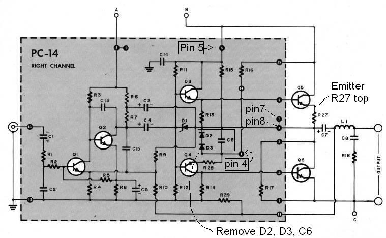

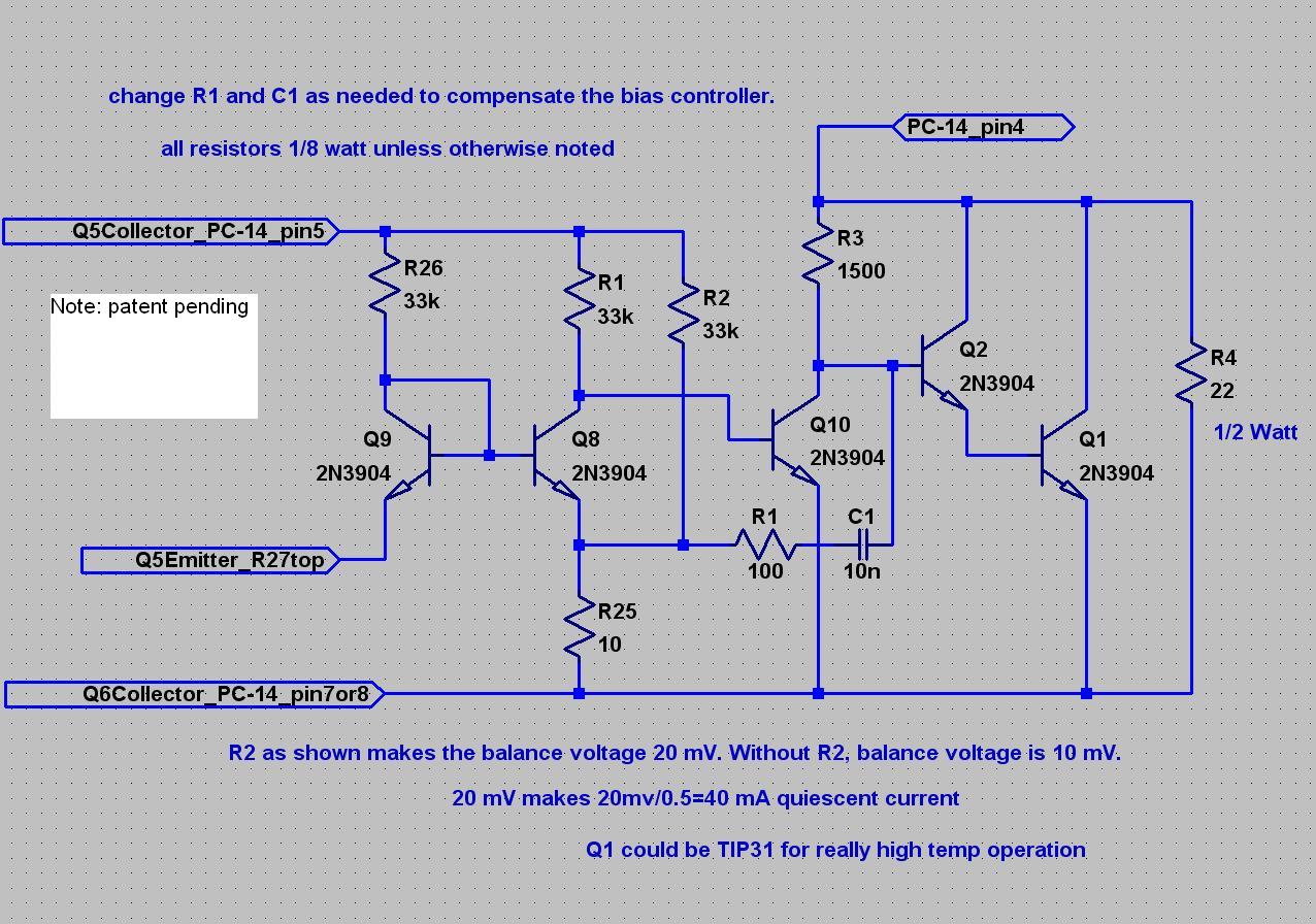

Simple Bias Controller for Dynaco Stereo 120
In contrast to the previous post, I wanted to work out a bias controller that was simple enough to be conceivable in 1966. It may not have all the benefits of the previous post, but then it's a whole lot simpler. Please be advised that there is a patent pending on the circuit*.
You can build the bias controller on a small PCB, or bit of perf board. Q8 and Q9 should ideally be a matched pair. Q1, Q2, and Q10 don't need any matching.
Really short directions.
1. power down the amp.
2. remove D2, D3, and C6 from a PC14 board.
3. connect up the four interconnect wires as shown. Three are available at the edge of the board. Q5 Emitter _R27 top is available on the resistor as indicated.
4. Power up the amp. If you carefully measure the voltage across R27 with no signal, it should be pretty close to 20 mV. This represents about 40 mA of quiescent current.
Listen, measure, and enjoy.

- Dynaco Stereo 120...can be beautiful
