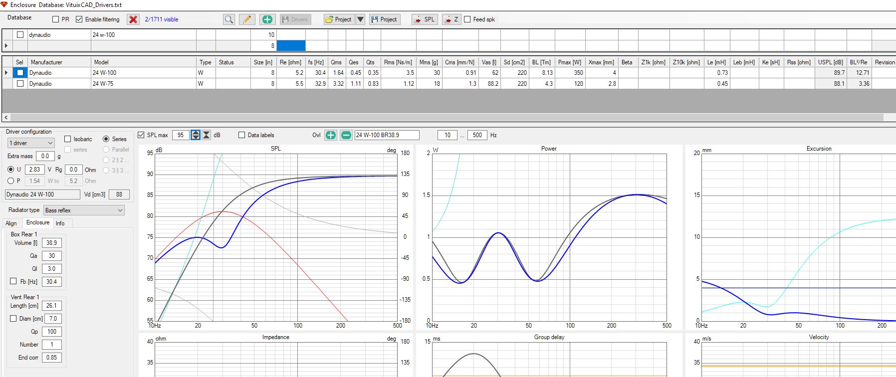

This one's actually in vituixcad's enclosure database -- but it models a ported SBB4 alignment of 38L for 47hz...where the BM15 specs say 43hz F3 from 28L. When I squish the volume down to 28L in vcad, it gives F3 = 49hz.
I'd think that you wouldn't want to go over 38L if you want to try increasing the box volume, and you can play with vcad to look at changing the port accordingly.
The port it gives for 38L + 47hz F3 = 15cm long, 7cm diameter.
P.S. increasing beyond 38L in vcad doesn't lower the F3, and this driver doesn't work in a sealed box, neither (18.5L gives 62hz with qts of 0.7).

thankyou . the driver is the 24w100 so I'll have a look at vituixcad it's not something I'm familiar with . I don't have the ability to measure the parameters at the moment so I'll start with that programme and see what happens . I would prefer a sealed enclosure even if I had to boost the low end a bit with eq . the new room has wooden suspended floors and seems to have a lot more low end gain than my larger concrete floored previous room
I'm trying to understand this programme its very interesting when I've got the hang of it be very useful thankyou . I think sometimes the specs manufactures give are inaccurate assuming the customer doesn't know how to check this stuff out . it's annoying only having a miniature window of the drivers in the database and I can't figure out how to make it bigger ?Do you have measurement gear for obtaining the Thiele Small parameters of the woofer? Once obtained, you could then model this stuff.

there's a VERY thin window bar / line across the bottom of the pane - you have to hold down left mouse button and drag it up or down to resize it -- yes, quite fiddlyI'm trying to understand this programme its very interesting when I've got the hang of it be very useful thankyou . I think sometimes the specs manufactures give are inaccurate assuming the customer doesn't know how to check this stuff out . it's annoying only having a miniature window of the drivers in the database and I can't figure out how to make it bigger ?
what you really want is the T/S parameters which you can also put into WinISD if you like
