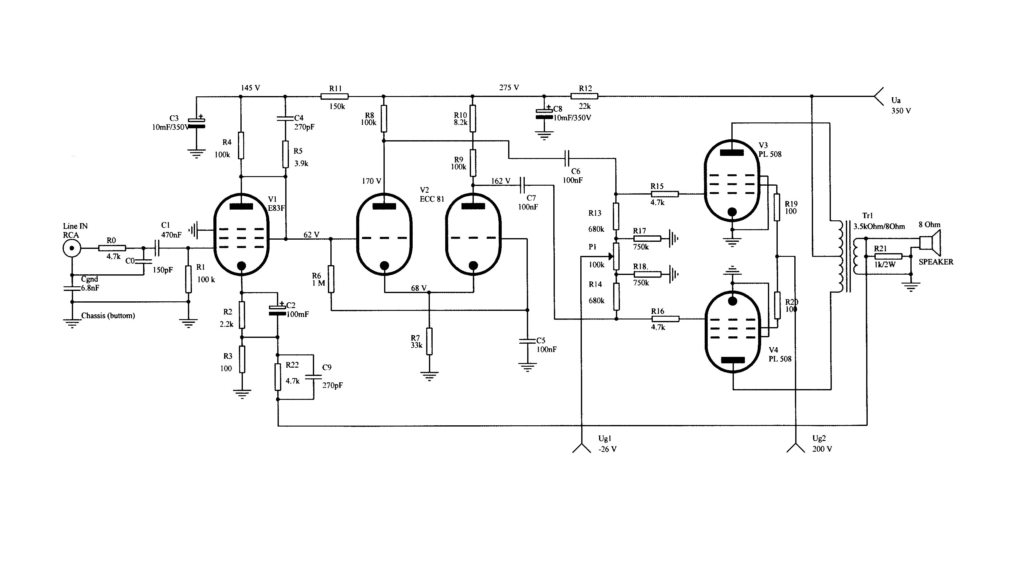

Hi, I am planning to build a PP amplifier with a global negative feedback. This is a general question: which tube would give the most musical sound?
Gain: let's say 20 dB
Required swing: let's say 15Vpp
Topology (driver stage): LTP ECC88 with 33k anode resistors
Output tubes: does it matter for the sound of the input tube? (BTW 807)
I lean towards the EF83 but waitig for experienced opinions.

The EF83 is a variable gain (mu) pentode, usually use in constant level applications.
I'm not sure, that using as VAS stage it's the best choice.

In your case (20dB gain, 7.5V peek) IMO none of them the perfect choice.
Try lower mu triodes.

Attention! E83F is not the EF83's SQ version! And it isn't a remote control tube either.

The E83F is not the special quality version of the EF83. They differ quit a bit from eachother. I don't think the E83F is a vari-mu tube.
Post version of the E83F is 18042 i think, 18V heater if memory serves me right.
I am considering the option of triode connecting the input tube. The E180F datasheet gives parameters for triode connection, but the E83F does not.
Sample schematic attached.

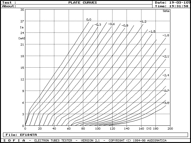

Addition: According to the attached page from VTV magazine no. 11 from 1999 the E180F is a frame grid tube.

Agreed. In my preamp I prefer below tubes in sequence (all wired as triode):E186F sounds better than E180F (I have compared them in multiple applications).
1. E810F - hands down one of the best high bandwidth tube with ultra high Gm. Rich and full of dynamic punch but not fatigue.
2. E186F - on par with E280F in most cases. A bit more smooth than E280F.
3. E280F - balanced and great sound overall but not as that open as E810F.
4. E180F - high dynamic but sounds flat and just OK. A little bit thin on treble and lack of deep bass punch like above other pentodes.
