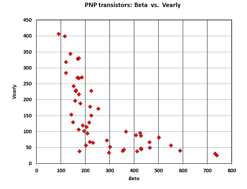

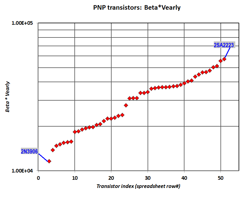

I got interested in Early voltage a while back, and published some, not all, of my measurements in this thread:
Measuring the Early voltage "VA" of some PNPs at 8mA
Lots of people made the same bold assertion in follow up postings: (Beta times EarlyVoltage) is a constant!! They are inversely proportional!! It's all directly related to VceMax. Duh!!
So I created a scatterplot of my measured data. See below. I only measured one transistor of each part#; if that's not what you were hoping for, I am sorry.
For the transistors that I measured, Vearly varied over about a 12-to-1 range, while (Beta*Vearly) "only" varied over a 6-to-1 range. Which is not a very good approximation of a constant, in my opinion.

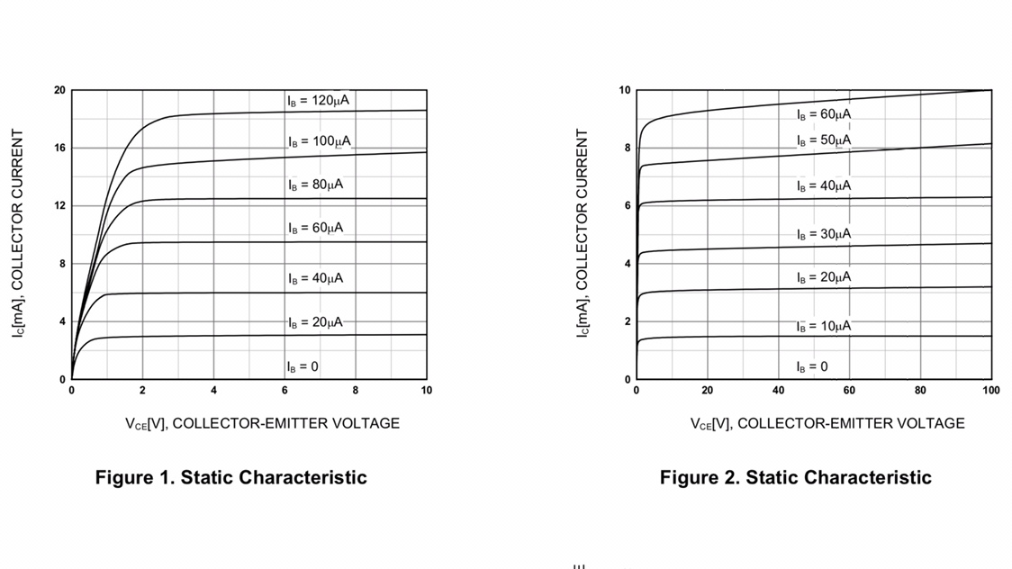

Low-early:
![IMG_1281.jpg IMG_1281.jpg](https://www.diyaudio.com/community/data/attachments/692/692503-4bf95a795862da9fd7fd980711fd3f96.jpg)
Moderate to high Early:
![IMG_1282.jpg IMG_1282.jpg](https://www.diyaudio.com/community/data/attachments/692/692509-ae69283a0edfaed76222257f761c993e.jpg)

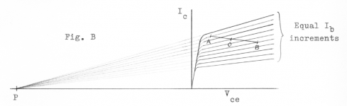

Yes, and your graphs can even be used easily to obtain the early voltage. Just extend a Vce/Ic line to the left and see where it crosses the neg voltage axis. That's your early voltage.
(The graph is from Peter Baxandall in Linear Audio | your tech audio resource and illustrates the early voltage distortion effect)
