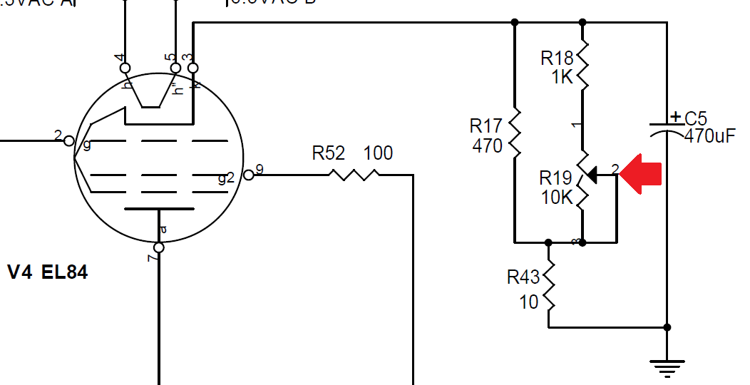

The general consensus is that toroidal OPTs are less tolerant of DC imbalance than standard EI OPTs. I made a clever little mod to my Tubelab SPP (stole the idea from the no longer available DIY Tube EL84) where trim pots are wired into the cathode circuit of each EL84. This enables perfect DC balance between pairs of tubes. It also allows rebalancing as tubes age.

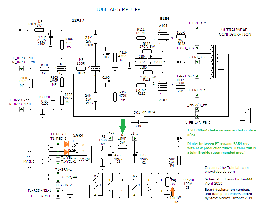

I've changed this circuit a bit, see attached. I replaced R1 with a choke to kill the last bit of PS noise. Doing so made this a very quiet amp. So quiet it could be used with high efficiency speakers.
I changed the value of R3. 10K is from a later version of the parts list.
S.
S.
Hi Steve,
Thanks for the updates.
For the orange diodes: 1N4008?
What is the value of the C101 capacitor in parallel with 5K1 (in the feedback loop?)

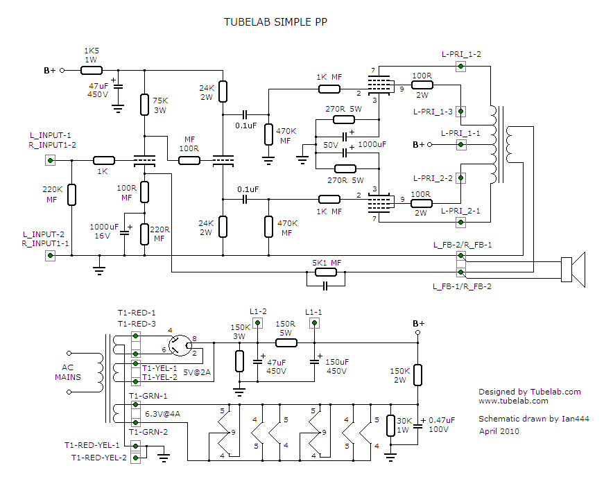

Steve,
Many thanks for your SPP schematic post. I am currently building an EL86 version of the Tubelabs SPP, and working with the “blank schematic”, as in post #14, is a pain - I did not know you had added the part designations. Thank you!

I use HER108 diodes, they are less noisy than the 1N400- series. 1N4007 or 8 should work fine though.
Have a look at this P. T. from primary windings, the 6.3v 2A winding is tapped at 5 volts so this would work for the GZ34. The GZ34 only needs 1.9 amps for its filament. https://primarywindings.com/product/mains-transformer-mullard-5-10-stereo/
C101 will depend on the output transformer. A square wave generator and a 'scope is needed to determine which value is best. I haven't used this out yet on my Hammond-equipped SPP . Guess I should stop being lazy and just do it.
S.

Jacques, That is what Tubelab tells you, but in my experience that gives you B+ a bit on the high side. Yes, you could always make that transformer work (by fiddling with smaller input cap, and/or series resistors).I have some trouble locating a suitable 230V power transformer: from what I read secondaries should be something like this: 300-0-300@200mA, 6.3V@5A, 5V@3A ?
Steve, did you use a 300-0-300 transformer?

See attached bias mod. If you'll be using Toroidal OPTs you might want to implement this for DC balance. Four needed, one for each EL84. Measure voltage across the 10 ohm resistor and set trim pot for desired current flow. I typically use 0.35 volts which = 35mA.
S.
S.
