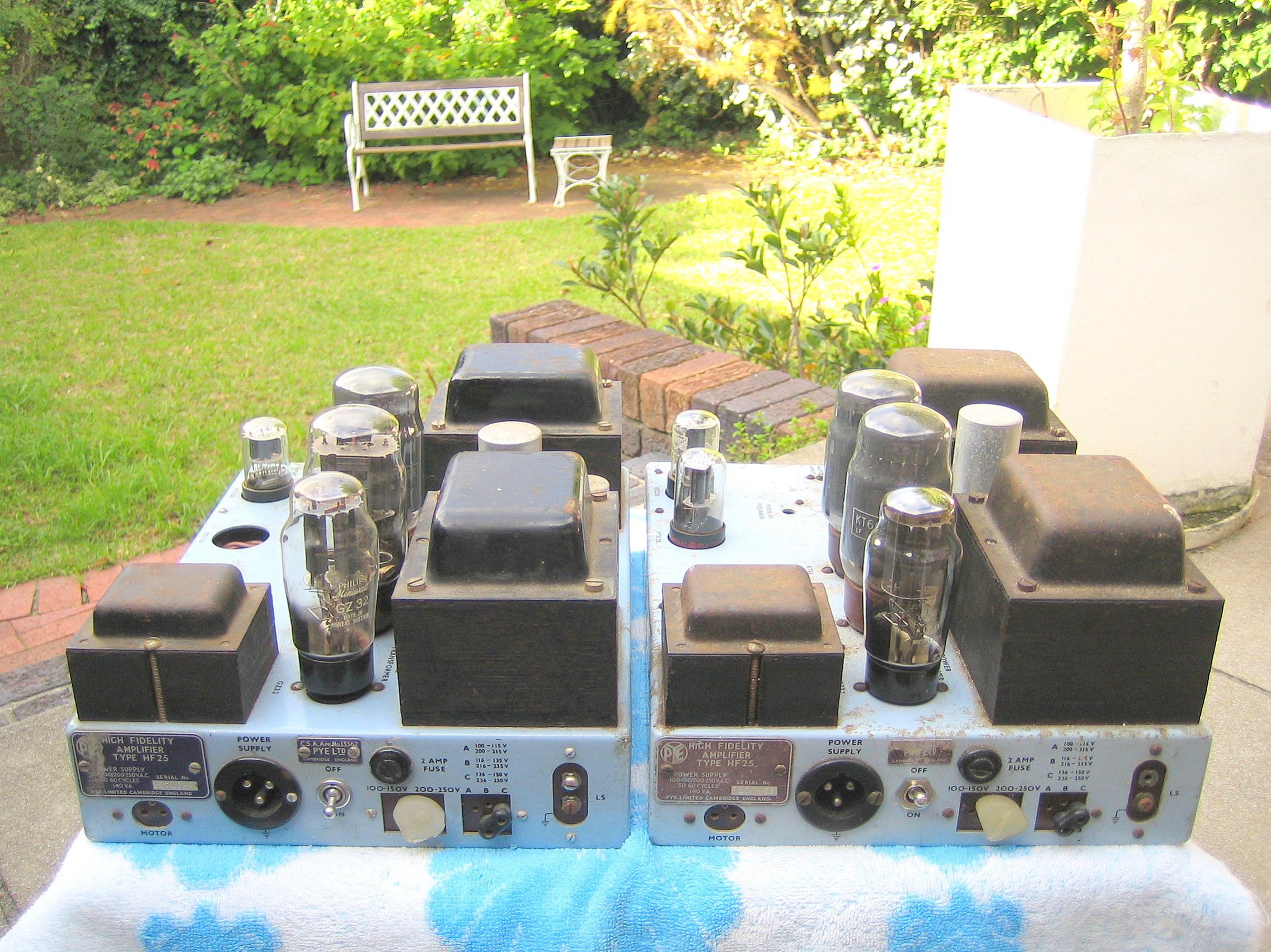

Hi Gents
I have a pair of Pye HF25 tube amps due for refurbishing soon. I have a complete tube compliment for both except for one ECC33. I have searched locally but cannot find one for now. The HF25 manual states a 6SN7 tube as a suitable replacement and this I can get.
So common sense prevails in that in the absence of running one amp with an ECC33 and the other with a 6SN7 will not be an elegant solution. It would therefore be better to get a pair of 6SN7's in the meantime (one for each amp).
What do you think? Buy two 6SN7's or wait until another ECC33 turns up?
Thanks for your opinions!

The ECC33 has no real substitute but a 6SN7 is close enough to be used in this circuit without any modifications and if it recommended by PYE as an acceptable replacement there's no need to search further. Since the 6SN7 has lower Rp, Gm , and µ I would not use different types in the two amps and go for (good quality) 6SN7's in both of them. The problem with the ECC33 (and his relatives, ECC32,ECC35) is demand and scarcity which leads to outrageously high prices, especially the Mullard branded ones. (the designer of this tube). I tried both ECC33's and 6SN7's in my HF 25's and was unable to detect any noticeable difference in sound quality or performance. There are still plenty of good quality (N.O.S) 6SN7's on the market but the prices have a tendency to escalate recently and it's wise to stock a few. Of course, it has been already mentioned above that the ECC83's characteristics are so different that it can not be considered as a possible substitute for the ECC33, even with a socket replacement and circuits changes. (both things I would NEVER do on a Pye HF 25 !)
Thank you, thank you Tubologic. Your post reflects exactly what I wanted to know. I would never change anything on these amplifiers and my plans for refurbishing are far advanced. New rubber feet have been fitted, custom matched light blue paint is here, grey etch primer and black gloss duco for the trafo covers in stock and next week I should have new darkblue aluminium legend plates.

To avoid any more confusion I just wanted to point out that the 1st stage of the HF25 is not a ECC33 but an ECC35 (very close to a 6SL7) and there was never any intention of the O.P to substitute this tube with a 6SN7, nor do I recommended this substitution.(though a 6SL7 can be used in this postition). Also, replacing the ECC33 may change the open loop gain of the amp but will have absolutely no effect on the global NFB factor which is fixed and independant of the active element (the tube), thus there's no need to "restore the original NFB factor".If you want to compensate any (supposed) gain loss of the amp you'll need to decrease global NFB which will actually INCREASE distorsion in the same ratio. All this is purely academic as the circuit is not so critical and the amp works equally well with an ECC33 or 6SN7 in the 2nd stage. I have both a PF91 and HF25 and tried these substitutions many years ago without being able to notice any changes in sound, gain or (audible) performance. I didn't measured the before/after distorsion characteristics,there must be very likely a difference (in better or worse) but so small I would consider it insignificant for all pratical purposes. Again, any circuit could be optimized but I would not recommend changing any parts values in the HF25 without a very careful circuit analysis and comparative lab measurements on the actual unit, which are (I think) beyond the O.P abilities.
Okay folks,
My bad - the schematic I received did not state tube numbers or component values. As the tube change is then only in the ltp phase inverter, the loop gain diminishes to some 80% only of the original. As said earlier my original concern was (glibly) equating ECC33 and 6SN7 without knowing the circuit, while one finds different operating points for the two tubes in the same circuit (from the datasheets of both).
