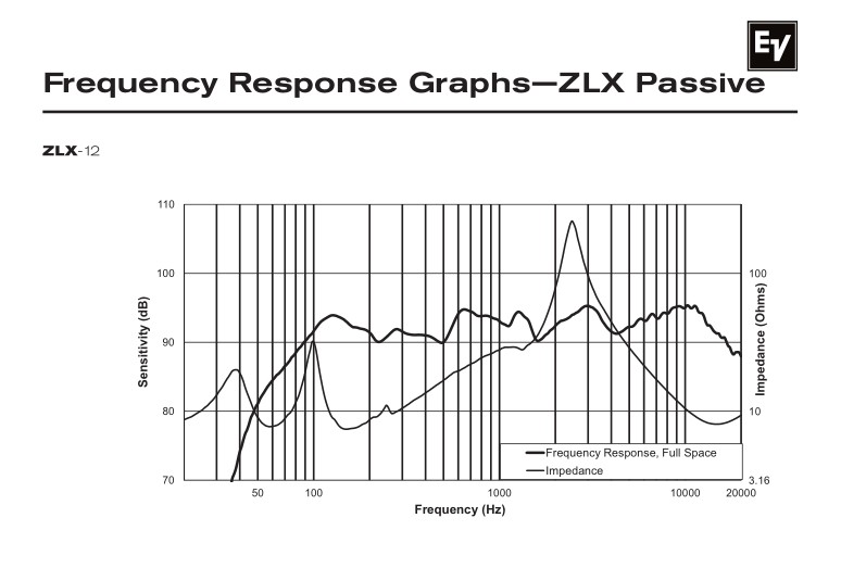

Originally I thought I could get away without a sub, just compensating by external base boost but the DSP limiter and filter in the ZLX12P means this is not possible or doesn't have the desired effect.
Noooo I dont want to use an 18" in fact I was commenting that the box designed to go with the ZLX12P (ELX118) didnt have very good LF extension anyway and all the 18" drivers I looked at were IMOP far to expensive. In any case given my space limitations and moderate SPL requirement (110dB @80hZ) a big XMAX 12" is a far better choice for me and still give >80dB @10hZ (this is shown in the original attached graph).
Ohh I didn't attach the ZLX12P specs originally as I found them somewhat inaccurate and IMOP misleading so instead I attached my own measurements!

The ZLX12p is excellent value for money BUT by no means the loudest boy on the block, the HF horn is amazing and the limiter is nice and soft, just gradually flattens the dynamic range without being to noticeable. As I said the main shortcoming is the LF that starts to rolloff at around 80hZ quite steeply irrespective of the DSP settings, I didn't realize till recently the enclosure is ported so my guess is given its small size the tuning frequency is rather high, you might want to look at its 15 inch brother but from the plots its not a deal better 🙂 all in all you get what you pay for but it is good, just needs a sub 🙂 Ohh output is about 110dB not whatever they claim lols.

yeah the sound quality is excellent especially the HF much better than some chinese companies I have heard (although this is also made in china but to an EV design). Yes its very clear the DSP has several layers of HP, for example to stop the LF driver exceeding its small Xmax after port cutoff, there is very little difference between setting its optional sub HP to 80hZ and the performance with no sub selected!Sound quality decent? Is there HP in the DSP? Curious about the interplay of DSP and a sub and the best way to run it.
